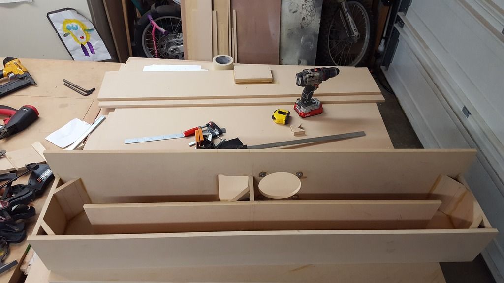

    I'm Building a little SQ system for my truck. I picked up one of the Tang Band w6's just to play with and test out different enclosure designs. I discovered a T-line box will fit under the back seat of my pickup so why not right? (pictures on page 2)
  • #2
    I changed the traditional box design to allow for a centered driver and port for better imeging I used the Sketchup drawing I can print out my cut list.

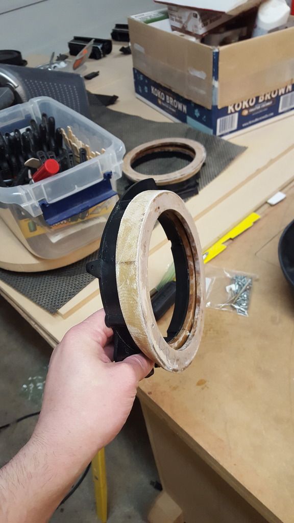

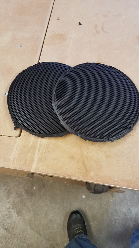

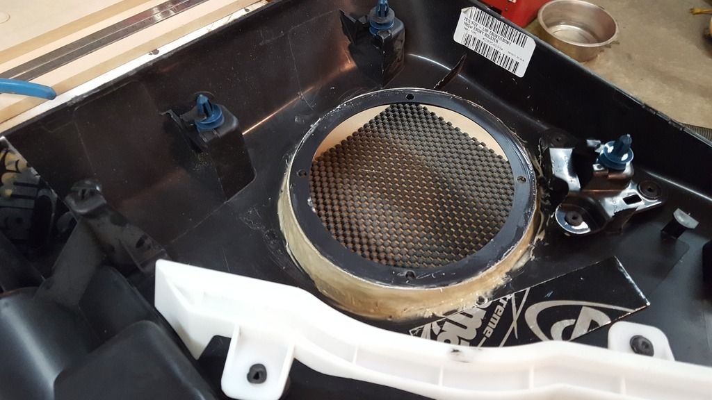

        As I'm building this box I'm working on installing some door speakers and thought the factory grills looked ugly so I cut them out! I then glued the after market grill ring to the inner door panel with PL Premium construction adhesive. I then cut two rings and screwed one to the inner panel and the other to the speaker adapter. With the inner door panel back I glued the two rings together with some stir sticks and CA glue.

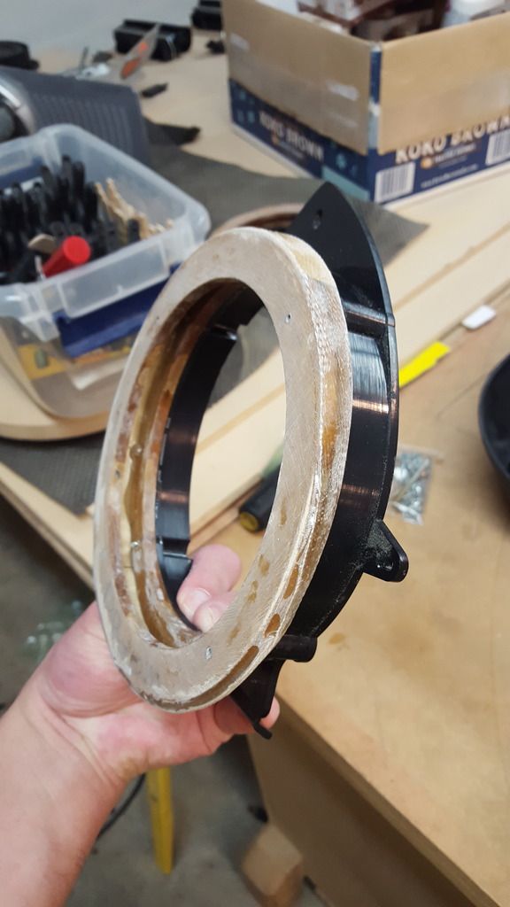

          I removed the glued rings and epoxied thin craft wood to the sides and fiber glassed them for strength and water resistance. As you can see the factory grill location is slightly off from the mounting

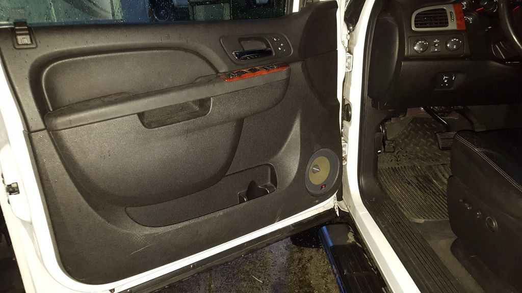

            ​This is what I'm looking for!

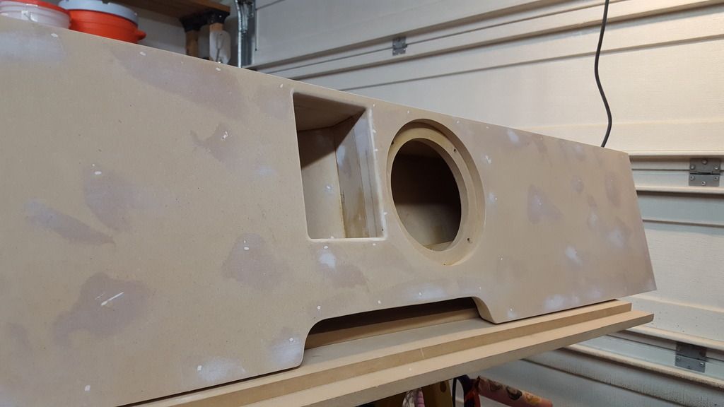

              Got the front baffle cut for the hump and started filling nail holes.

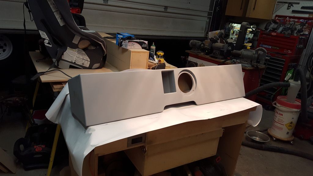

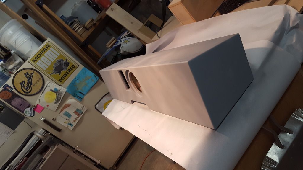

                Sealed with SEM primer.

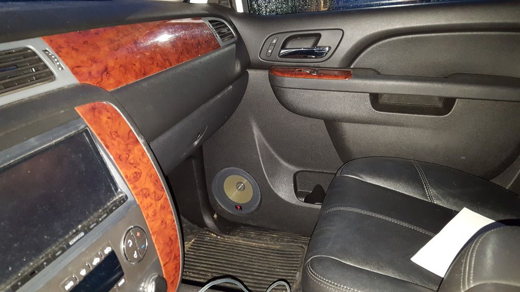

                  Mid drivers installed. I think I need to pray the grills black but they look nice.

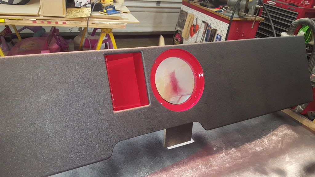

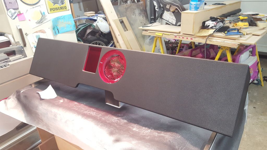

                    Box is now complete. I used DupiColor truck bed coating with great results. I also painted the inside regal red with krustoleum enamel to add some pop of color when show people.
