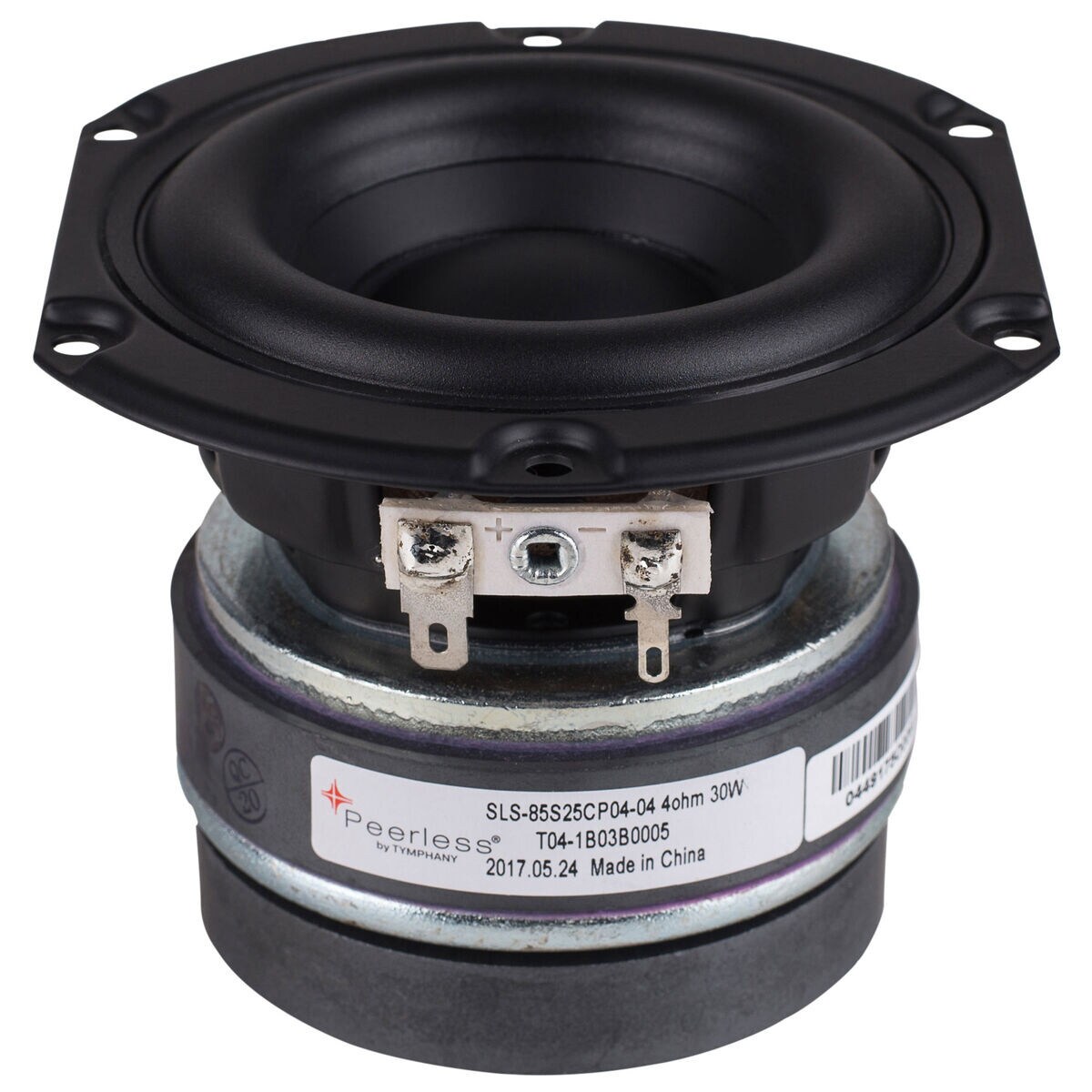

                Interesting, thanks. Could that be a limitation of the enclosure size and pr weighting? I have always failed to model a PR in Winisd and abandoned these projects but always wanted to try. One driver I thought would be good in this size box is the peerless as it talks about half space sensitivity on other websites.
                Peerless SLS-85S25CP04-04 3-1/2" Paper Cone Woofer 4 OhmThe SLS-85S25CP04-04 3-1/2" paper cone woofer from Peerless is an extremely impressive driver for its size. With high excursion capabilities and low resonant frequency, you can expect a considerable amount of low end from compact designs. However, beyond that this driver excels throughout the midrange frequencies thanks to an aluminum shorting ring, optimized magnet, and damped paper cone making this driver ideal for use in ultra-compact 2-way designs and portable speaker systems.
                Anyway food for thought coupled with the matched peerless PR.
                Comment
                • Originally posted by 3rutu5 View Post
                  It is a combination of a lot of things. Placement, room, nearfield or not etc. Nearfield they have a surprising bottom end but in a larger room from a distance may lack a little below 60. For their size 60 is nothing to shake a stick at really.
