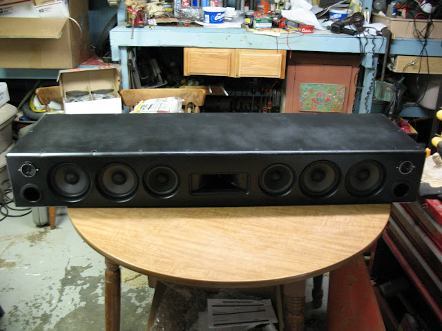

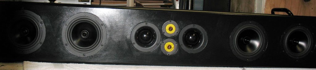

    Here are a few Speakers I designed and built:

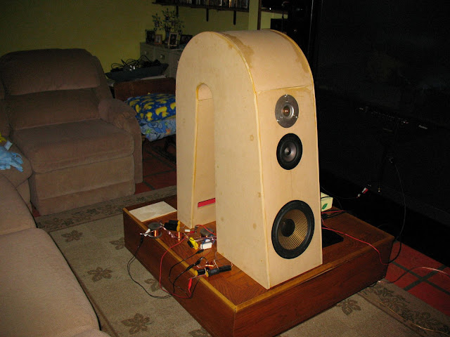

    Zapatòns
    after finishing:

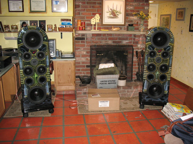

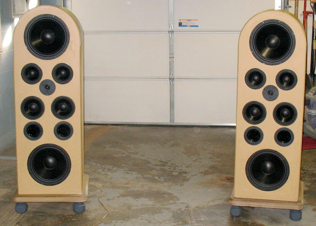

    The Dayton Storms:
    After Finishing:
    On PE's 2010 Catalog cover:

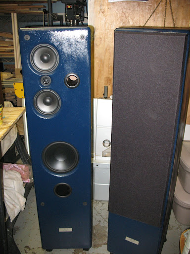

    Leftovers (1st tower build)

          With those painting skills, I don't suppose we'll ever see anything "petite" from you!;) Man, you must be young & strong (or have a shop buddy). Seriously radical projects!

            Thanks Guys. Can't take credit for the paint jobs (Storms & Flames). A local artist James Brown did the finish work, plus the Flames artwork was designed by my Son. However, all cabinet design is all mine.
            Dan, next up I hope to try some veneer work (walnut) on a few new designs, and if I can get James to come out of retirement, another paint job.
            Lou, maybe the "strong" part, and young to those over 70. I do have 2 big strong grandsons who help me out with 4x8 mdf sheets. Also, I had rear wheels & back handle on the "Storms" so I could move them, they was about 220lb per cabinet, right it my lift limit.

                      In the Zapatons, are you using the HiVi RT1L ?
                      If so, can you tell me a bit about their sound? Also, with the low sensitivity and power handling, are they capable of still getting decent output?
                      Thanks.
                      Comment
                      • #12
                        Re: Froste Speakers
                        The RT1Ls sound very good, very detailed, with clean highs, over all nice sound, down side is they will only go down to about 3khz. So far I have only put about 150watts to them and they did fine, the RT1N I used in the FCT3.5/FCTCC is the same tweeter without the large face plate. I think the RT1Ls are not used much because of the large silver faceplate, otherwise they are a very good tweeter, have very nice "air" and sparkle. They mate up well with the MDM55/CAM558/EM1308, they need a mid that can go up to 4khz or above.
