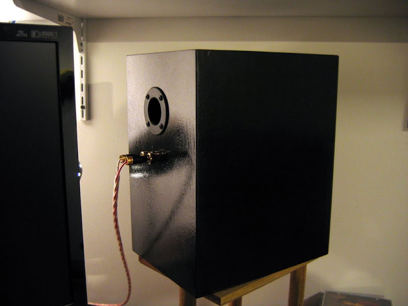

    Tritrix MT's

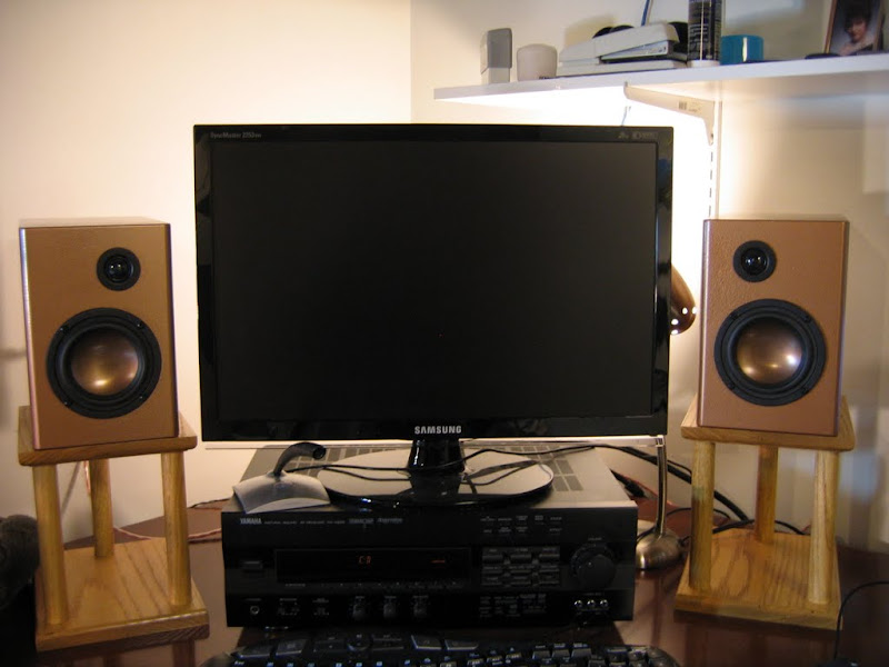

    All this phonic loving I was giving myself did not go unnoticed by my wife, and she spoke up...

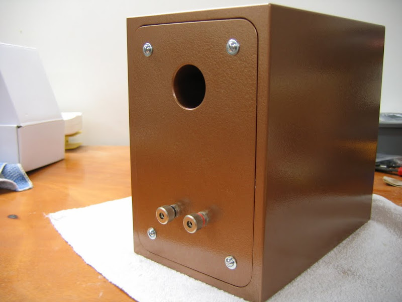

    Overnight Sensations (for wife...)
    When I realized the I enjoyed the OS's more than the Tritrix MT's, well, I can't have myself envying my wife's setup...

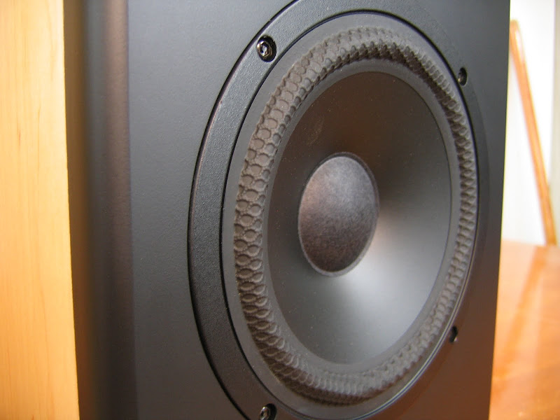

    I just call them
    The Fours
    The Fours is a JKim design utilizing the Tang Band W6-789E and the SB Acoustics SB29RDCN

    I really like the look of "The Fours". Well, not really a fan of the dimple dome tweeter look, but that is forgiven with the beauty of the rest of it. Nice job!

          Re: CK Builds
          Impressive work, your projects all look great!
          May I ask what you used to finish the TriTrix MT's?
          Looks like a hammered finish, but I can't be sure.
          Was it rolled, brushed, or sprayed? What sort of prep steps did you do (primer, sanding)?
          Comment
          • #6
            Re: CK Builds
            thanks!
            Tritrix MTs were birch plywood with rustoleum hammered black spray.
            I now realize I didn't put it on heavy enough. That hammered spray really wants a slow spray method. That "hammered" look comes from concentrated spraying.
            I used basic 2x gray spray primer, no gap fill.
            You can clearly see the grain and pits of the plywood showing through. Not sure if I like it, I am probably going to go back and refinish them soon

                wow, i didn't realize the black hammered paint was that glossy. is it that shiny in person, or are the pictures just making it look that way? as long as we're discussing your finishes, can you answer the same questions about the overnight sensations? i like the way that color goes with the copper colored hivi cone. i'm getting ready to build a set of those myself, and in the back of my mind i've been thinking about what will and won't work, aesthetically, with the b4n.
                  With hammered paint, I think it depends on whether you brush/roll it on or spray it on. I've brushed it on a few cabinets (Aethers, for instance) and it's very glossy, and--it pains me to admit this--runny. On the other hand, I used rattle cans on the China Syndrome, and it came out much more even. Much more classy and "finished" looking.
