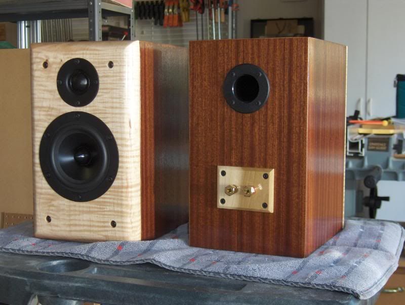

                      Encores in curly maple PSA paperbaked clear gloss poly:

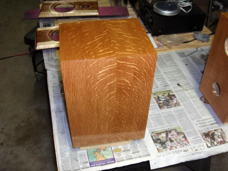

                      LouCs C-Killas in quarter sawn red oak PSA paperbacked clear gloss poly:

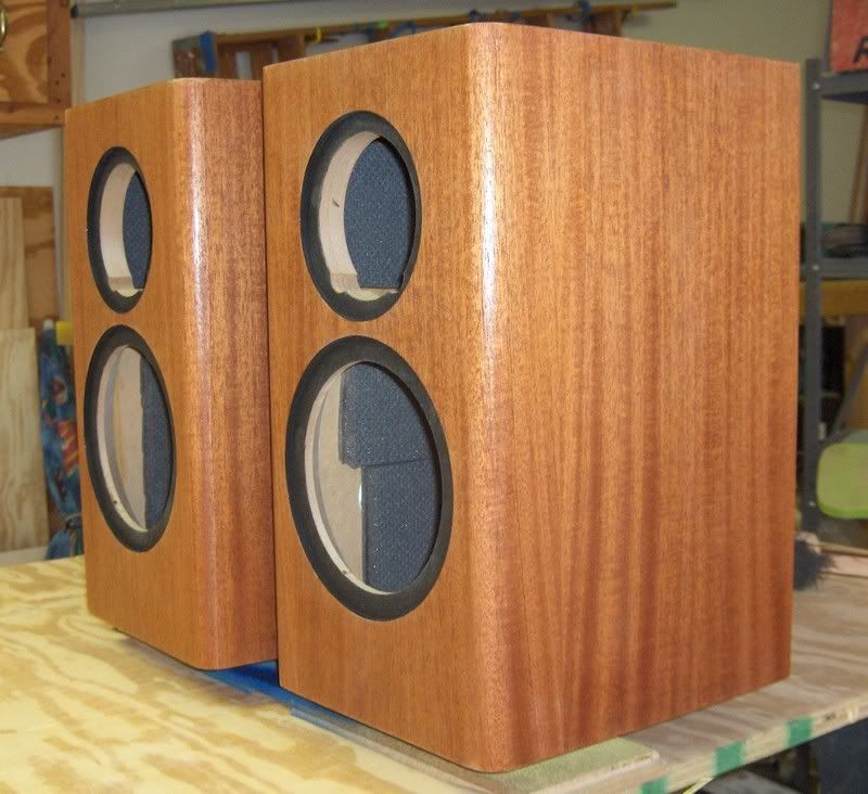

                      LouCs Cryolites in paperbacked ribbon stripped mahogony with satin poly:

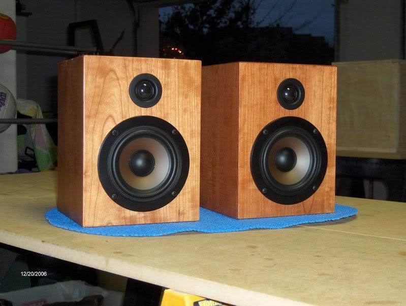

                      LouCs Nuggett2s in flat cut cherry NBL with satin poly:

                      RJBs Cerberus sub in ribbon stripped sapelle with clear gloss poly:
                      RJBs Microbes in ribbon stripped sapelle with clear gloss poly:
                      TB 740C sub in flat cut cherry NBL with satin poly:
                      Another TB 740C sub in flat cut cherry NBL with satin poly:
