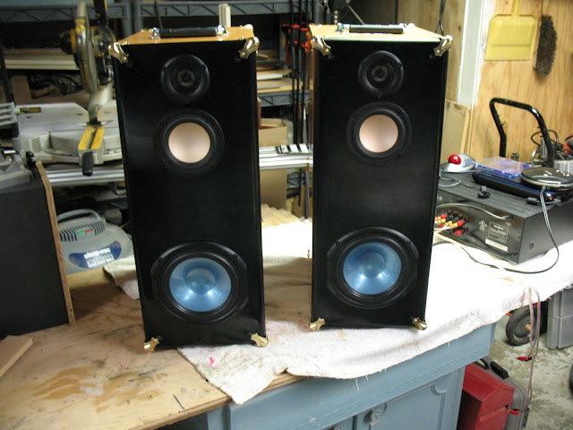

    At the 2010 PE Tent Sale my son picked up some drivers, cabinets and other parts. He then ask me to build a speaker set from these for use on his Boat.
    So, here is what I came up with.
    They are a sealed 3-way in a PE 1ft3 cabinet. The Tweeter is the Beston RT003c, Mid is the HiVi M4n, and the Woofer is a 6.5" 6ohm, blue coned something?? (does measure good).
    The goal was to have something that would sound good "open-air" and alittle water would not hurt it, plus could be carried about.
    So its sealed, redgarded and has closed cones. plus I put guards on the corners and a top handle.
    What I did not expect was for them to sound so good. These ended up sounding way too good to be only used on a boat at the lake.
    I will post XO and measurements later.
    Let me know what you think.

      The blue on is a Dahlquist/Bravox woofer. The 5.5" blue version and the 6.5" black version both measured pretty decently, so it is no suprise the 6.5" blue one measured well.

        Thanks Guys. Well Blue&Gold is My son's (and Mine) Highschool colors.

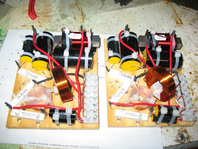

        Here is the XO and modeled freq.
        Ed
