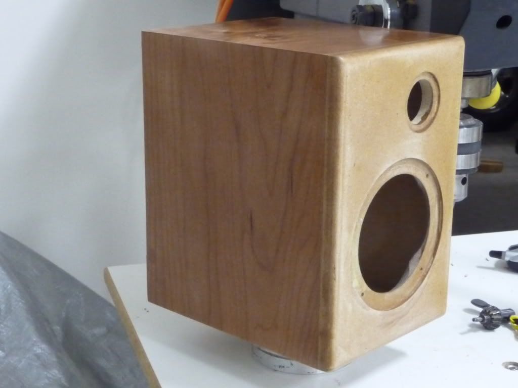

    Continuing with the veneering process -- Disaster strikes!!
    I think I mentioned earlier in this string that I'm new to wood veneering. This was my first wood veneer project, and I did encounter some difficulties. The primary difficulty for me was in trimming the veneer, once it was applied to the enclosure. It may have been my choice of veneer, but I found the material extremely fragile -- given half a chance it would split. I was concerned about that issue when I purchased the materials from a local Rockler store, so I went the tool you see in the photo below. It isn't going to be a tool I use often. I found the tool to be unreliable, or maybe untrustworthy would be a better word. Despite great care, the veneer would unpredictably split in places, or even worse, tear a piece out if I was attempting a cross-cut (across the grain).
    The tool features a special blade (looks a lot like a rectangular utility knife blade) and guides that are supposed to produce a flush cut. Maybe with a bit of practice it would be possible to get consistently good and accurate cuts, but I ended up abandoning the tool in favor of a sanding block. To make the tool work reliably, you'd have to inspect it closely before each cut to make sure there weren't any splinters of wood between the blade and the holder. If there were splinters, the blade wouldn't make a decent cut. Changing the blade frequently is also necessary. I found a simple sanding block with 150 grit paper to be the most accurate and least troublesome way to trim the veneer. That of course means that you'll want to cut the individual pieces pretty close to the final trimmed size so that you don't end up with a lot of overlap to remove. For those unfamiliar with the basics of veneering, you must trim each piece after it is applied, before moving on to the next piece.

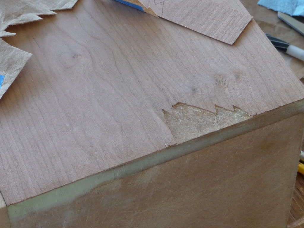

    Regarding the difficulties I encountered, here's an example:
    That tear-out you see there has been cleaned up with an Exacto knife -- it looked much, much, worse before I trimmed it up. But, it did give me an opportunity to explore ways of correcting (maybe patching would be a better word) the damage. I damaged the veneer by using too much force with the trimmer described above -- I was pushing it pretty hard, but not nearly as hard as as the force used with something like a hand plane. Once the damage was done, I was left with a couple of choices -- attempt to remove the veneer, or repair the damage. I opted for the repair route because a new piece of veneer wouldn't match, and because removing the veneer was likely to result in new imperfections, perhaps even making matters worse.
    I sorted through the scrap pieces of veneer and found a piece that matched the damaged area fairly well. I then made a paper template to arrive at the general shape of the torn-out area, simplified of course to eliminate the shards and fibers of wood that remained. I chose to use an irregular shape, as opposed to some easily recognizable shape such as a square, circle, or oval, because it would be much more difficult to spot, once in place. The template was used to produce a slightly enlarged piece of veneer that would become the "plug" or patch-piece. The plug was then placed over the damaged area and the outline carefully traced onto the torn-out area as precisely as I could. I then enlarged the damaged area with an Exacto knife cutting out the veneer within the area defined by the traced line. I removed as much of the adhesive from the surface as possible, then glued the plug in place.
    Looking over the photos again, I can see that I smoothed the shape of the plug and cutout somewhat. You can see that I achieved a fairly close fit -- not perfect but things were looking up.
    I used a wood filler that's made specifically to closely match the color of Cherry wood to conceal the part line. The repair was next sanded to make sure it didn't protrude above the surrounding area.
    The patch is actually difficult to find and unlikely to be noticed without close inspection.

      That repair is brilliant. No other word for it. I saw it in Tucson, and if you hadn't pointed it out to me, I never would have noticed it. The jagged line matching technique is just a flat out GREAT idea, it's damn near invisible after finishing.
      Kudos!

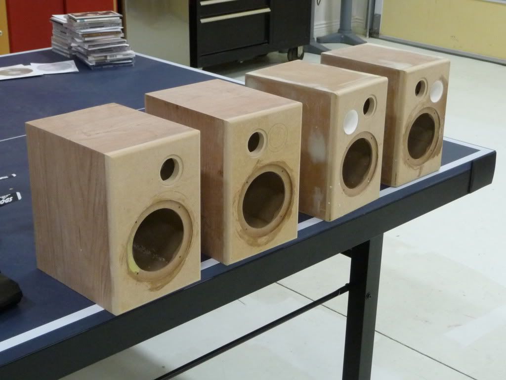

                              Continuing with the build process -- after completing the veneering of one set, I flush trimmed the baffles with a router and a flush-trim bit. A flush trim bit does a great job of matching up the baffle with the box and I ended up with the baffle perfectly matching the surface height of the veneer. As I mentioned in a reply to Randall above, I did experience a little superficial marring of the veneer surface -- I say superficial because it was easily removed with light sanding, but it did cause me think I'd be wise to guard against that in the future. Leroy and Swander suggested using tape and that does seem likely to either prevent a problem, or at least raise my comfort level. I also rounded over the edges (top, bottom and sides) with a 1/2" round over bit and router, and flared the ports on both sets with the same bit. The vents were originally epoxied in place flush with the outer face of the baffle on one set, and the back on the other set. That meant that routing around the port opening would involve cutting the PVC which left about 1/4" of contact area between the PVC and the MDF where they are mounted. The PVC cuts easily, providing you don't rush and move the router in the correct direction.

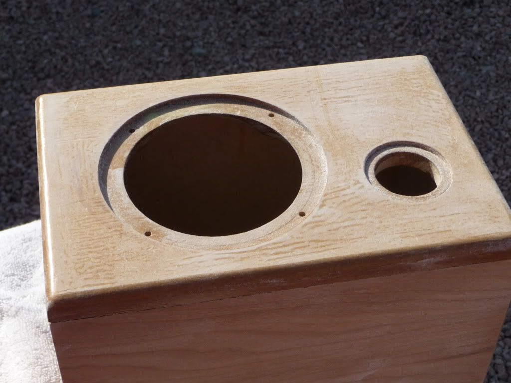

                              I then sealed the baffles with diluted mixture of fiberglass resin (30% acetone). As I stated earlier, I like the resin process and will use it again. In the interests of complete disclosure , I should point out again that the resin doesn't flow out as well as paint which leaves brush marks that must be sanded out. See the next photo where I've knocked down the high areas to reveal the brush strokes. It does sand out easily though, providing it has been allowed to cure adequately.
                              A thinner mixture would most likely reduce the brush stroke effect. Once again, be sure to work in a well ventilated area, and wear a respirator. They're readily available at home improvement centers, paint stores, you can even get a Binford from HF -- it's actually a reputable brand.
                              In the next photo the resin coating has been sanded smooth. I've also applied a coat or two of urethane varnish to strengthen the veneer (the baffle was masked). Until it was coated, it had a tendency to snag on everything, and was easily damaged even with careful handling.

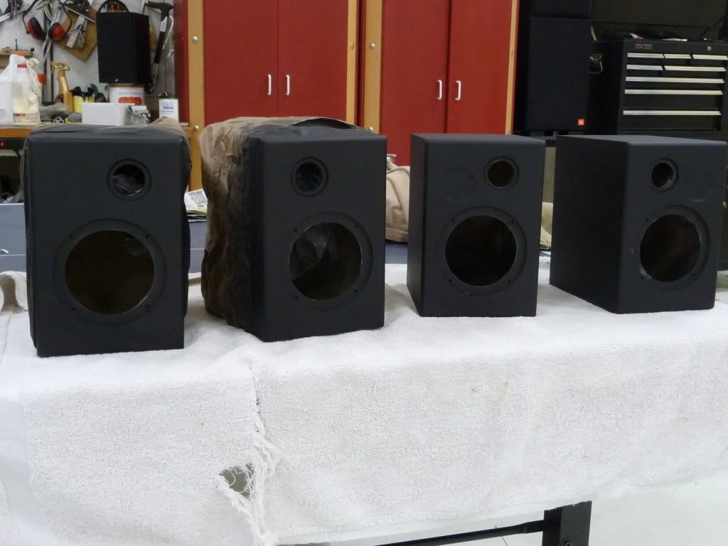

                              I sprayed on two coats of lacquer-based high-build black automotive primer. The front ported enclosures were painted on all sides -- of course the veneered pair was masked so that only the front baffle was painted (you never know--someone might wonder about that).
                              Since I'm on the topic of spraying -- I've discovered that the high-build primers require a pretty decent gun to apply. The stuff is full of solids, and it's thick (naturally). It takes a bit more work to clean your gun, and since this was a small project, I opted for a small detail gun rather than break out a gravity feed. Next time I'll leave the detail gun on the shelf -- it simply isn't up to the task. I could have thinned the primer, but then you end up with something less than high-build.

                                Great build info. One comment on the high build primer... rather than deal with dedicating a gun specifically for it (since a thicker nozzle really should be used), I just buy my high build primer in spray cans. Duplicolor stuff is available everywhere, and works great. SEM also sells their version, though I have yet to use it... I've been happy with the Duplicolor stuff. When you seal the MDF, it doesn't take a lot of high build primer to get a smooth paintable surface. I've even built enclosures without using a sealer... just using extra coats of the high build primer to seal the wood. That's how the tall cabinet in the attached pic was done, prior to the automotive Urethane finish. After a wetsand & buff, the black paint was mirror smooth, just like you'd expect from a high quality automotive urethane finish. That said, a coat or two of sanding sealer or equivalent will result in a much faster & easier primer application.
