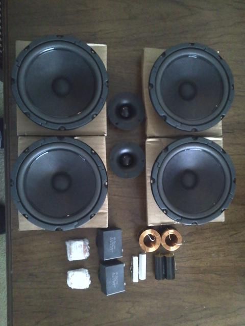

    Well looky, looky, looky at what just came in the mail today! Thanks to Bryan, I am going to be able to attempt a DCR Maurbacs tower after all!!! :D
    Progress will be a little slow, but it should be well worth it!
