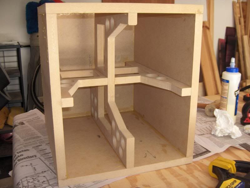

            Now that is some bracing I can relate to!! Awesome job!!!
            Bet that sucker is nice and dead. It is always worth it being overdone. Leaves nothing to wonder.

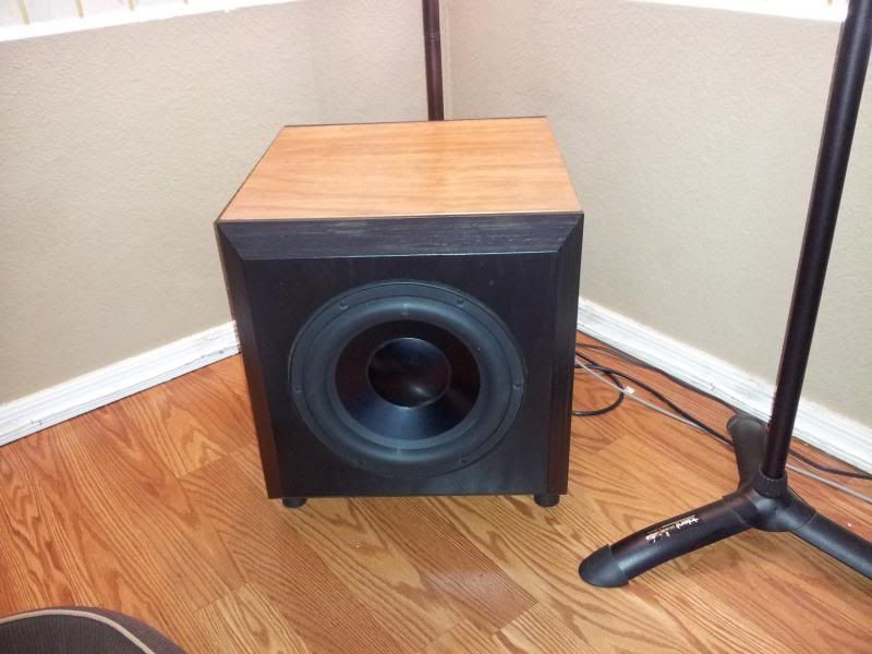

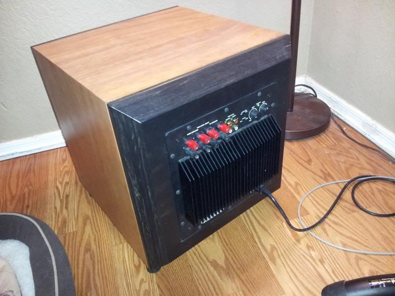

                      Originally posted by andykriech View Post
                      Well, since he never added any finished pics, and it is yours now, you can do it!
                      How about pictures with the finish and feet/bottom?
                      Andy.
                      Here ya go...

                        It looks WAAAY better than that in real life, the flash picked up grain that you just don't see looking at it in room. That groove that Gaelen mentioned is pretty damn groovy.;)

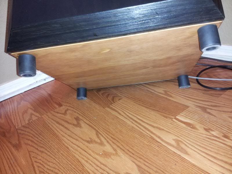

                          Yeah, sorry bout the lack of finished pics on my part :o Glad to see Mark is still enjoying himself :D As you can all see, I eventually decided to go with tall rubber feet, simple and effective. As much as I love this sub, I don't really need it, the Tarkus just handles it's own business when it comes to bass, so I have something bigger planned for later on down the road, but that's another thread for another time.
