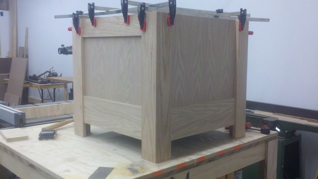

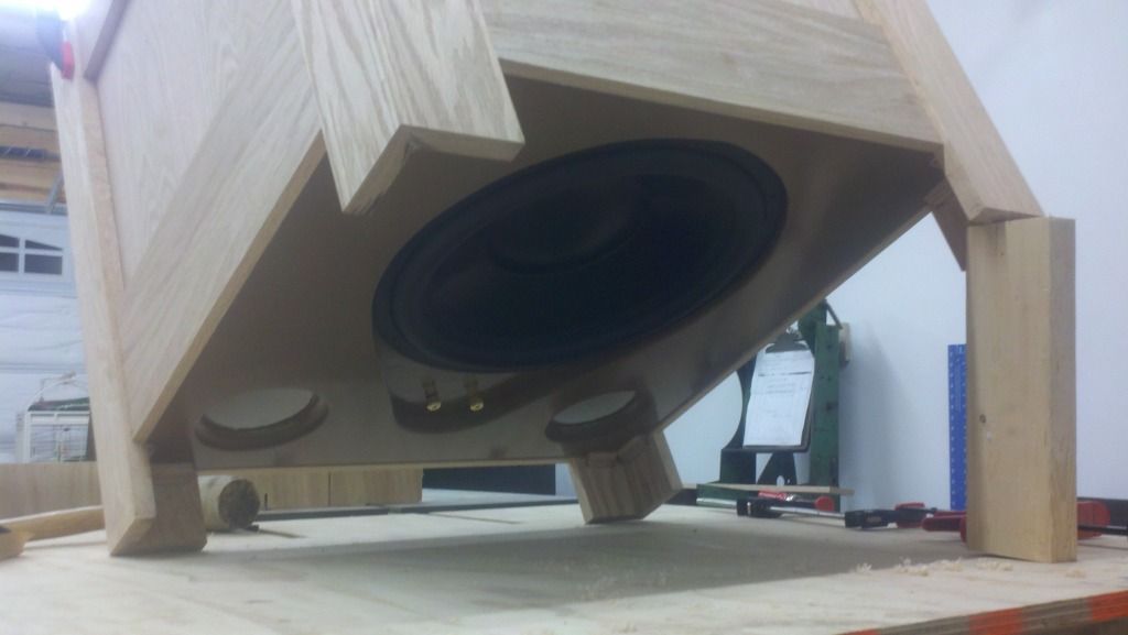

    Currently I am using an older model 200 watt amp to power this so I’ll not be completely satisfied until a more power appropriate amp is purchased. The project was only approved if I could make it appear as an end table in our living/HT/Kids play room in accordance with the wife. It will be down firing and be finished in red oak since it’s locally available to me. I didn’t take as many pictures as I should have and am missing one of the final bracing. I will do more of the finishing and listen impressions once I get a larger amp (recommendations welcome). This is my first attempt at a HT sub.
    Outside box dimensions are 20.75x24x24
    After driver and bracing and port volume subtracted I have about 4.40 cu.
    Ports are 4”x31” with what I’d call semi flared ends.
    Double 1.5” front baffle with posted mounted just above the driver.
    Driver on the work bench.
    Current weak amp being used to test.
    One brace and ports installed. A rounded edge circle of MDF was used to create a "flare" at the end of the tube. And alot more bracing was installed. This is were I had my picture failure.
    I could not wait to test the driver. Here it is in some sloppy bondo.:whistling:
    Veneer...
    This is were I'm at now. I'll be trying to finish it up this weekend and post more pics.

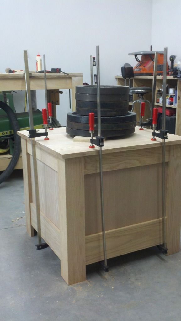

      I clamped and built the top yesterday (10/12) and late last night got to glued on the table. You cannot see it but there is a 1/4 rubber square that was a scrap from a new conveyor belt at the dock yard my brother worked at. I don't know how much good its going to do but hey....I tired. It is not visible from the outside of the table.

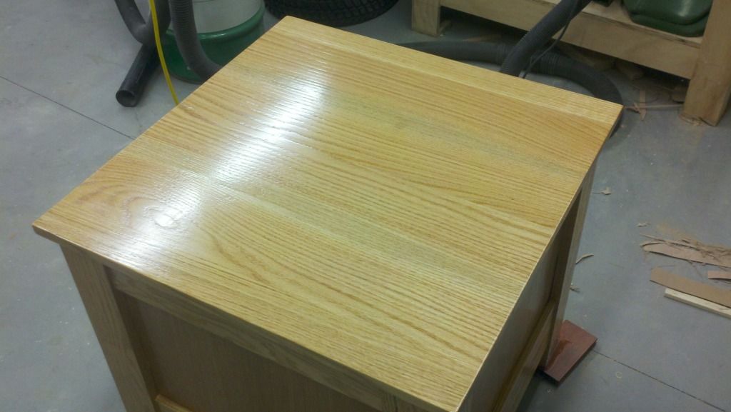

        I got the first coat of poly on last night (10/15) and went out to sand and do the second coat tonight but its still tacky. So I'll give it another 24 hours. My main worry right now is getting it from the wood shop to the house, Im pushing 150lbs with this thing and Im not as young as I used to be. :flex:

          I finished with the final coat of poly last night and it should be ready to be moved into its new home tomorrow morning. I need to wet sand tonight and wax.
