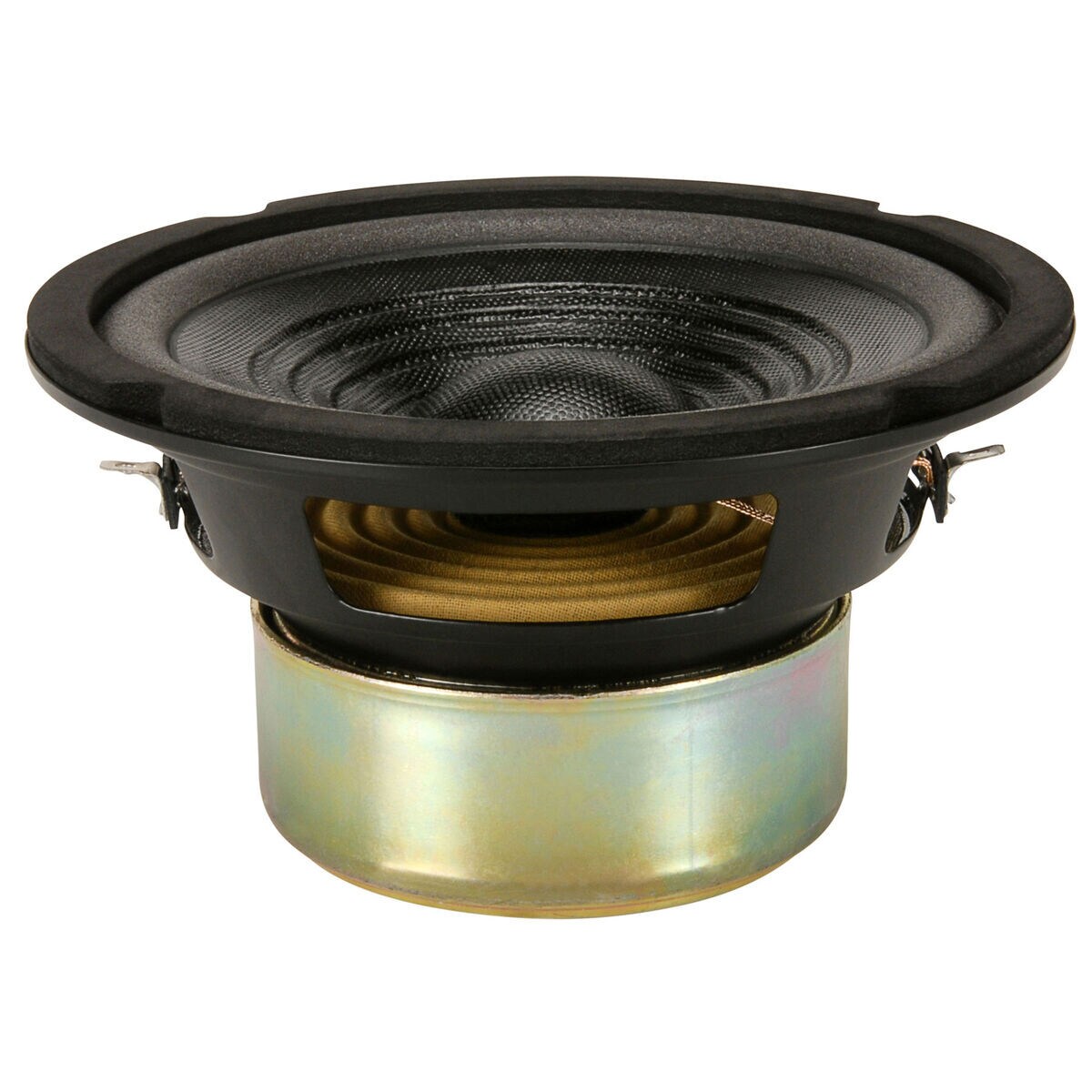

          Yah only three taps for now. I home brew...I need to get another tap though...maybe fathers day! Its a 4 keg setup! How would I keep a stereo setup with my box? I could run the 6.5 on one channel and the two 3'' on the other??? any way its done!!! I'm real happy with how it came out. and sounds great! it look like I need to get a new battery... it was at full charge till I unplugged it now its only at 10.6v...
          What if you swap this for your woofer.
          Then you could run both channels to it, right?
          Goldwood GW-406D 6-1/2" Poly DVC Subwoofer ShieldedThis woofer provides added versatility over single voice coil woofers by allowing the use of both channels of a stereo amplifier to driver one speaker, and the ability to wire the voice coils in varying configurations. They feature polymer laminated paper cones, treated foam surrounds, and vented pole pieces with back plates. This driver features a fully shielded motor. Note: This woofer has dual 8 ohm voice coils. All parameters below are with the voice coils connected in parallel for a 4 ohm load.

            In theory, yes, that would work. However, that Goldwood driver won't sound better than the repurposed Focal driver. I'd get a second amp before chucking the Focal. That's a nice driver.

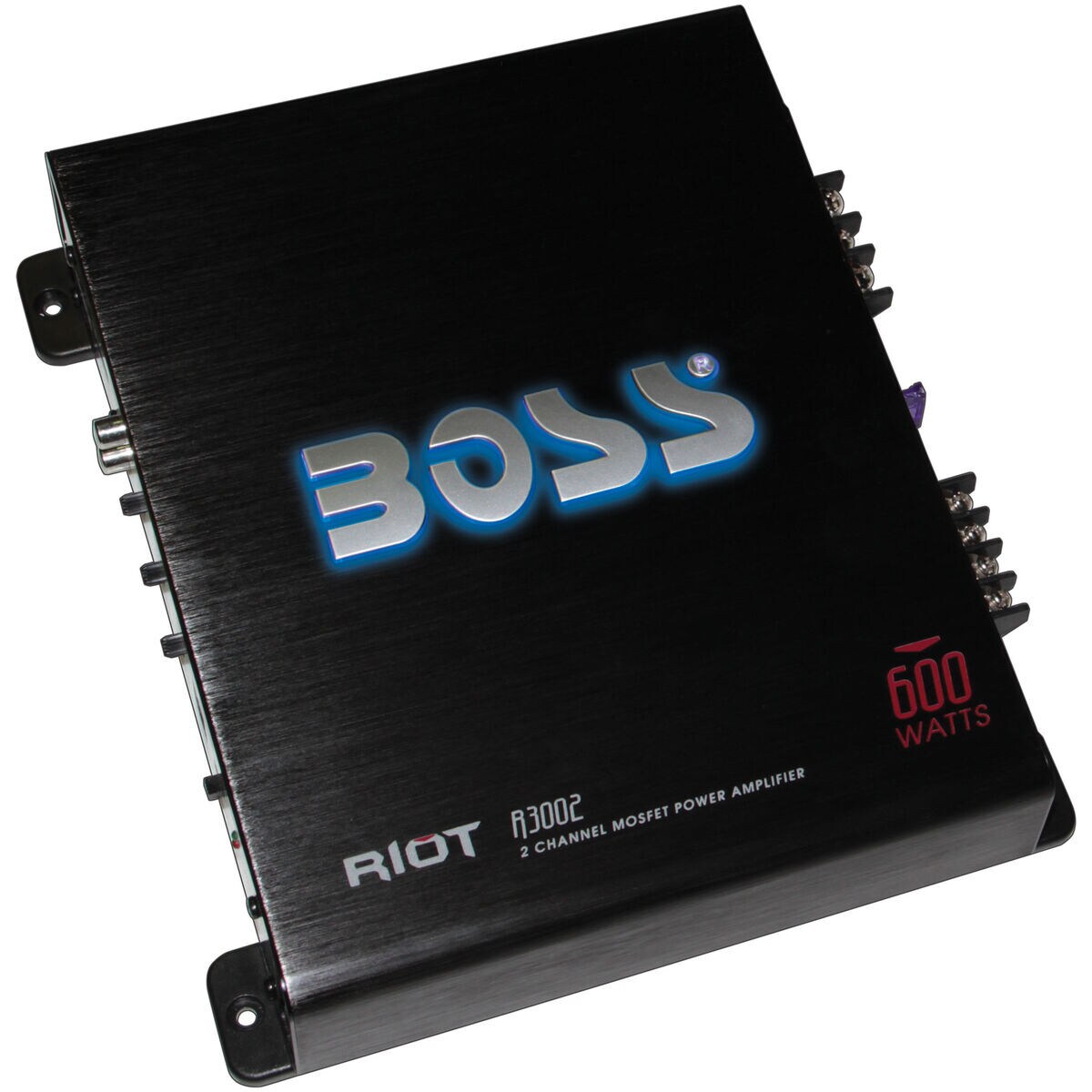

                I ordered a low volt cut off module. What amp would you all recommend for this focal... crossover???

                  If you like the sound of the unit as is, I'd leave it alone. Adding a second amp is going to add cost, time and a pretty big re-working of all the wiring you already did. You'd basically need to add an amp that can take the high level (speaker) output from the Lepai, sum the stereo signal and then output a 1-channel amplified signal for the Focal. In other words, you'd need bridgeable 12v amp....like a car amp. Somthing like this perhaps.
                  BOSS R3002 RIOT 600 Watt 2 Channel MOSFET Car Audio AmplifierIf you're still using your head unit for amplification, you have no idea what you're missing! Head units are often unable to provide the loud, dynamic sound you want, and can distort (or even damage) your speakers at even medium volume levels.That's where the BOSS RIOT Series of amplifiers comes in. Tried-and-true Class AB amplifier topology, 2-ohm stable (for powering a pair of 4-ohm speakers off a single channel), and way more than enough power for even the hungriest door, dash, or deck speaker. The R3002 can also be set up for 2.1 (tri-mode) use to power a pair of stereo speakers and a mono subwoofer (passive crossover values are listed in the manual). BOSS built the RIOT Series amplifiers with advanced features that are usually associated with amplifiers at more than twice the price: thermal and short circuit protection, soft turn-on circuit, remote turn-on/off, nickel-plated low-level and high-level inputs, LED power and protection indicators, all housed in a stealth black anodized aluminum chassis.The R2002 also includes a MOSFET PWM power supply (for 4-ohm bridged-mono operation), a variable 35 to 160 Hz low-pass crossover, selectable fixed 80 Hz high-pass crossover, a variable 0 to 18 dB bass boost, and a remote subwoofer level control for dialing in the perfect amount of bass from the driver's seat. Mounting hardware included.Specifications: • Power output: 2 x 125W RMS (@ 4 ohms), 2 x 300W max (@ 2 ohms), 1 x 600W max (4 ohms bridged-mono) • Frequency response: 9 to 50,000 Hz • Signal-to-ratio: >102 dB • Total harmonic distortion: 0.01% @ RMS power output • Damping factor: >125 • Dimensions (L x H x W): 10.43" x 2.25" x 9.21".
                  Your run time would drop considerably too, especially with a class A/B amp in the equation. Class-D is the way to go when dealing with batteries, but that adds A LOT more cost to the project.
                  There's probably a better workaround that may involve a DIY summing circuit. I'd be interested to see if anyone else could come up with a way to keep the Lepai and add a cheap amp module.
