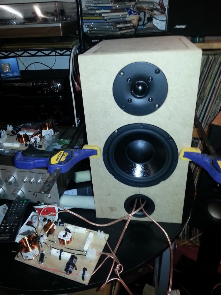

    Initial layout of crossover. I have it on a 5x7 piece of plywood.
    Then I tied them together
    Then I soldered

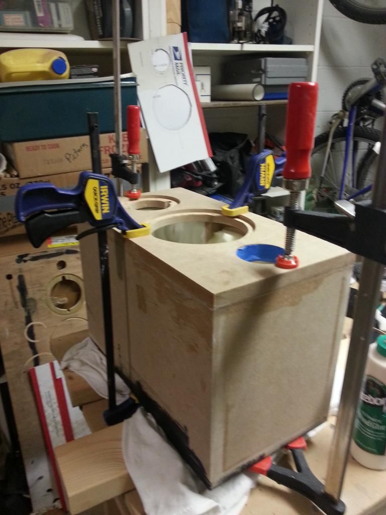

    Here is the cabs I cut and put together, I save more than a few dollars cutting them myself.

    Crossover test..

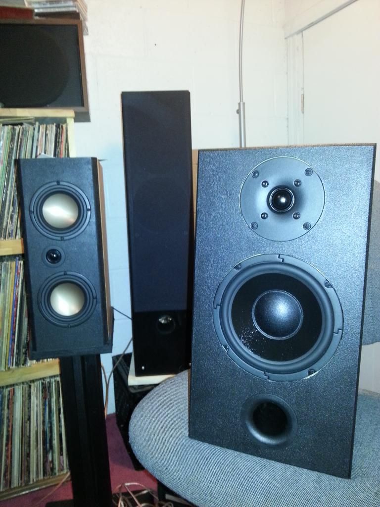

    Baffle time..
    Gotta love duratex stuff.

      Nice work. Im interested to hear your opinion on these vs the overnight sensations since you can do an a/b comparo! They are in the same price bracket and i wonder if the bass capability of the bigger dayton bests the two 4" drivers.
          So far, the OS MTM's are going lower than the Classix.

              I don't own the os mtm's but its hard to imagine that the os can reach the mid 30hz range of the classix.

                    I've never heard a "Classic" 6.5"er have an F3 of 35Hz in ANY kind of box (F6 in the upper 30s MAYBE, but not F3 in the mid 30s). Typically they'll do near 40 in a vented box. I THINK the OS do about 50. Using a pair of woofers (MTM) doesn't lower the extension, it just gains sensitivity and power handling.
