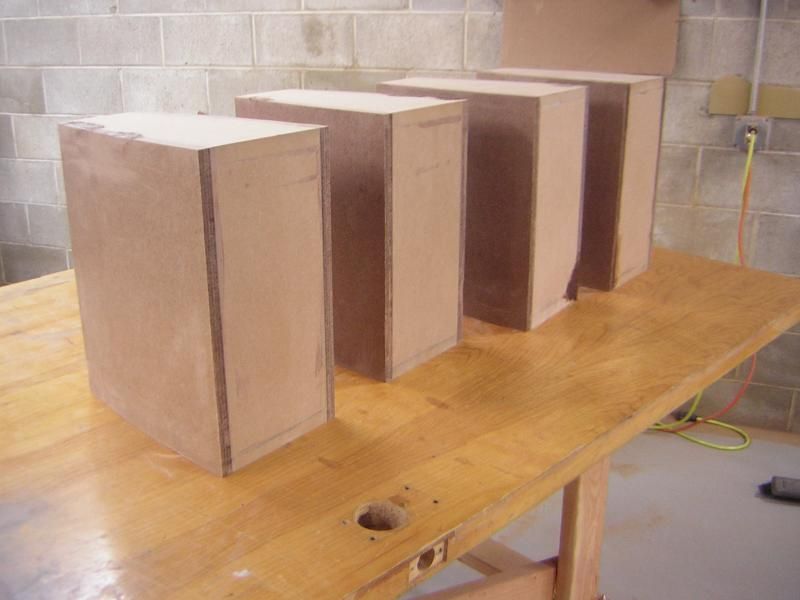

    Boxes enclosed:

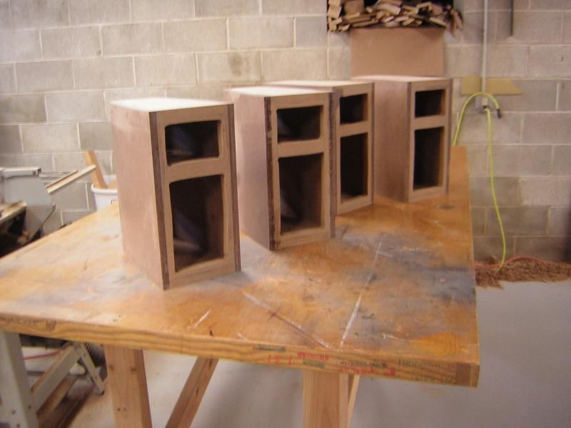

    Cut-outs for the baffle:

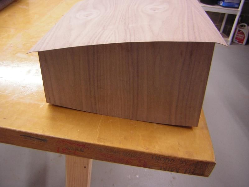

    Veneer going on:
    I used walnut for these as I had just enough to finish these from scraps from previous projects. 6-7 coats of rub-on poly, gloss this time.
    Tried something new this time. I attempted to continue the grain pattern from the side-top-side in series. I ended up leaving too much extra on each piece of veneer for it to work 100%, plus the rear curve threw a monkey wrench in that as well, but overall it ties the grain in much better as a whole. It's a nice thing to try if it works out I guess.
    I ended up using the woodworkers warehouse contact cement for the top and bottom and back, but I reverted to my good old heatlock iron on stuff for the sides. The contact cement worked fine, but it's runny, and it's hard to not drip it on adjoining panels, even being careful. It also is very "rubbery" everywhere it gets on things. I'll use it if I have to, but I still prefer iron-on. There were some spots of bondo on the sides, so I was a bit nervous about using the iron on those areas... I scuffed them well and went ahead with it... it adhered just fine, I just made sure I kept the iron moving.

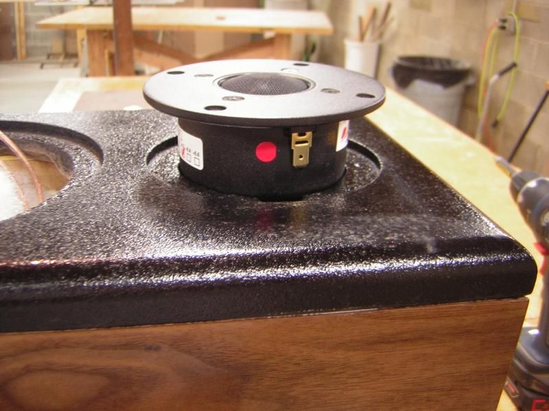

    I did screw something up... I always manage to do so: :D
    I made two set of these, one had the shielded tweets, the other did not. When I measured the tweeter backs, I measured the non-shielded ones, and never even considered that the shielded one may be bigger... it was. No big deal, a few minutes with a drum sander in the drill took care of it, but I hate when that happens.
