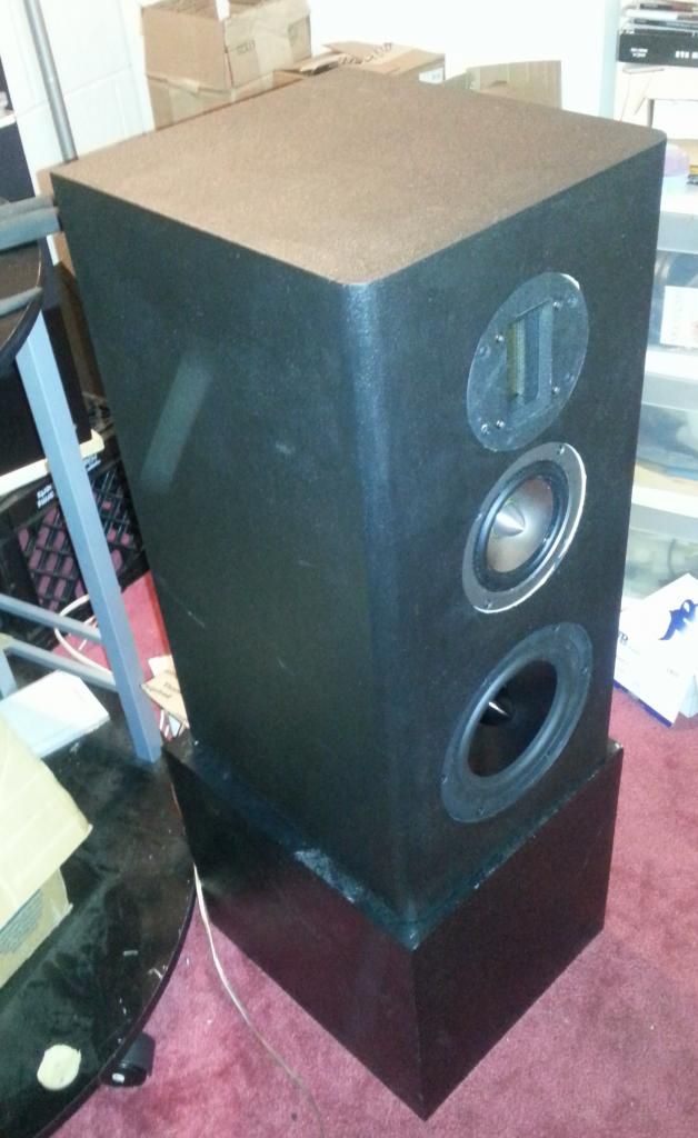

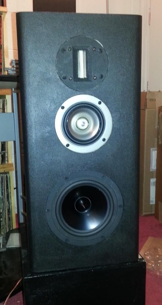

    In my quest for a 3-way speaker, I chose the Statement Monitors.
    I am breaking the drivers in as I type.
    I am also going a few more build pics in as I find the time in the next few days.

        Nice choice in a build.
        May I suggest some gasket tape to bring the mid back to flush on the baffle....
        Such nice parts in your build, just making suggestions to bring it all together.

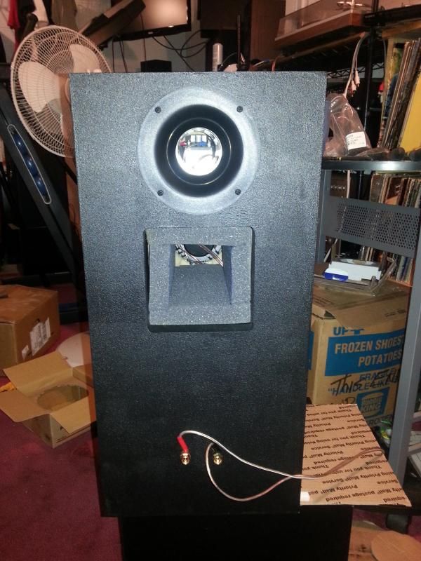

            It is all done with Duratex. I was to veneer, but the more I thought about it, the more I didn't trust my wood working prowess.
            To anyone wanting to do this build, you have to cut a tweeter relief into the mid tunnel. I didn't really see this documented anywhere.
            Done

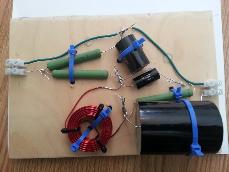

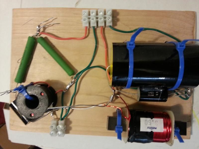

              Crossover pics
              Mid crossover
              Woofer and tweeter
