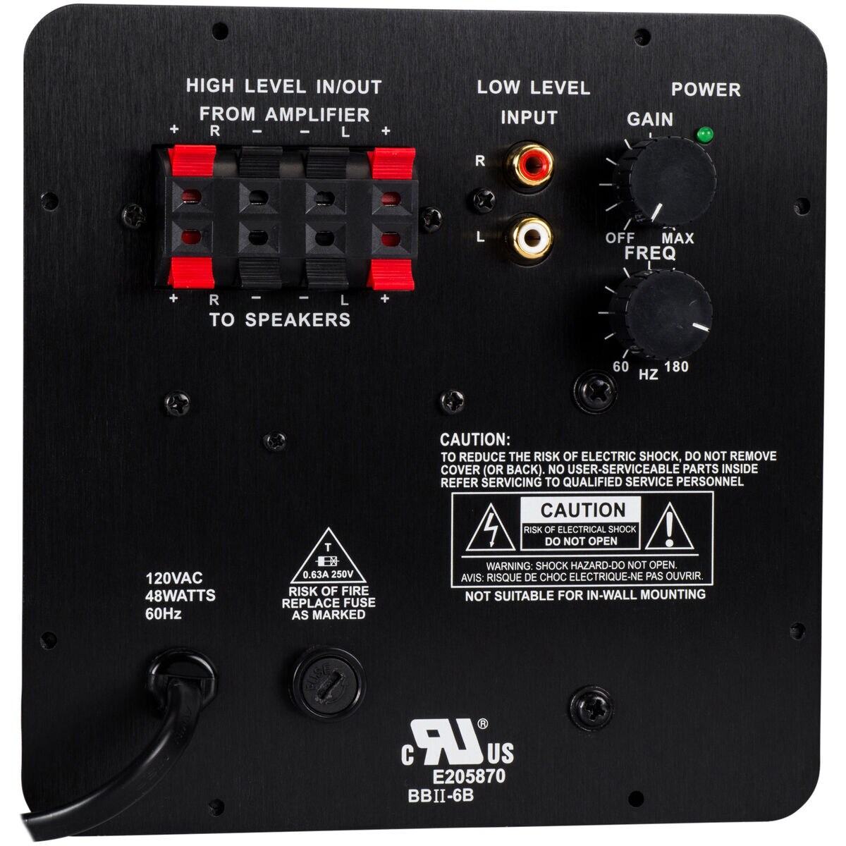

                    Yep-
                    Your Audio Solutions HQ Since 1986. Shop 18,000+ Audio Parts from Speakers and Subwoofers to Home Theater and Pro Audio. Top Gear at Low Prices and FREE Shipping
                    Dayton Audio SA25 25W Subwoofer Plate AmplifierThis ultra-compact 25-watt subwoofer amplifier offers the perfect amount of power for any small subwoofer system. It delivers a real 25 watts RMS of power, which is not an exaggerated figure like found in most typical multimedia systems. With a solid 25 watts, it has enough oomph to reach 100 dB with many drivers. Measuring only 6-1/4" square, the 25-watt amp will fit in even the smallest enclosures.Specifications: • Measured power output: 15 watts RMS into 8 ohms @ 0.1% THD, 25 watts RMS into 4 ohms @ 0.2% THD • Signal to noise ratio: 90 dB (A-weighted) • Power requirement: 120 VAC • Dimensions: 6-5/16" W x 6-5/16" H x 2-9/16" D • Enclosure cutout: 5-1/4" W x 5-1/4" H.With a Dayton Audio 5 year warranty, it’s more than a guarantee, it’s a promise. We stand behind our products and our warranty is a demonstration of our commitment to quality and reliability.
                    Apparently the KG3100 2.1 amp is now NLA from Mad, which was the other option as far as power, IMO. The 70W/100W will fit, but are really too much power full bore, and the housing would have to be removed.
                    Later,
                    Wolf
