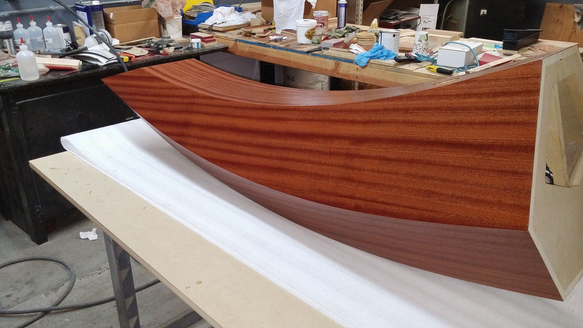

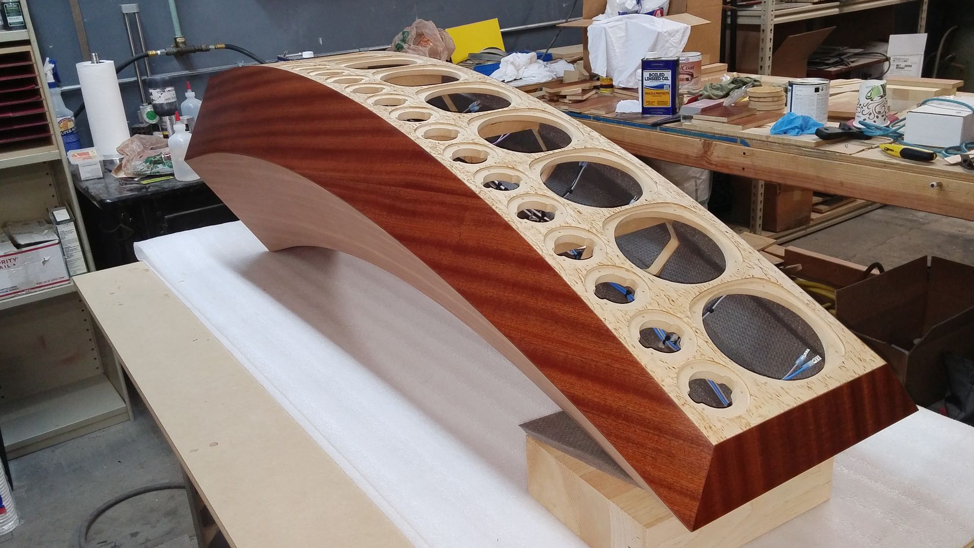

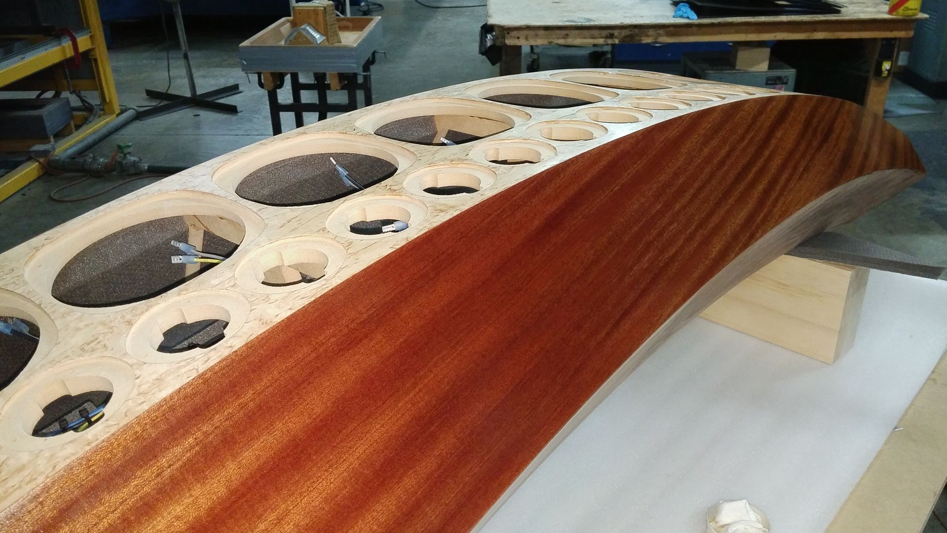

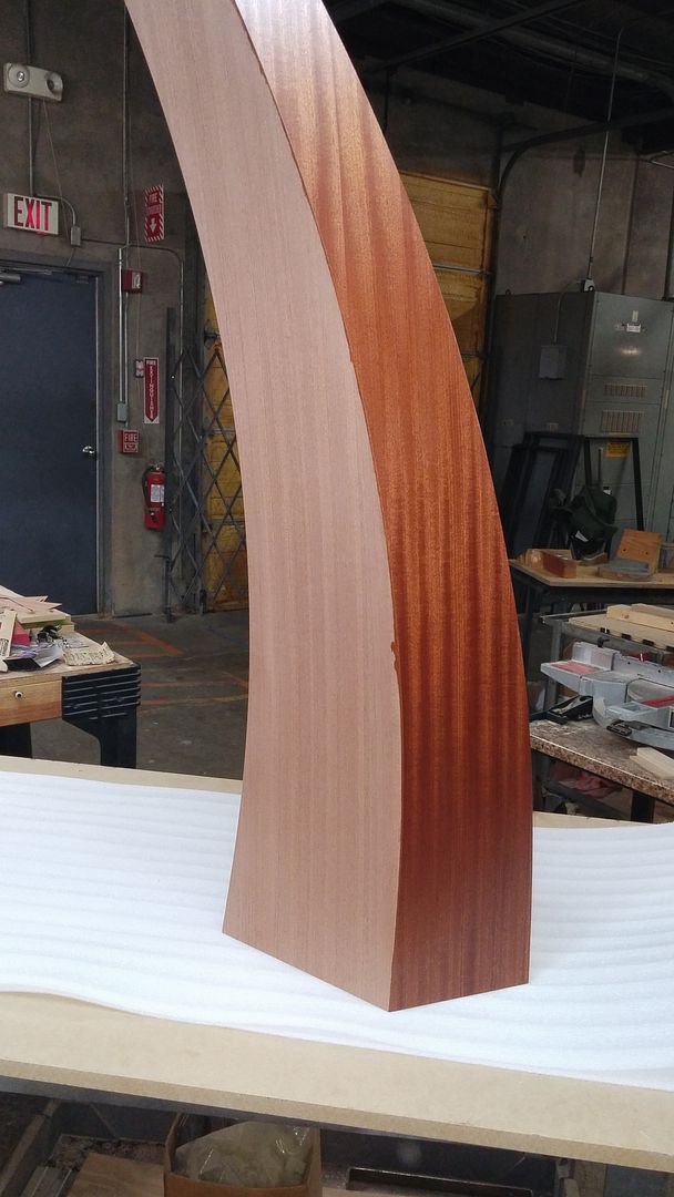

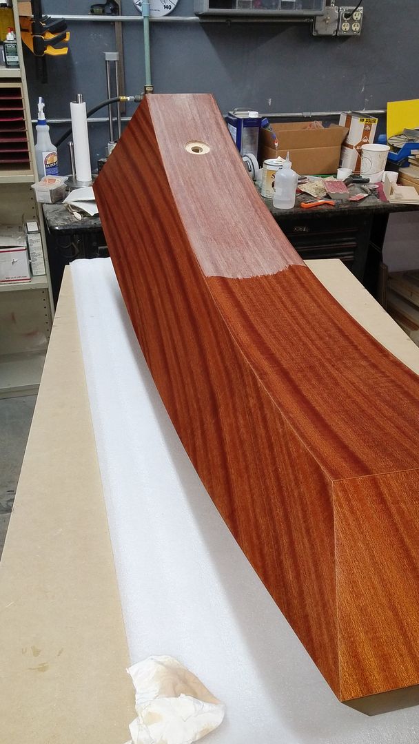

                  • Wow, six weeks have gone by since the last update! Sorry fellas, the delay was due to a move and the new home was too nice to pass up. Kole is super excited because he has an upstairs bedroom now. We're starting to adjust and get settled in now so it's time to get back to work on the arrays. Still following John's finish recipe and it's working great so far. Had to finish the baffles first and get a couple of coats of seal coat on them to prevent the BLO from effecting them if I got messy on the Sapele. The baffles took up the better part of one of those six weekends that went by. That was followed by the first coat of BLO to the Sapele, and that was another one of those weekends. After that was the moving process. Just me and Kole for the most part so it took a while. These first couple of photos were taken over a month ago so I believe the first coat of BLO had plenty of time to dry. Still get blown away every time I apply the oil. The Sapele looks so plain dry, then you apply the oil and it just comes to life, amazing! Really hoping they will look close to this after the Lacquer.
                    This weekend consisted of one coat of seal coat over the BLO followed by grain filling and then the second coat of BLO. Here are a couple of more pics although they wont look much different than the previous ones. You probably can't tell from the photos, but with just one coat of the grain filler they feel smooth as a babies .... No sense trying to type it, stupid software thinks it's a bad word.
                    Couldn't find a lot of information about grain filling with Crystalac. Worked out a technique that seemed to yield pretty good results for me. Here is a video showing how I did it. Let me preface this with the statement: In no way am I claiming to be a master woodworker, in fact, don't have much more experience at that than speaker building. Just kinda feeling my way around taking advice where I can, when I can and following that with the old saying, practice makes perfect. For the record, these are far from perfect but I'm learning to accept my limitations and working to improve my skills. The video is a little long at 6 minutes and needs some editing. For now, the arrays take priority, learning how to edit a video can wait.
                    https://www.youtube.com/watch?v=VEj3DlASIrM
                    So, now they sit again for another week. Next weekend the final part of the finish process gets completed, hopefully. It will consist of putting on another coat of the Zinsser Seal Coat and then spraying the lacquer, Yee Haw! That's Texas yall!
                    One more thing to add. I sent Rick the Clio files from the two woofers in series and the four tweeters in series. He will be working on the shading values so we can incorporate all of the parts required in the order to be placed within the next week or so. Once that stuff lands, doubt I'm gonna sleep again until I hear em fire up. Thank goodness someone created Energy Drinks.
