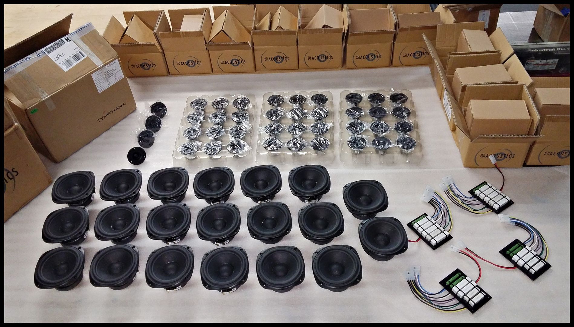

                        • Evidence the end of the build is close, very close! That late Christmas present finally arrived.
                          Enclosures are done for the most part, just need to fluff and install Acousta-Stuf , then the drivers. Shading boards are built and ready to be installed. Still need to build the harnesses from the amp to the speakers, that shouldn't take long.
                          This weekend will consist of running a few test to confirm everything on my end is right, rub and buzz, impedance, and then some sweeps. Will be working with Rick on and off over the next week to finalize the programming on the DSP. With a little luck (fingers crossed), these may actually get fired up and roaring by next weekend. Will post final pics of the enclosures later this weekend once the drivers are installed and will follow that up with the measurements once they are completed.
                          Was thinking about recording these playing a few different songs once everything was worked out but I don't have any idea what is needed to create a high quality audio recording for YouTube. Does it take specialty equipment? And if so, wouldn't it still only be as good as what the viewer is listening to it with amp and speaker wise?
                          More updates soon fellas!

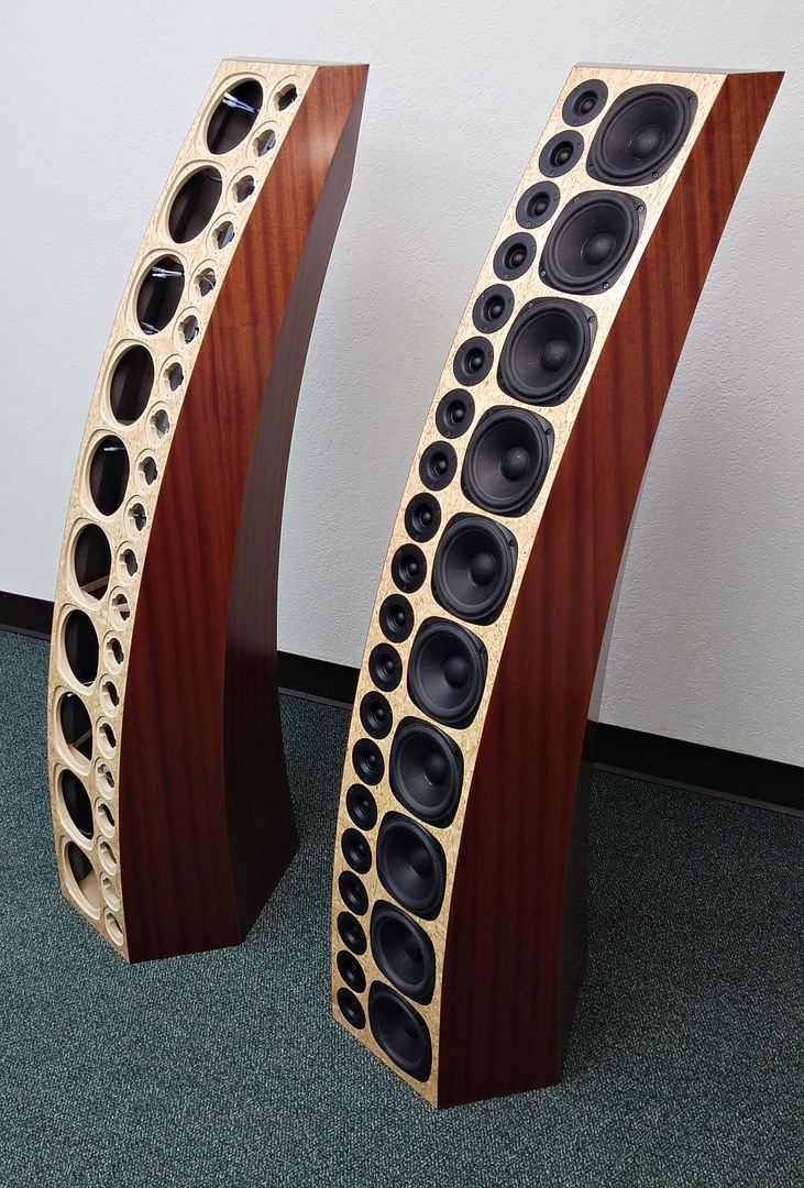

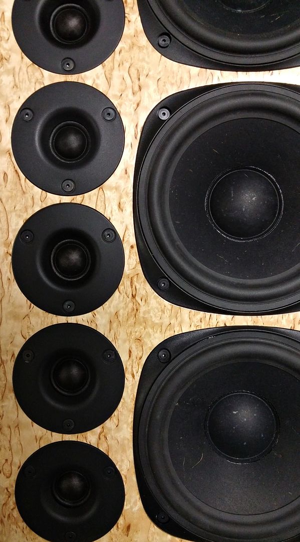

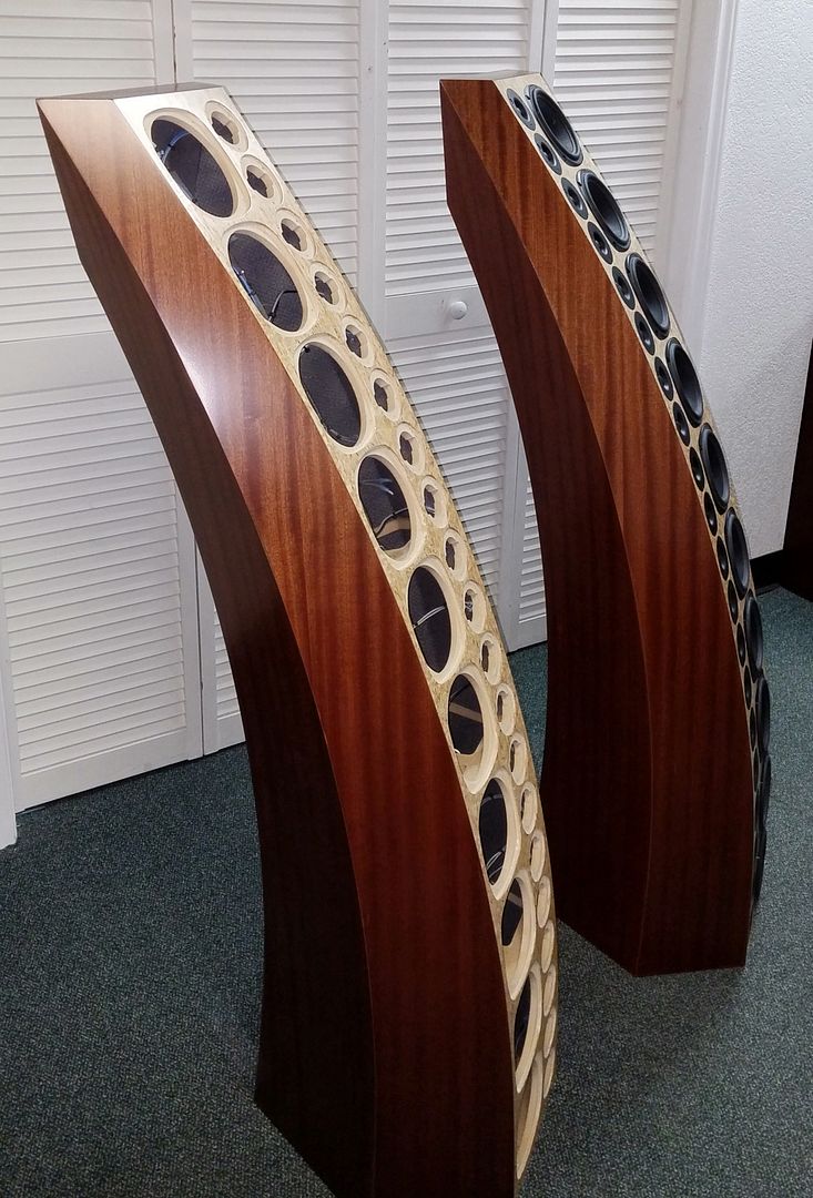

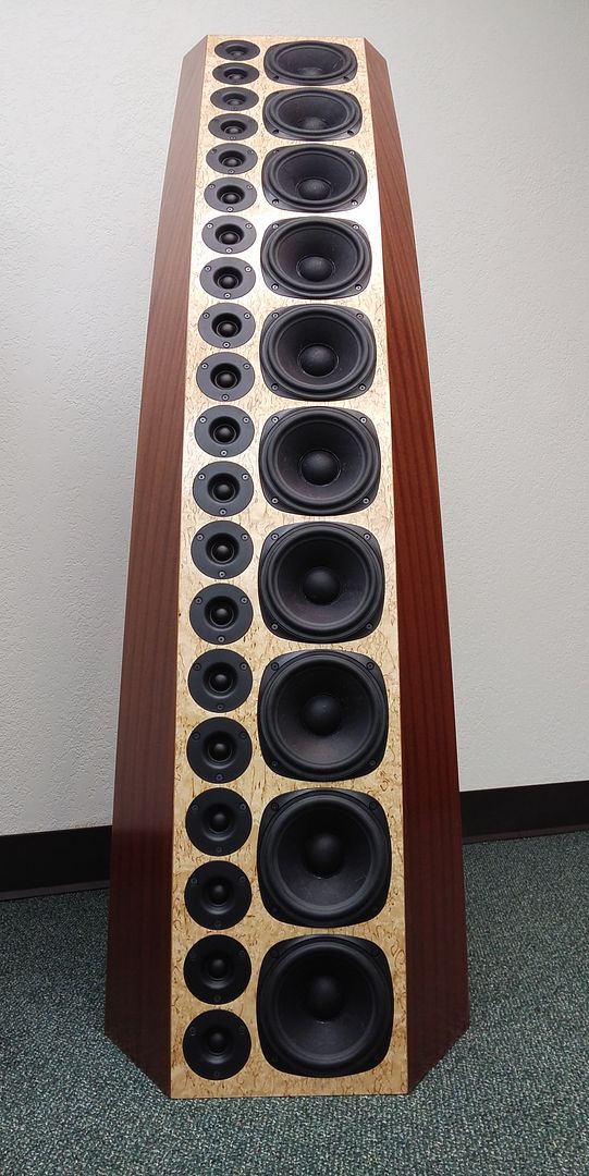

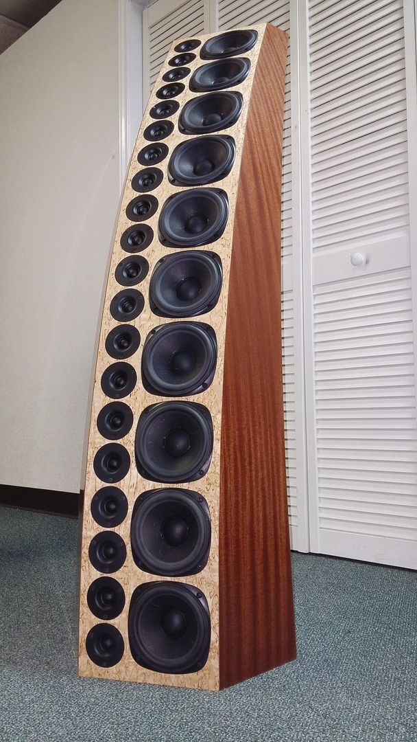

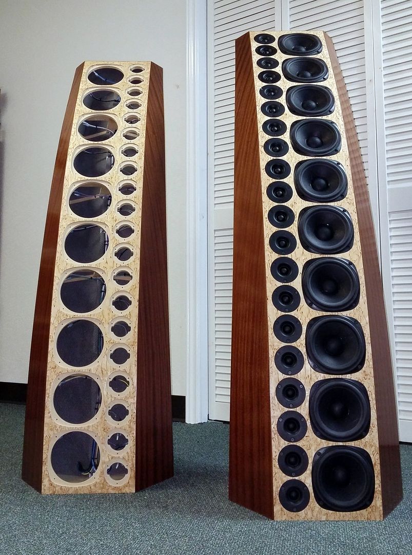

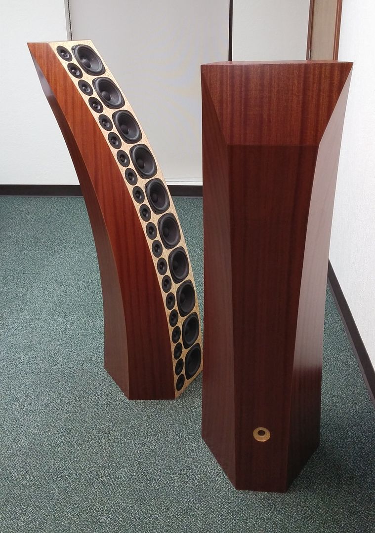

                          • It was a long day but I feel like I made some good progress. One of the cabinets is completely finished, the other will follow in a couple of days. Plan on spending tomorrow learning how to use the Omni-Mic. Once I have some good measurements from the first speaker, I'll send those to Rick so he can start doing his thing and in the meantime I will go back to work on the second cabinet.
                            Today consisted of lots of testing to confirm I have everything wired right and to make sure all the drivers are good. I did a "Rub and Buzz" test on all of the tweeters, one out of the 40 failed. The test sample had an Fs of 875hz, the one that failed showed over 1450hz. All of the others were within 5-10% of the original. I ordered a couple of extra tweeters so no big deal. Performed the "Rub and Buzz" test on the woofers twice. Once before installing and once after installing, they all passed with no problems. After all of the woofers were installed, used a AA battery to check each bank and confirm the drivers were in phase, everything was right. Still need to do a phase check on the tweeters but don't have any reason to suspect anything is wrong.
                            Part of what took so long today was "poor planning" on my part. I made the decision this last week to change from Phillip's wood screws to Allen head machine screws to mount the drivers. Because of this, 100 t-nuts had to be installed the hard way and that took a while. To me, it was worth it, I love the look of these screws with the drivers.
                            Here's some pics. Yep, they were all taken with the camera on the phone, it's all I've got. I'll try to put a real camera in the budget later this year. Anyway, the phone isn't to blame for one of the characteristics of the speakers. The Sapele can almost appear to change hues depending on where you are standing and how much light is on it. If it has very little light on it, it looks reddish brown. If it has a lot of light on it, it looks more orange. I love it!! This first photo shows exactly what I'm describing, they appear to change colors as you move from the bottom to the top of the photo.
                            I took pictures in two different rooms, my office and the conference room. The pics above were in the conference room with no flash, the pics that follow this were taken in my office (which has a couple of lights out right now) so the flash was used to offset how dark it was.
                            I've tried about everything to get a good picture of the Karelian baffles, not much luck. It's difficult to get a good shot of it with out the glare taking away from it. The Karelian is quite stunning up close. This pic also show the screws I decided on. Wish they had done a better job on the black plating but it will have to do.
                            That's about it for this weekend fellas. Hopefully I can post some measurements of the finished speakers by next weekend. I'm dying to hear these fire up and this next week is going to be like one gigantic tease, all I can do is look at em!
                            If any of you guys have suggestions for good demo CD's, let me know please. Rick is trying to get me that track Don played last year at MWAF of the prop plane. Wish I never would have heard that on Don's CBT's, it's what started me down this path months ago.
