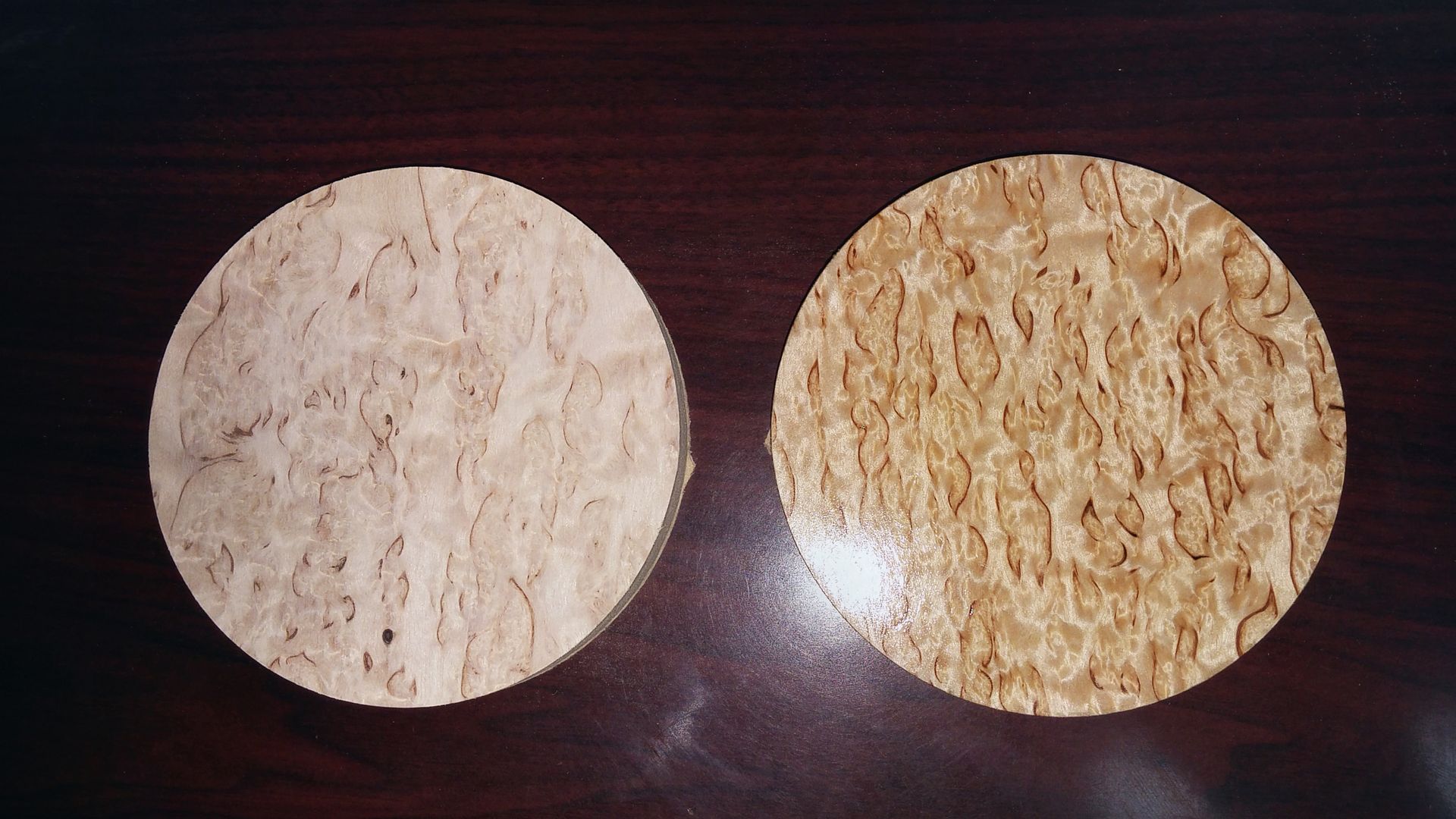

Nothing has been applied to the raw veneer yet so all finish options are still on the table. I have applied Wonderfil grain filler to the baffles and will probably pick up some for the Sapele tomorrow. Since the Tung oil is probably not going to be the finish of choice, I could look at filling the grain with a darker color to add some depth and contrast to the Sapele.
In other words, I am definitely looking for opinions on how to finish these. There's a lot of work tied up in these so far and the last thing I want is a finish failure due to my inexperience. I like the shellac on the baffle scraps, just concerned about how difficult the French Polish technique would be working around all of the driver holes. Thanks for all of your input.
Unfinished Karelian Birch on the left and Zinsser clear shellac on the right. Not French polished, just wiped on.
