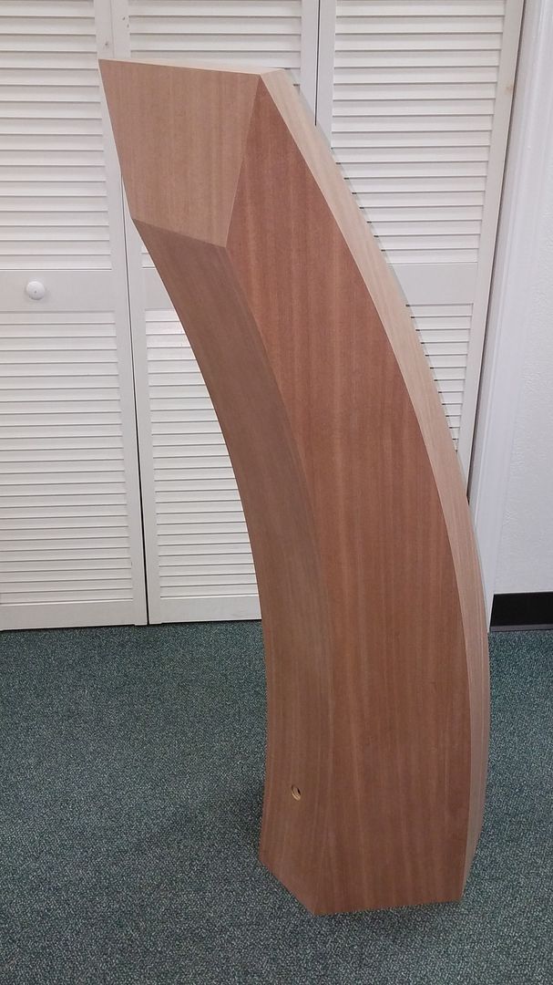

    Kevin, they look amazing.
    Or I should say... 'it' looks amazing. Good choice to have the veneer go straight up/down, that looks good. We need a pic with you or Kole standing next to them for scale. I bet getting the veneer edges perfect took a lot of time. That's fussy, work with a sanding block, and a lot of it -- a labor of love!
    They look to be shaped so the base will rest under one hand and the other arm can cradle the middle so it's somewhat comfortable? ... still... yeah, lift with your legs!

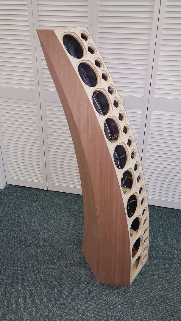

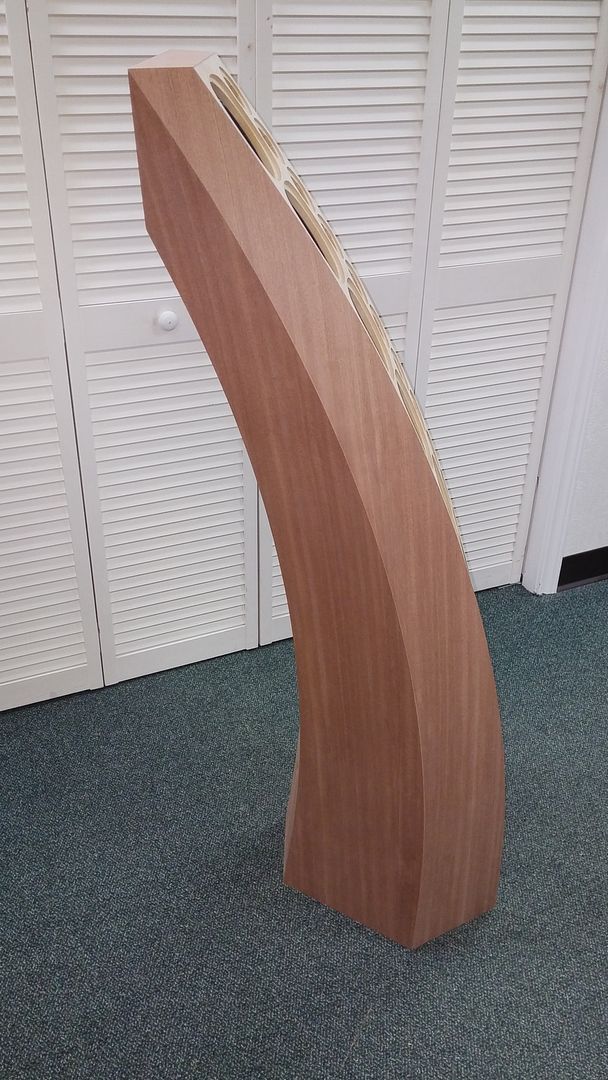

  • Kevin K.
    replied

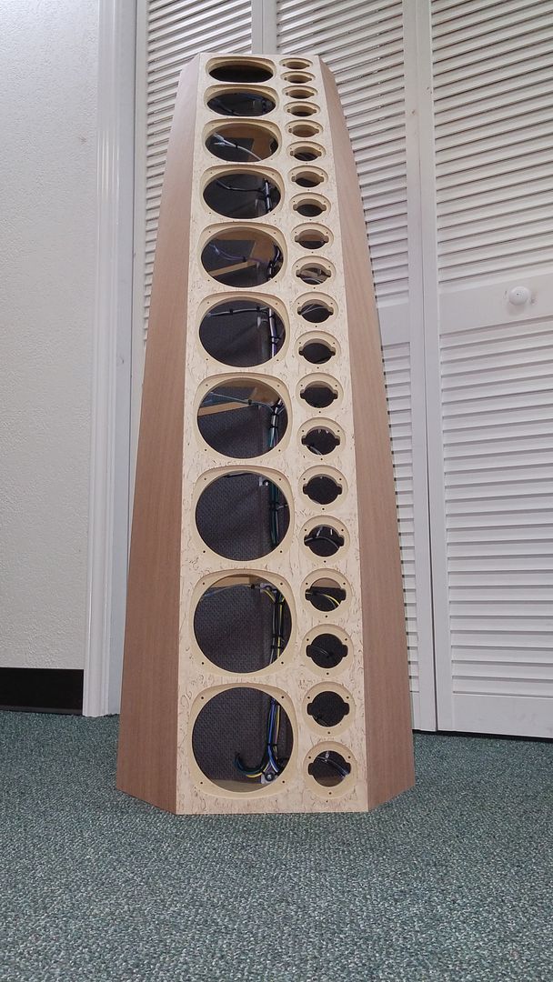

    Nearing the home stretch now. Veneer on one of the cabinets, no finish yet. Hope to apply veneer on the other this weekend and then all that will leave is finish work, and a lot of it I might ad. Still have another week or so to play with some different finishes. Tried some Tung oil on a piece of the Sapele scrap, really liked how it brought it to life. Tried Roman's suggestion and applied Shellac on a piece of scrap from the baffles, really liked that also. I suck at French Polishing so I may have to settle on Lacquer. Anyhow, here are some pics:
    The last photo is a trick I learned from Tom. Get down on the floor to take the picture, it makes them look huge. This also kind of added the roller coaster effect to it.

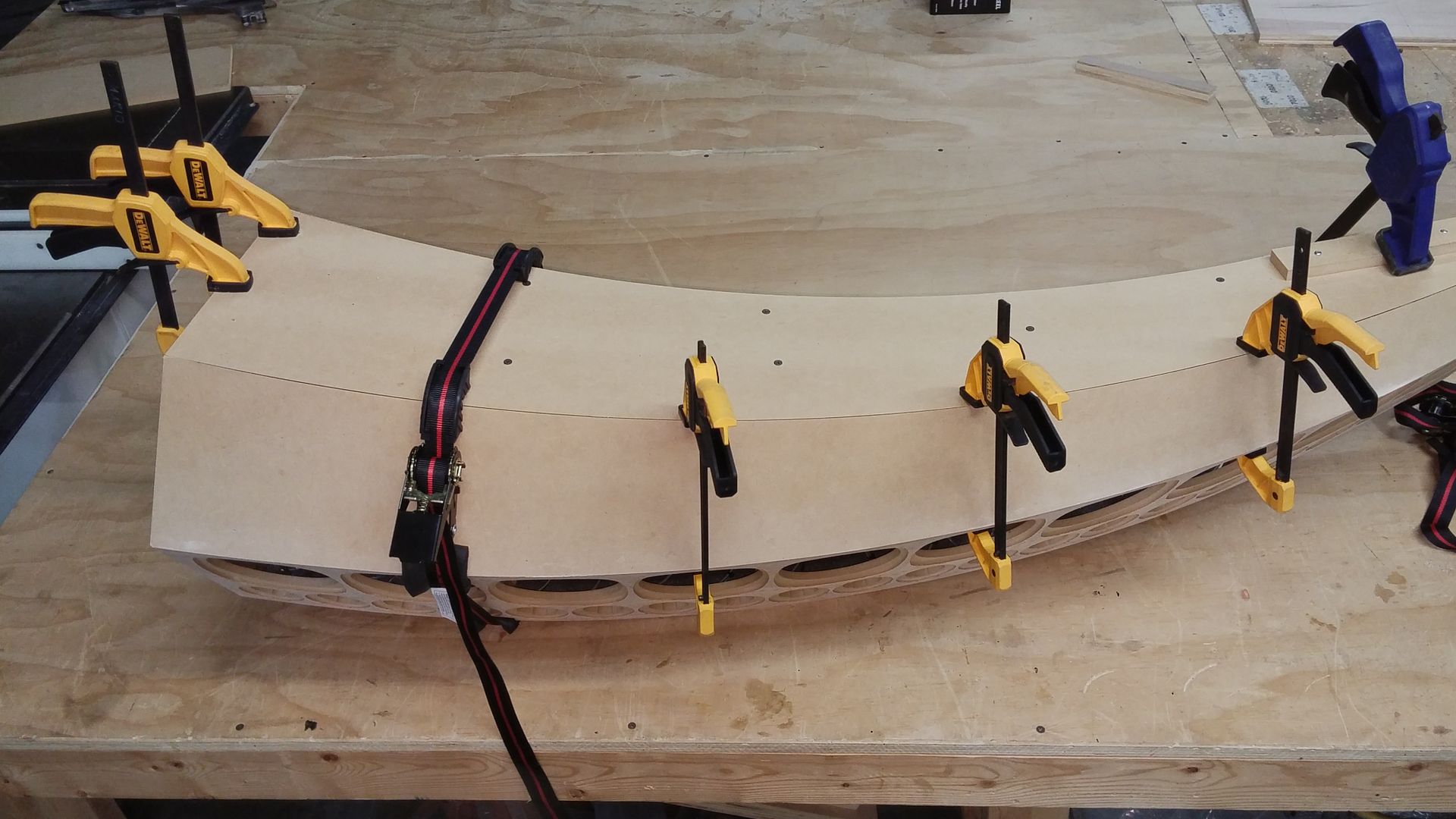

  • Kevin K.
    replied
    Some updates....

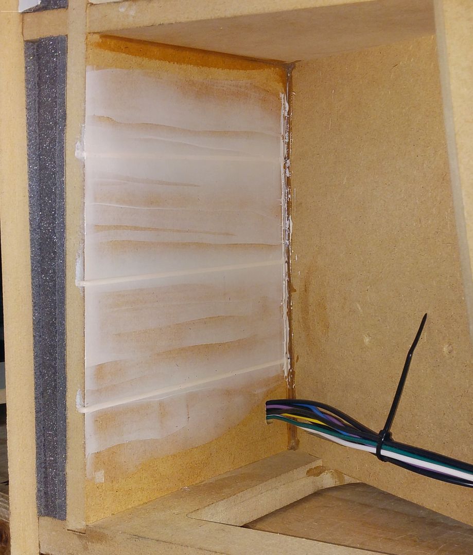

    Earlier in the thread I mentioned back-filling the grooves that were cut in the panels to allow them to flex easier. Used an epoxy laminating resin, added Cab-O-Sil silica to thicken it to a peanut butter consistency and packed it into the grooves.

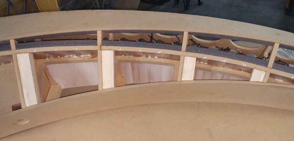

    Here is a pic of the 1-1/2" blocks that were added for securing the last panels.

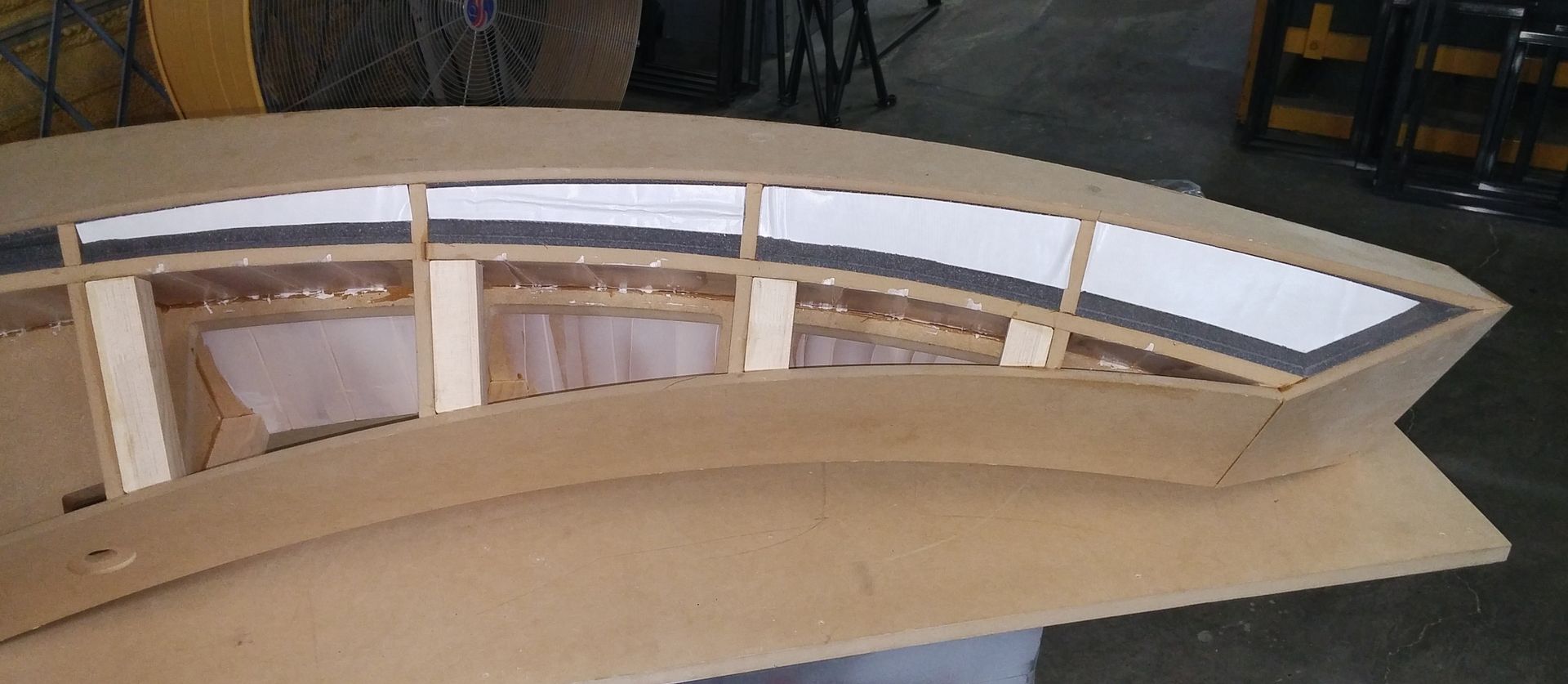

    Finished cutting the last of the damping. These stayed in place since they were trapped between the other two damping panels. Just had to remove the paper right before securing the panel. Will go in and hand press them to the panels after the panels are glued.

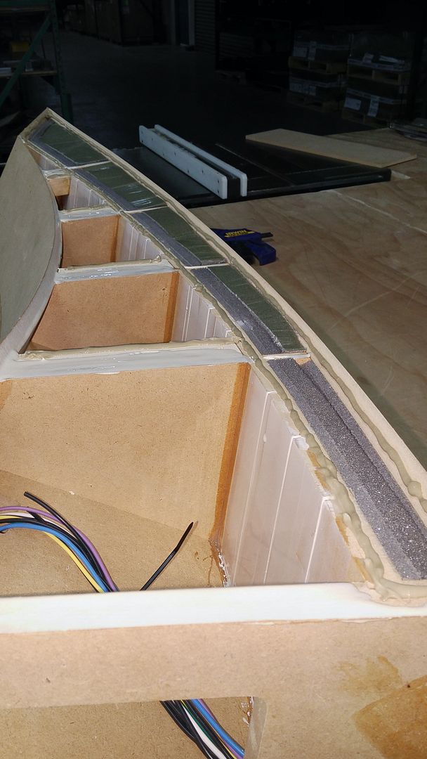

    Picked up a tube of the PL Premium. Glued a test piece Monday afternoon and tried to break it apart on Tuesday. This stuff is awesome! The consistency looked to be exactly what I needed for this. Applied a 1/4" bead down the middle of the panels that surrounded the enclosure and used titebond everywhere else.
    The final panels were clamped, strapped, and screwed. Sydney's foam suggestion for the ratchet clamps worked great, no damage to the veneer.
    Took a look inside after one of the panels was secured and the PL Premium looks like it worked out perfect.
    Much obliged for all the suggestions fellas, they worked out great!

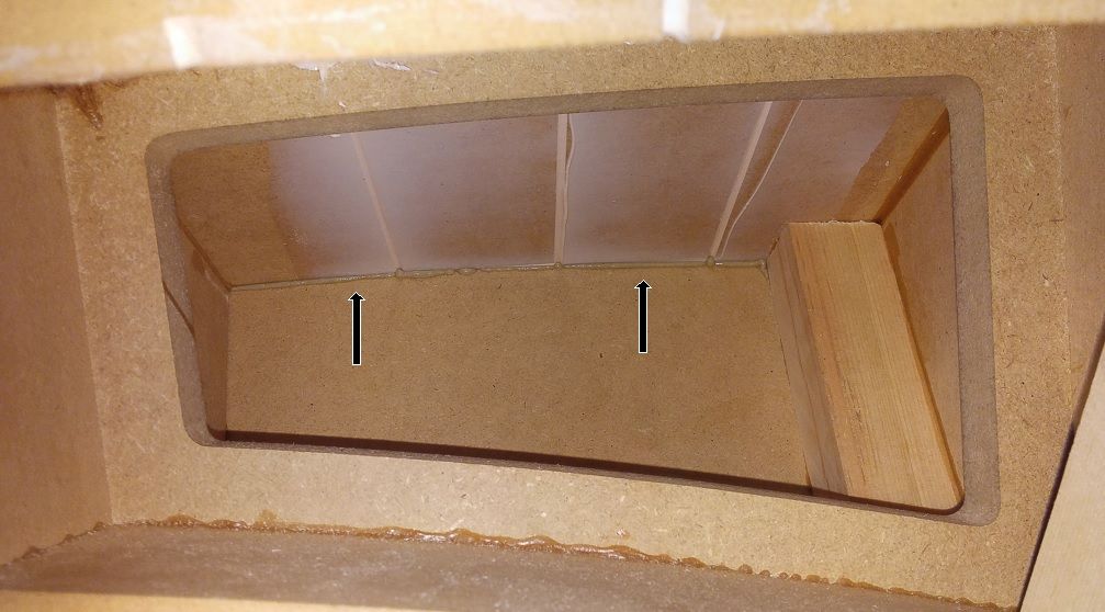

  • jhollander
    replied
    I've used the both the gorilla glue and PL polyurethane in tubes. I prefer the PL in tubes as it's thicker and you can get a decent bead on the MDF edges. I've also used a spray bottle to add moisture when I did a glue up in the winter. My only tip would be to clamp/ screw/ hold for a day or two. The poly glues don't seem to get hold strength as fast as the yellow glues.

  • Wolf
    replied
    The GG should likely work for that sized gap. Both are polyurethane glues. I like using a sponge, as a spray bottle will wet a lot more surface area than you may want to in application. I know of others using spray bottles, but I've not preferred that method. I use a small blue scotch-brite sponge I've had in the garage for years for this purpose alone. You just have to get it moist, not soaked. I would make a sample first to test your methods.

  • Kevin K.
    replied
    Originally posted by drab View Post
    Cut the panel into two pieces so you can visually ensure the chamber is sealed? Use something thicker like a soft rubber/putty or perhaps silicone on just that joint? Never done anything like this so these are just WAG's here.
    I like the idea of cutting the panel into two pieces to visually ensure it's sealed but feel that could lead to problems after the veneer is applied and the seam might telegraph.

  • drab
    replied
