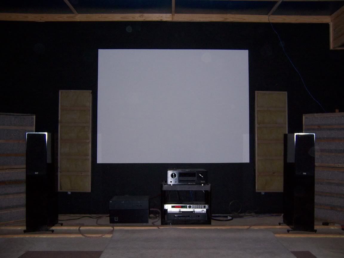

                            Denim insulation is hard to find around here but Lowes and the local hardware store have Roxul, it's supposed to be a better noise suppressor than fiberglass and not itch. Cellulose seems to be more dense and much better at blocking sounds than fiberglass, if I could of thought a way to permanently affix cellulose to the inner walls of the cabinet, I'd have used it.
                            The dedicated shop listening room had some terrible peaks, using a combination of home made open face fiberglass and cellulose panels, it was possible to somewhat target specific frequency ranges. Only part of the room treatment is visible in the pic, panels also line the side walls. By varying placement, materiel, thickness, and even the distance from the wall mounted to, it became a good listening room. It took a lot of time and work ... if REW had been around back then the job would have been easier. This was my reasoning behind using different types of padding in the speaker cabinet, attenuation of a wider range of frequencies.
                            For me DIY is about what I can do with what is on hand, easily available, and (champagne on a beer budget,) affordable. It's a good feeling when things go right.
