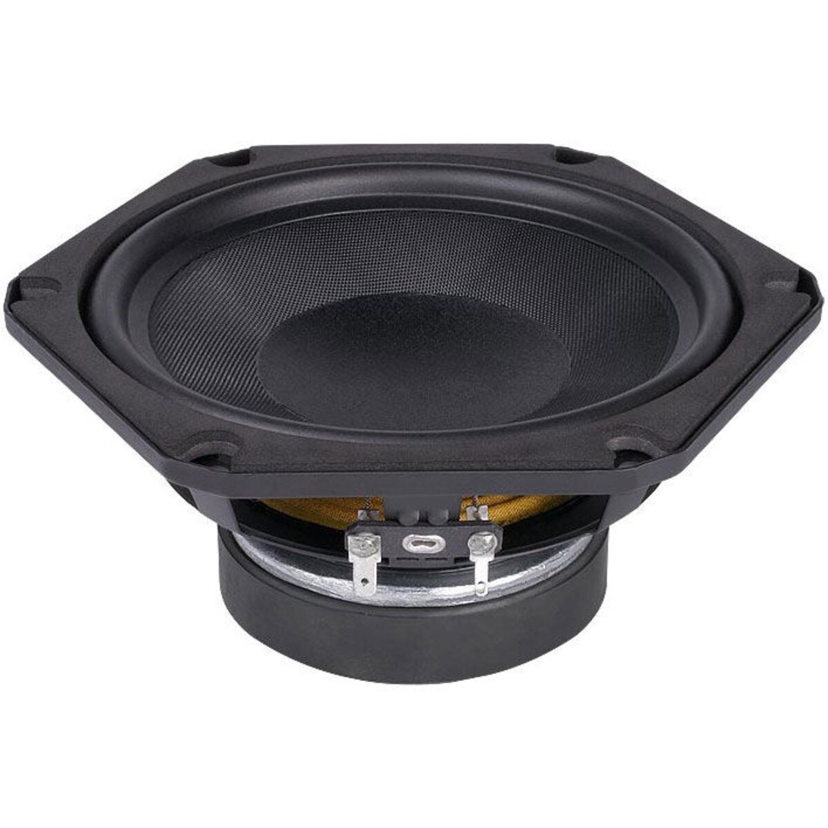

                  Matt,
                  If you are looking outside the box and committed to 80Hz and higher, I would give serious consideration to some pro-audio drivers. The CSS is awesome - but it lacks any real sensitivity.
                  FaitalPRO 6FE100 6" Professional Midrange Midbass Woofer 8 OhmFaitalPRO's 6FE100 6" professional midbass woofer driver has an extremely flat response from 63 to 5,000 Hz for use in applications where high fidelity is required, such as studio monitors and reference speakers. Great off-axis response up to 3,000 Hz allows it to be combined with many high frequency drivers and tweeters for a great sounding two-way speaker.A damped fiberglass cone with a half-roll an NBR (Nitrile Butadiene Rubber) surround offers outstanding durability, while the truncated, stamped-steel frame allows for very tight speaker-to-speaker placement which is ideal for multi-way speakers and line arrays. To combat distortion, an aluminum demodulation ring is placed atop the pole piece to reduce stored energy and inductance. Made in Italy.
                  I am thinking something like this Faital might be worth a try. Absent eq/boost it might not hit the 80Hz cutoff in a lossy enclosure like a car door, but - it has very high thermal and mechanical power handling (especially if you highpass it at 80hz) so you can definitely use some EQ and wattage to get the response you want. It is reasonably shallow at 3.33", as well. The only drawback I can see is it uses a treated paper cone. That might prove to be unreliable in a car over the years. Otherwise it is a winner - good smooth response, good off-axis response, good sensitivity.
                  I am curious to see what you end up with - this thread stirred something in me, as well so I reached out to a buddy and am buying one of his JBL MS-8 units from him to do a moderate upgrade to the sh!tty factory system in my Soul.

                    Nice ... you have my interest piqued with that Fatal for sure!
                    I know you know... but just to share my experience so far, what I've learned as car systems go.... Either I was delusional 10 or 12 years ago and it really didn't sound as good in my Saab as I remember it sounding (maybe I've come a long ways), or my Volvo is just a really crappy platform for a system. And realistically, either might be true. My issues with the car system, as well as what I've learned are as follows...
                    1. Separation between the front speakers and my subs- there just isn't much synergy there, but I'm hoping I can fix that by finding the right front door speakers (maybe those Faitals are the answer), and maybe even different subs or go to a single sub (sacrifice some bass/output for sound quality). I'm really curious how one of my SB Acoustics SB29NRX75 woofers would sound in my car.
                    2. Tweeters in the dash that are aimed at the windshield don't perform the way I anticipated. What seems to happen is... the tweeters are a LOT louder (probably due to the reflection), and they seem to have an enhanced output somewhere between ~2khz and around 4khz- but that might be caused by the "cavity" in my car's dash they're mounted in... so YMMV.
                    3. I should look into a RTA mic, because the OmniMic is almost worthless in this situation. It seems reliable above roughly 500 Hz... but up to that who knows what's really going on? And, designing a passive crossover in a car is really hard (IMO) for multiple reasons. I think active will be (by far) the best option.
                    4. Regarding time alignment- I've always tried to avoid this in the past simply because if I time align it for the driver's side, it's going to sound twice as bad on the passenger side. Maybe I'll bite the bullet on this and just set it up for the driver's side? Or, some DSPs have presets (not sure about the car audio ones though?), so I could maybe do 3 presets... one for the driver, one for the passenger, and one for driving the car with a driver and a passenger??
                    But, I am having fun. The only downside is that when I want to try new speakers, it's a bit of a PIA because I have to remove my door panels, and Volvo didn't make that any too easy, hopefully Soul thought that thru a little better than Volvo did. But, I won't give up, and God willing, someday I'll be content with this car's stereo . I'm also afraid to buy a new head unit. I remember when I got my Eclipse dbl din that I have now, it sounded a little worse than the single din Alpine I replaced with it did (but I kept the Eclipse anyhow because I wanted the navigation). But, I tried a Pioneer AVIC-940bt, and even though the Pioneer had a lot more features, I was sorely disappointed in that over my Eclipse, so back in the box with the Pioneer. Not sure if they've made improvements since then?... that was about 6 or 7 years ago. I want a new one because I want Bluetooth... I bought a JL Audio BT receiver and hooked it to my Eclipse aux, but the JL is a tad noisy and just doesn't sound as good as I hoped.
