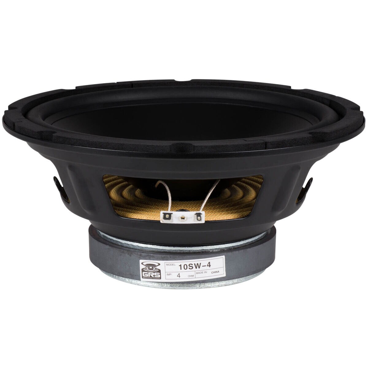

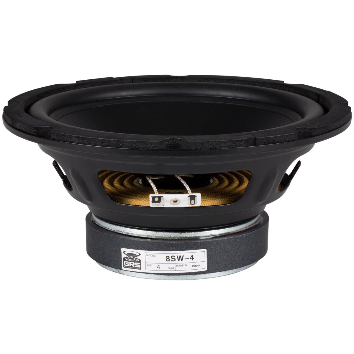

        Maybe GRS 10SW-4 or the GRS 8SW-4.
        GRS 10SW-4 10" Poly Cone Subwoofer 4 OhmNow you can replace blown or damaged subwoofers with new drivers that equal or outperform the original! GRS poly cone subwoofers are not only the perfect replacement for tired, worn out subwoofers in a variety of audio gear, but they are also a great choice for new designs. Their handsome polypropylene cones provide durability and good looks, while the large vented magnet assemblies and extended voice coils enable long-throw performance and authoritative bass in a variety of enclosures. The 10" model features a 2" diameter voice coil with big 8.5mm excursion for solid bass performance in compact sealed and vented enclosures. These versatile subs are also rugged enough to be used in dipole and automotive infinite baffle applications. See the below list of recommended enclosure alignments for new design.Recommended sealed enclosure: Vb = 1.0 ft^3, F3 = 42 Hz, Qtc: 1.17Recommended vented enclosure: Vb = 1.5 ft^3, Fb = 35 Hz, F3 = 32 Hz
        GRS 8SW-4 8" Poly Cone Subwoofer 4 OhmNow you can replace blown or damaged subwoofers with new drivers that equal or outperform the original! GRS poly cone subwoofers are the perfect replacement for tired, worn-out subwoofers in a variety of audio gear and even work great for new designs. Their handsome polypropylene cones provide durability and good looks, while the large vented magnet assemblies and extended voice coils enable long-throw performance and authoritative bass in a variety of enclosures. The 8" model features a 1-1/2" diameter voice coil with extended 6mm excursion for solid bass performance in compact sealed and vented enclosures. These versatile subs are also rugged enough to be used in dipole and automotive infinite baffle applications. See the below list of recommended enclosure alignments for new designs.Recommended sealed enclosure: 1.0 ft^3, F3 = 48 Hz, Qtc: 1.16Recommended vented enclosure: 1.0 ft^3, Fb = 40 Hz, F3 = 34 Hz
        In either case maybe with a passive assist to move F3 down a bit?
        Can not beat the price.
