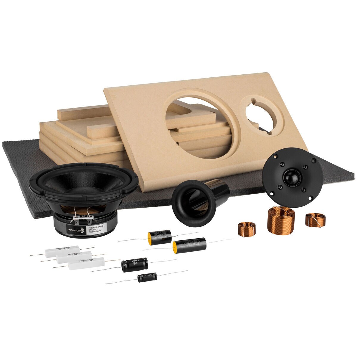

              Can't go wrong with the Classix II.
              Classix II MT Bookshelf Speaker Kit with Knock-Down CabinetThe Classix II kit is a 2-way bookshelf speaker that provides a big sound from a small package. With powerful bass response, relaxed midrange, and natural high end this speaker has the ability to make even poor recordings sound great. With the exceptional low frequency ability of the popular Dayton Audio DC160-8 6-1/2" woofer the Classix II delivers plenty of bass for most small to medium sized rooms. For the upper frequencies this kit uses the Peerless by Tymphany BC25TG15-4 1" silk dome tweeter which is known for natural, non-fatiguing response making this speaker ideal for long listening sessions. The solid 3/4" MDF enclosure panels are all CNC milled by Denovo Audio to tight tolerances ensuring easy assembly. The finished enclosure includes a center brace tying all sides together minimizing cabinet resonances. Recesses for flush mounting the drivers and the opening for the port are pre-cut making assembly a snap. According to Paul Carmody," I know you'll think I'm kidding, but of all the speaker designs I've done, if I could only keep a handful, these would be near the top of my list…the Classix II have a "euphonic" quality about them. They "gloss over" many of the problematic details of popular music (that an "audiophile" speaker would glare at you with), but at the same time are engineered to be revealing enough that most people would be surprised to hear new things in favorite old recordings." This kit includes nearly everything you need to build a top-notch speaker in no time, including: a knock-down cabinet, drivers, port, damping material, and crossover components. This kit includes parts to build a single speaker.Included Components:QtyPart NumberDescription1027-424Dayton Audio DMPC-6.8 6.8uF 250V Polypropylene Capacitor1027-422Dayton Audio DMPC-4.7 4.7uF 250V Polypropylene Capacitor1027-34010uF 100V Non-Polarized Capacitor1027-360100uF 100V Non-Polarized Capacitor1255-026Jantzen 1528 0.25mH 20 AWG Air Core Inductor1255-036Jantzen 1034 0.50mH 20 AWG Air Core Inductor1255-254Jantzen 1901 1.2mH 18 AWG Air Core Inductor1004-4Dayton Audio DNR-4.0 4 Ohm 10W Precision Audio Grade Resistor1004-6Dayton Audio DNR-6.0 6 Ohm 10W Precision Audio Grade Resistor1004-10Dayton Audio DNR-10.0 10 Ohm 10W Precision Audio Grade Resistor1264-1040Peerless by Tymphany BC25TG15-04 1" Silk Dome Tweeter1295-305Dayton Audio DC160-8 6-1/2" Classic Woofer1260-402Port Tube 1-1/2" ID x 4" L Flared1260-520Sonic Barrier 1/2" Acoustic Foam w/PSA 18" x 24"1N/ADenovo Audio Classix II Bookshelf Speaker Knock-Down CabinetNote: Screws, binding posts, and speaker wire are not included. Specifications: • Power handling: 60 watts RMS/100 watts max • Frequency response: 35-20,000 Hz • Impedance: 8 ohms • Sensitivity: 86 dB 1W/1m • Dimensions: 15" H x 8.5" W x 11-3/4" D Note: Crossover components may be substituted with parts of equal or higher quality depending on available inventory.
                https://www.parts-express.com/classi...inet--300-7112

                  I use the Classix II in my workshop and they're excellent; I have installed speaker grills for dust protection, but they won't stop everything, so I put plastic bags over the speakers when not in use. The cabinets aren't big, but the sound is.
                  For a similar price you could also build the Tritrix MTM, and they're excellent speakers too. They sound different, of course, the Classix have more low bass, with slightly relaxed mid-range; the Tritrix have a little less bass (unless you build the TL version) but the mids are a little clearer. But they're both excellent speakers.
                  I use the Tritrix inside: the DC28F tweeter has a sticky dome material which seems to love dust and fluff, although at least in our case it doesn't seem to affect the sound. You can always get a replacement dome. if you need to.
                  The Classix crossovers have more parts but are still easy to put together even for a soldering novice like me.
