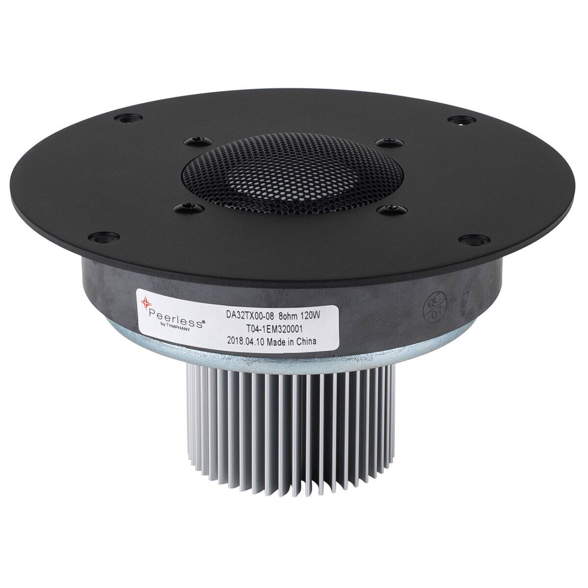

Found some more work for you to do. This looks pretty amazing:
Peerless DA32TX00-08 1-1/4" Corundum Dome TweeterPeerless designed the DA32TX00-08 1-1/4" corundum dome tweeters for both hi-fi and professional applications. With their unique material and design enhancements, these tweeters are built for industry-leading performance and reliability. Corundum, one of natured hardest substances (9 out of 10 on the MOHS hardness scale), is extremely rigid with excellent damping which pushes any dome resonance well outside of the audible range keeping frequency response flat to 22,000 Hz and beyond. The DA32TX00-08 incorporates a unique rear chamber that lowers the resonant frequency and serves as a heatsink for improved power handling and negligible power compression. The massive FEA optimized underhung motor assembly provides incredible control for impressive dynamics, and includes a thick copper cap on the pole piece for lower inductance with minimal distortion. In addition, the optional metal grill (held in place magnetically) protects the fragile dome from foreign objects and curious fingers. Capable of handling crossover frequencies as low as 1,200 Hz, the DA32TX00-08 will present outstanding performance in almost any 2 or 3-way speaker designs.
Comment
Originally posted by Swerve City View PostFound some more work for you to do. This looks pretty amazing:
https://www.parts-express.com/peerle...eter--264-1678
