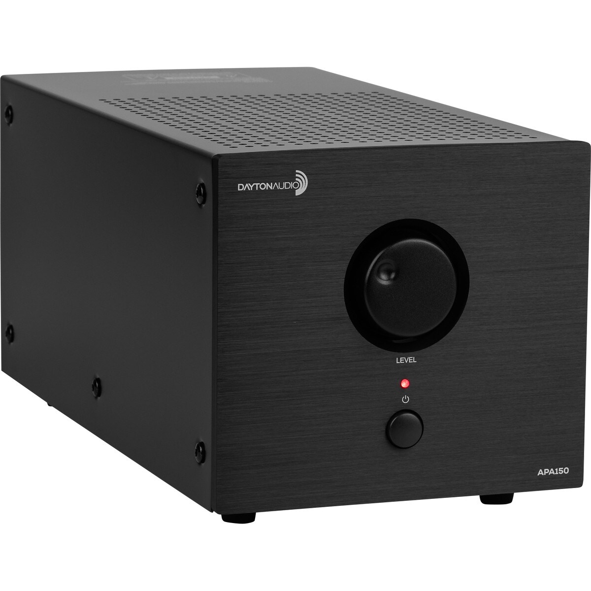

        Not a recommendation, but people seem to like this. 5 yr warranty, 4 ohm capable. Never heard one.
        Dayton Audio APA150 150W Power AmplifierDayton Audio APA150 150W Power AmplifierThe Only Amplifier You'll Ever NeedAmplifiers today need to be multi-faceted to keep up with the task at hand, and versatility is the foundation upon which the Dayton Audio APA150 is built. When configured in stereo mode, 75 watts of amplification is provided to a pair of speakers for stereo or surround playback. Select bridge-mono mode and the APA150 is ready to power a center channel speaker, or a subwoofer/tactile transducer with 150 watts when used with the on-board low pass filter. Full-range line-level outputs allow for daisy chaining amplifiers for a multi-room whole house audio system or for bi-amp applications. The APA150's smaller chassis consumes less space than conventional amplifiers, making placement options virtually limitless.New Dog, Old Tricks Standard features of the APA150 include high current, discrete power transistors (used in premium amp designs), a hefty toroidal power supply transformer, low-noise forced air cooling, and complete protection against electrical shorting and thermal overload.Total Integration The APA150 was designed for heavy duty use, including subwoofers. An 18dB/Oct low-pass filter can be set from 50Hz to 150Hz or run it in full range for higher powered speakers!The APA150 has the ability to bridge the stereo outputs to combine both channels for extra power with a single mono/stereo switch.When the APA150 detects signal at its input, it can automatically turn itself on. Once the music has stopped playing, the APA150 will turn itself off automatically to save power. No fuss and no more reaching over your expensive equipment! Shop the whole APA Series by Dayton AudioAPA102BTDual-zone 60 WPC Stereo Amplifier with BluetoothBuy NowAPA1200DSP1200 Watt subwoofer amplifier with integrated DSPBuy Now Dayton Audio's line of all purpose amplifiers has an amp for every occasion. Explore the entire collection to quickly and easily bring immersive sound to your desktop or compact space. Full Specifications: Maximum Output Power: 2x 75 watts RMS @ 4ohms, 1x 150 watts RMS @ 8ohmsTHD: <0.01%Frequency Response: 20 Hz - 20kHz +/- 1dBSNR: >100dB UnweightedInput Sensitivity: 1VLine Input Connectors: RCALine Output Connectors: RCALow Pass Crossover Range: 50 Hz - 150 HzLine Input Impedance: 47kOhmPower Input Voltage Range: 120 - 240 VACDimensions (W x H x D): 5.6" H x 5.7" W x 12.8" DWeight: 13 lbs. SpecificationsQ&AReviewsManuals & Resources

              • #9
                The APA150 I linked has a volume knob, so if as you say, you only have one source, with this amp you would not need a preamp. Power amps typically do not have volume controls.
