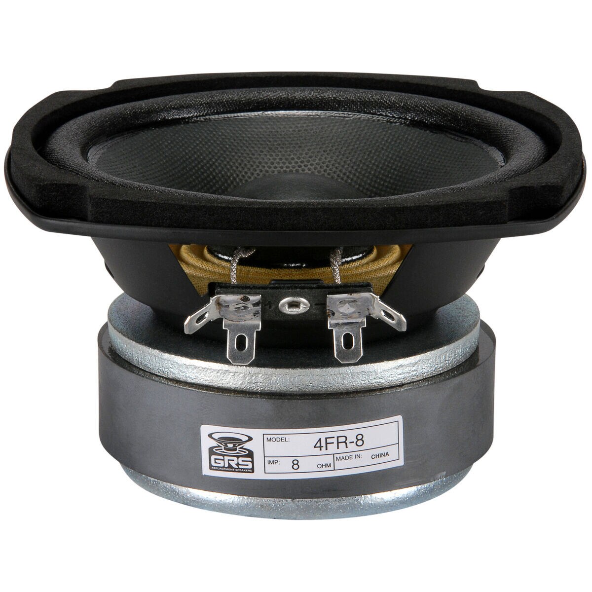

      These sound very good, although they're 8 ohms. For fit compare the 4.72" bolt hole circle diameter to the originals.
      Full-Range 4-1/2" Speaker Pioneer Type A11EC80-02F 8 OhmGRS 4FR-8 full-range 4-1/2" speaker features a well-damped paper cone and long-lasting treated fabric surround. Its design parameters have been carefully chosen to suit a wide variety of enclosures for hi-fi or commercial use, and it's great for use as a full-range driver or as a high-sensitivity midwoofer.The large ceramic motor structure and lightweight Kapton voice coil former ensure crisp, highly-dynamic reproduction. This driver is a perfect drop-in replacement for the classic Pioneer model A11EC80-02F full-range driver, or other popular 4-1/2" full-range drivers.
