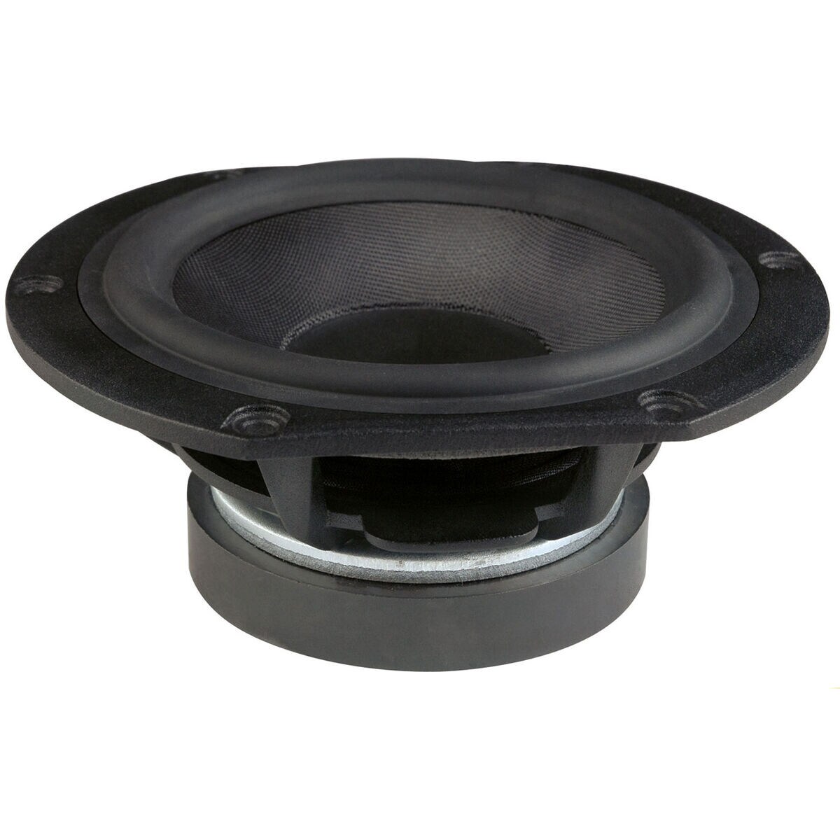

    I just updated the tweeter on my main speakers so now I have a couple CSS Audio LD22 tweeters lying around. I think I want to use them to build some bookshelves that will fit in the PE mini bookshelf knock down cabs, they're .23 cubic feet. I'm trying to go easy to build and easy on the budget so I'm thinking drivers around $40 each. ​​​​​​The real rub is I have no clue how to design the crossover so drivers that are also easy to work with would be nice. I'm sure I'll have lots of questions when I get to that point. I'm not 100% what they will be used for.. maybe computer speakers. Any recommendations are much appreciated.

                I am a big fan of the SB Acoustics SB12 PFCR 25 -4. In a 5.5L box it has an F3 of 52 and a max SPL of 98db. The TCP115, which is an amazing driver, in the same volume box has an F3 of 48 and a max SPL of 95db. The difference is that, to my ears, the SB has better resolution and less distortion. They are both excellent, and the TCP115 is dirt cheap, but the SB is also very affordable.

                      I know these are quite a bit more expensive than your $40 budget, but the SB12CAC25-08 are fantastic sounding drivers that would work perfect in your box size and with those sweet tweeters.

                          Peerless 830870... under budget and sound fantastic.
