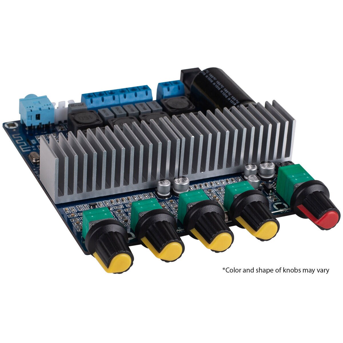

                If you're frugal and a little DIY get a cheap power supply and some little piggies to go with amp board Part # 320-635. This is more or less the board Steve Lee posted, just a lot cheaper and no frills. I love mine. I'm having trouble linking it from my phone.
                Comment

                  TPS3116D2 Class D 2.1 Bluetooth 5.0 Amplifier Board 2 x 50W + 100W with Filter and Volume ControlsMake your own 2.1 multimedia wireless Bluetooth amplifier or portable speaker with this 2 x 50W + 100W amplifier board. The board accepts 12 VDC to 24 VDC which makes it perfect for making home or mobile audio projects. Make your audio project truly portable by adding three to five 18650 Li-Ion batteries.These boards are pre-tested and pre-assembled, which makes your project easy to complete. The on-board jacks, potentiometer, and screw terminals let you get this board powered up and playing music in minutes. Just connect your power source using a 2.1 x 5.5 mm DC power plug, a 3.5 mm stereo audio source, and run speaker wire from the six screw terminals to you speakers and you're done. For the most wattage output use 120-055 24 VDC power adapter. If you don't want to use the 3.5 mm jack, an optional 3-pin connector for internal line-in audio is available (wiring harnesses not included). Push and hold in the master volume control for three seconds to switch from Bluetooth to line-in source. Push in master volume control to switch back to Bluetooth. Use the built-in 150 Hz high pass filter switch on the board to protect your satellite speakers.Specifications: • Power output: 2 x 50W + 1 x 100W @ 4 ohms • Impedance: 4 ohm for satellites and 3-4 ohm for subwoofer • Chip: TPA3116*2 • SNR: 100 dB • Frequency response: 20-20,000 Hz • Signal input: 3.5 mm stereo jack or 3-pin socket • Signal output: 6 screw terminals • Power requirements: 12-24 VDC • Maximum current draw 3A • Quiescent current: 60 mA • Power input: 2.1 mm x 5.5 mm DC jack • Dimensions (not including potentiometer): 3.94" W x 0.9" H x 3.94" D • Potentiometer shaft length: 0.6" and master volume 0.64" without knobs • Bluetooth: V5.0+BR+EDR.
                  Seems dedicated to 2.1 use. It has a 6db drop at 150 hz in the satellite output. According to the description.
              • #9
                It has a physical switch on the board to turn the 150 Hz on or off. At least the one that I have. I e turned it off. The subwoofer low pass crossover knob is separate from the switch and will work either way
                Comment

                  I did not know that. Thank you. I know PE uses that board in some of their boombox kits.
