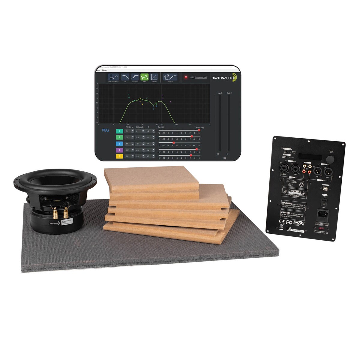

              Maybe get some bass shakers for your seat. The neighbors won't hear that..
              Also, if you're getting rid of the pictured sub, and you can't turn the bass up, you might be very happy with the PE 8" Dayton 250DSP sub kit. I have two of them, one for my PC 2.1, and one for my LXmini 2.1 system.
              Powered Dayton Audio Reference 8" 250 Watt Compact Subwoofer Kit with Built-In DSPWith just a 10" x 8" footprint, the Dayton Audio Reference 8" 250 Watt Compact Subwoofer Kit is the perfect solution for providing high performance bass response without taking up much space. With Dayton Audio's high excursion RSS210HO-4 8" subwoofer driver powered by the extremely versatile SPA250DSP 250W plate amplifier with DSP you can expect incredibly accurate response with low distortion. The user-friendly DSP controls allow this flexible subwoofer to match up seamlessly to smaller satellite speakers in everything from bedroom and office systems to smaller home theater setups. Thanks to the small size this subwoofer is ideal for using multiples strategically positioned around rooms to minimize room nodes (null and peaks) for more even bass distribution.Dayton Audio RSS210HO-4 8" Subwoofer Specifications: • Power handling: 300 watts RMS/600 watts max • Le: 0.99 mH • Impedance: 4 ohms • Re: 3.6 ohms • Frequency range: 30 to 1,500 Hz • Fs: 29.6 Hz • SPL: 85.7 dB 2.83V/1m • Vas 0.66 cu. ft. • Qms: 3.33 • Qes: 0.46 • Qts: 0.40 • Xmax: 11 mm. Dayton Audio SPA250DSP 250W Subwoofer Plate Amplifier Specifications: • Power output: 250 watts RMS into 4 ohms, THD+N <1.0% • Signal to noise ratio: 97.9 dB (A-weighted) • Low pass adjustment: 30 Hz to 125 Hz • Phase adjustment: Continuously variable from 0º (normal) to 180º (reverse) • Power requirements: 110~120/220~240 VAC selectable, 50/60 Hz.Enclosure Specifications: • Panel thickness: 3/4" • Panel material: Medium Density Fiberboard (MDF) • Finished internal cabinet volume: 0.33 cubic feet • External dimensions: 12" H x 10" W x 8" D • Weight: 23 lbs. • Made in the USA.Note: Mounting screws and feet are not included.
