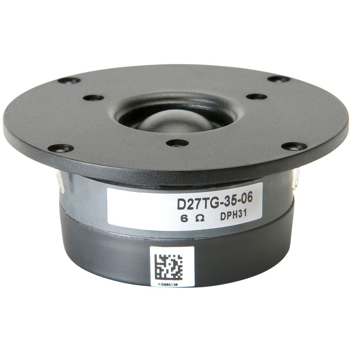

Peerless by Tymphany D27TG35-06 1" Silk Dome TweeterPeerless by Tymphany D27TG35-06 1" Silk Dome TweeterThe Perfect Drop-in Replacement Tweeter to Upgrade Your High EndThe Tymphany high performance D27TG35-06 1" coated silk dome tweeter features ferrofluid cooling, linear response faceplate, braided tinsel leads, and a double chamber for lower resonance. Key Specs:Cone Diameter: 1"Power Handling (RMS): 100WImpedance: 6ΩFrequency Response: 2,500-20,000 HzTweeter Type: Soft DomeSensitivity: 91 dB 2.83V/1m Download Spec SheetSee All Specs Bring Your Music To LifeThe Peerless by Tymphany D27TG35 features high performance, coated silk dome tweeter features ferrofluid cooling, linear response faceplate, braided tinsel leads, and a double chamber for lower resonance with high frequency extension to 20 kHz.This tweeter is perfect for any DIY bookshelf, center channel, tower speaker, or monitor build. The smooth natural high end response delivers a detailed and smooth listening experience The Perfect Drop In ReplacementThis tweeter is a perfect drop in replacement tweeter for a variety of speaker manufacturers including the Paradigm, JBL, KRK, Alesis, PSB, Fostex, Mission, Dunlavy, and many moreParadigm Monitor V2Paradigm Mini Monitor V3Paradigm 7se MK3KRK V8JBL TLX8Alesis Monitor One MK1Fostex PM-1 MK2Mission 767 Paradigm Monitor 7 V2Build by AlbbbWhat Our Customers Have Built PSB Stratus SilveriBuild by Charles KJBL TLX8 Build by Gogoup4Paradigm Monitor V2 Build by Robert EParadigm Mini Monitor V2Build by John R SpecificationsQ&AReviewsManuals & Resources
It appears they are available elsewhere.
The driver details and XO parts values are all there in Paul's write-up, the only things to consider in a full BoM would be which gauge(s) of inductors to get - and the i-core is already given - and what brands and types of capacitors, e.g. whether NPE or film, depending on the value and where they are in the circuit.
Geoff
