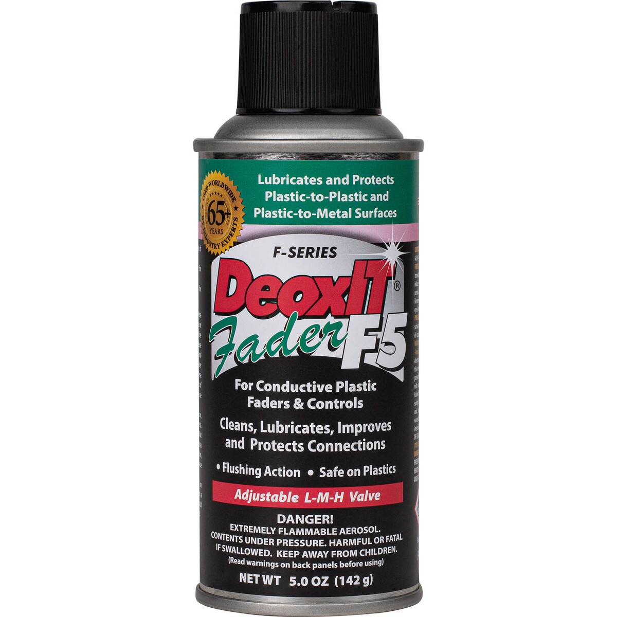

      This stuff works great for old scratchy pots:
      CAIG DeoxIT Fader F5S-H6 Spray 5 oz.Fader F5S-H6 is a precision lubricant for moving contact surfaces. Ideal for use with faders, switches, potentiometers, and other mechanisms with sliding surfaces. Maintains optimum signal quality and reduces wear and abrasion. It replenishes lubrication lost on surfaces that have been cleaned with solvents or other cleaning solutions. Formulated for conductive plastics and carbon based controls. Fader F5S 5 oz. spray provides a light 5% coating of Fader F100L liquid. Petroleum naphtha carrier solvent used to flush away dust, dirt, and contamination.

        Great thanks I’ll give it a try.
