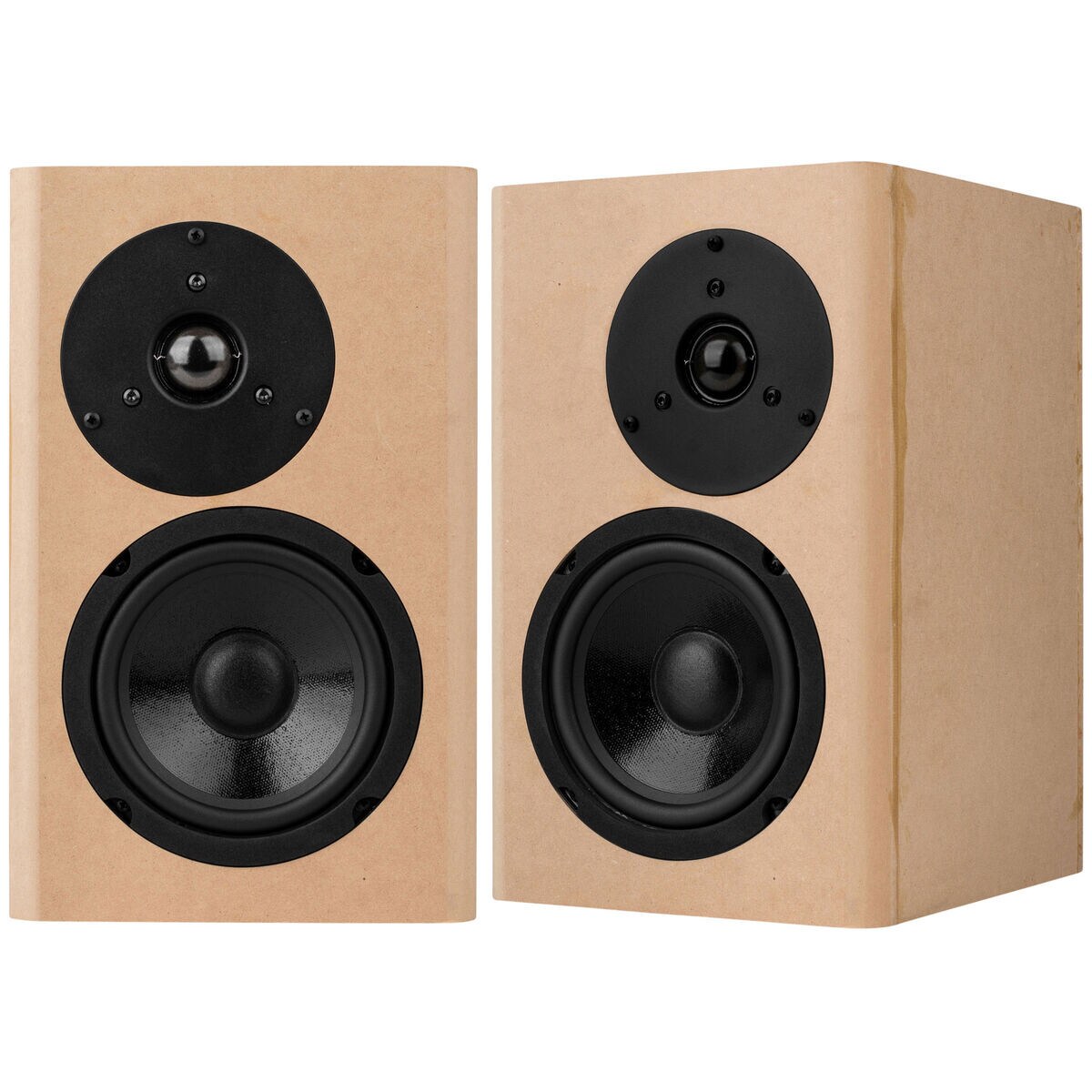

                            Maybe you really want something more familiar? The Tritrix MT is cheap and good. I built a pair long ago. Vinyl won't be taxing the speakers, I don't know about Apple music's fidelity.
                            TriTrix MT Bookshelf Speaker Kit Pair with Knock-Down CabinetsThe TriTrix MT vented speaker kit is a compact design that delivers high performance full-range audio without breaking the bank. With an F3 in the 50's and an F10 around 40 Hz, you can expect solid low end from the compact enclosures. The TriTrix is known for its smooth frequency response and its ability to make even poor recordings sound great. Thanks to the paper cone woofers and soft dome tweeter, this speaker delivers natural response with an easy to listen to sound. When Curt Campbell was designing the TriTrix he searched for drivers that would offer the best bang for the buck. For the woofer Curt selected the Dayton Audio DC130BS-4 5-1/4" Classic Series. With impressive bass performance, smooth overall response, and an incredibly low price, this is one of our most popular woofers. The Dayton Audio DC28FS-8 was chosen for the high frequencies. This was an easy choice, the DC28FS-8 offers superior European design and performance at a fraction of the cost of similar audiophile high frequency transducers. The solid MDF enclosure panels are all CNC milled by Denovo Audio to tight tolerances ensuring easy assembly and feature a 3/4" thick front baffle. The knock-down enclosures include a center brace tying all sides together to minimize cabinet resonances. Recesses for flush mounting the drivers and the opening for the port are pre-cut making assembly a snap. This kit includes nearly everything you need to build a pair of top-notch speakers in no time flat, including: a knock-down enclosure, drivers, damping material, and crossover components. This kit includes parts to build a pair of speakers.Included Components:QtyPart NumberDescription2295-302Dayton Audio DC130BS-4 5-1/4" Classic Shielded Woofer 4 Ohm 2275-075Dayton Audio DC28FS-8 1-1/8" Silk Dome Shielded Tweeter 2016-2.22.2 Ohm 10W Resistor Wire Wound 5% Tolerance2027-426 Dayton Audio DMPC-8.2 8.2uF 250V Polypropylene Capacitor2027-436Dayton Audio DMPC-20 20uF 250V Polypropylene Capacitor2255-028Jantzen 1832 0.30mH 20 AWG Air Core Inductor 2255-200Jantzen 1947 0.05mH 18 AWG Air Core Inductor 2255-256Jantzen 1048 1.3mH 18 AWG Air Core Inductor 2260-388Port Tube 1-3/8" ID Adjustable 2260-520Sonic Barrier 1/2" Acoustic Foam w/PSA 18" x 24" Note: Screws, binding posts, and speaker wire are not included. Specifications: • Power handling: 40 watts RMS/80 watts max • Frequency response: 45-20,000 Hz • Impedance: 6 ohms • Sensitivity: 85 dB 1W/1m • Dimensions: 12" H x 7.5" W x 8.25" D Note: Crossover components may be substituted with parts of equal or higher quality depending on available inventory.
