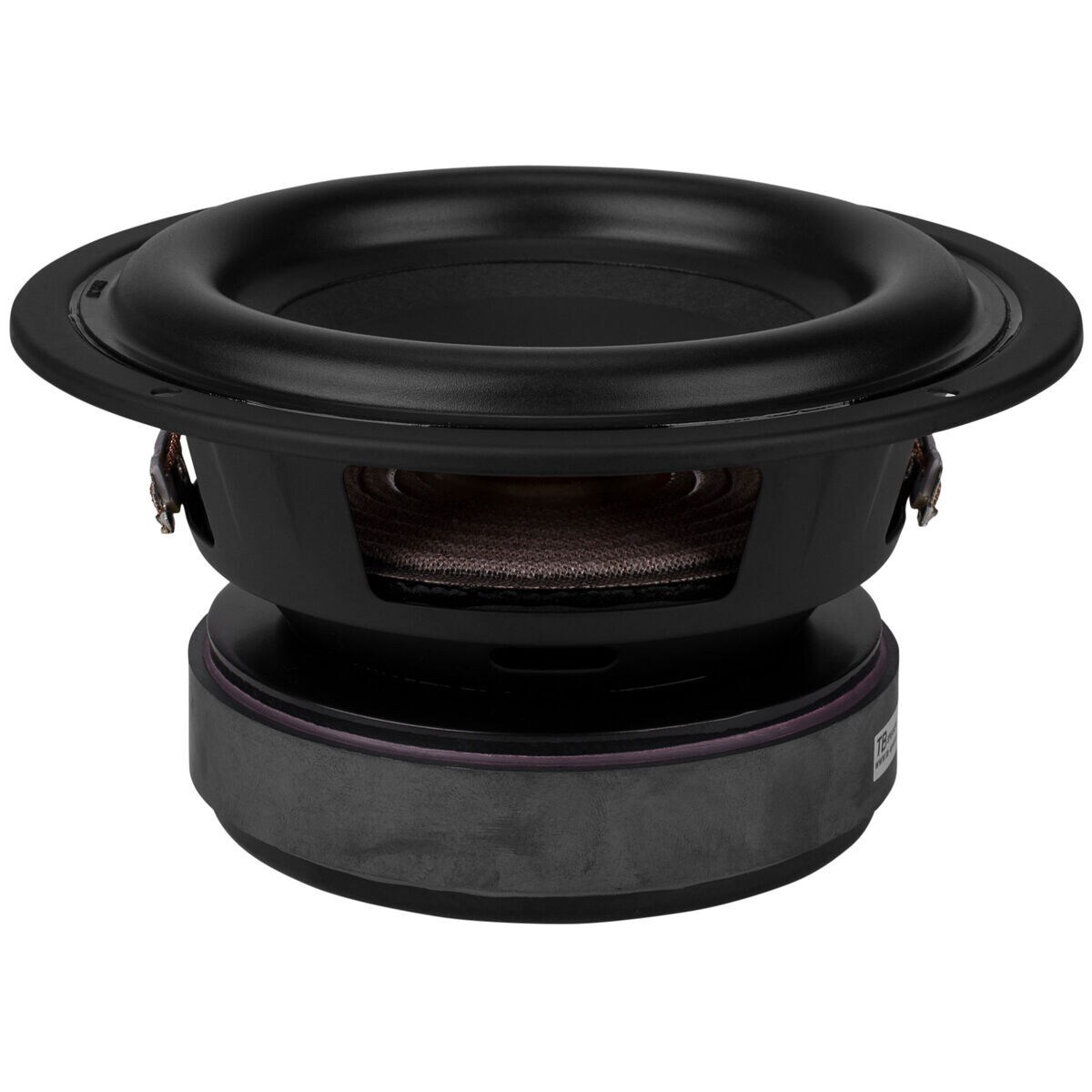

      Using two of the same woofers, in a sealed cabinet roughly twice the volume (the AB3a), will have the same low end as the LS3/5a's. The AB3a is under .5 cubic feet internally, which can work with some drivers. A pair of these in parallel, vented might suffice: https://www.parts-express.com/Dayton...305?quantity=1 Or just one of these in each:
      Tang Band W6-1139SIF 6-1/2" Paper Cone Subwoofer SpeakerThe Tang Band W6-1139SIF 6-1/2" subwoofer's wide half-roll surround, raised flat spider, and large 1-1/2" 4-layer voice coil ensure exceptional output and high power handling. Boasting 11.5 mm of Xmax, the W6-1139SIF is capable of producing prodigious amounts of deep, low-distortion, punchy bass. A vented pole piece and vented spider promote voice coil cooling by improving heat dissipation and reducing efficiency-robbing power compression. This 4 ohm driver also features a rugged stamped steel basket and bumped back plate.
      Tang Band W5-1138SMF 5-1/4" Paper Cone Subwoofer SpeakerAmazing bass in a compact package! The one-of-a-kind Tang Band W5-1138SMF 5-1/4" subwoofer has a generous 9.25 mm of Xmax. A wide roll surround, raised flat spider, and large 1-1/4" 4-layer voice coil ensure impressive bass performance and high power handling. The vented pole and vented spider allow good airflow around the coil to improve heat dissipation and reduce power compression. The ultimate miniature subwoofer driver!
      Dayton Audio DCS165-4 6-1/2" Classic Subwoofer 4 OhmDayton Audio's rugged DCS165-4 6-1/2" subwoofer has all of the performance-enhancing attributes you would expect from a larger high-output subwoofer. With a vented pole piece and 4 ohm, 4-layer voice coil, this driver can handle up 100 watt RMS. The non-pressed paper cone is reinforced with Kevlar to increase stiffness, which promotes linear travel through the limits of its excursion. In addition, the pole piece includes a copper cap that keeps inductance to a minimum. The DCS165-4 driver is ideal for use in small multimedia speakers, portable speakers, or even automotive systems where space is at a minimum.The Dayton Audio DCS165-4 is used in the following kits:Dayton Audio 6-1/2" Down Firing Active Mini Subwoofer Kit with 2.1 Channel AmplifierThis compact active subwoofer kit is perfect for powering a compact 2.1 channel speaker system. The Dayton Audio DCS165-4 6-1/2" subwoofer is driven with 60 watts RMS for powerful output and incredible low frequency extension. The Lepai LP210PA amplifier also has 2 x 30 watt RMS outputs to power your left and right speakers. This kit is the perfect start to building your own amazingly convenient self-contained 2.1 channel system.View KitDayton Audio 6-1/2" Down Firing Passive Mini Subwoofer KitWith an elegant compact enclosure, this 6-1/2" down-firing subwoofer kit is a great addition to any small stereo or home theater. Using a Dayton Audio DCS165-4 woofer in a vented down-firing configuration, this kit will fit low-key into any décor or under a desk to add high quality bass response and extension to your system.View kit SpecificationsQ&AReviewsManuals & Resources
      If you increase the cabinet depth that opens up options for larger woofers that may work sealed.
