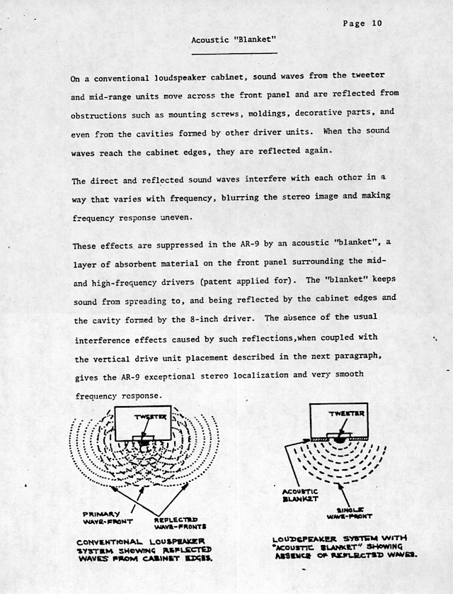

                        I saw this and thought you might find it interesting:
                        (follow link to see the rest of the whitepaper)

                          Thanks for the link, I've never seen that one. I wonder if they ever received their patent? I know that Dunlavy got one, it was unenforceable due to prior art, but I didn't think that it was an AR patent.
