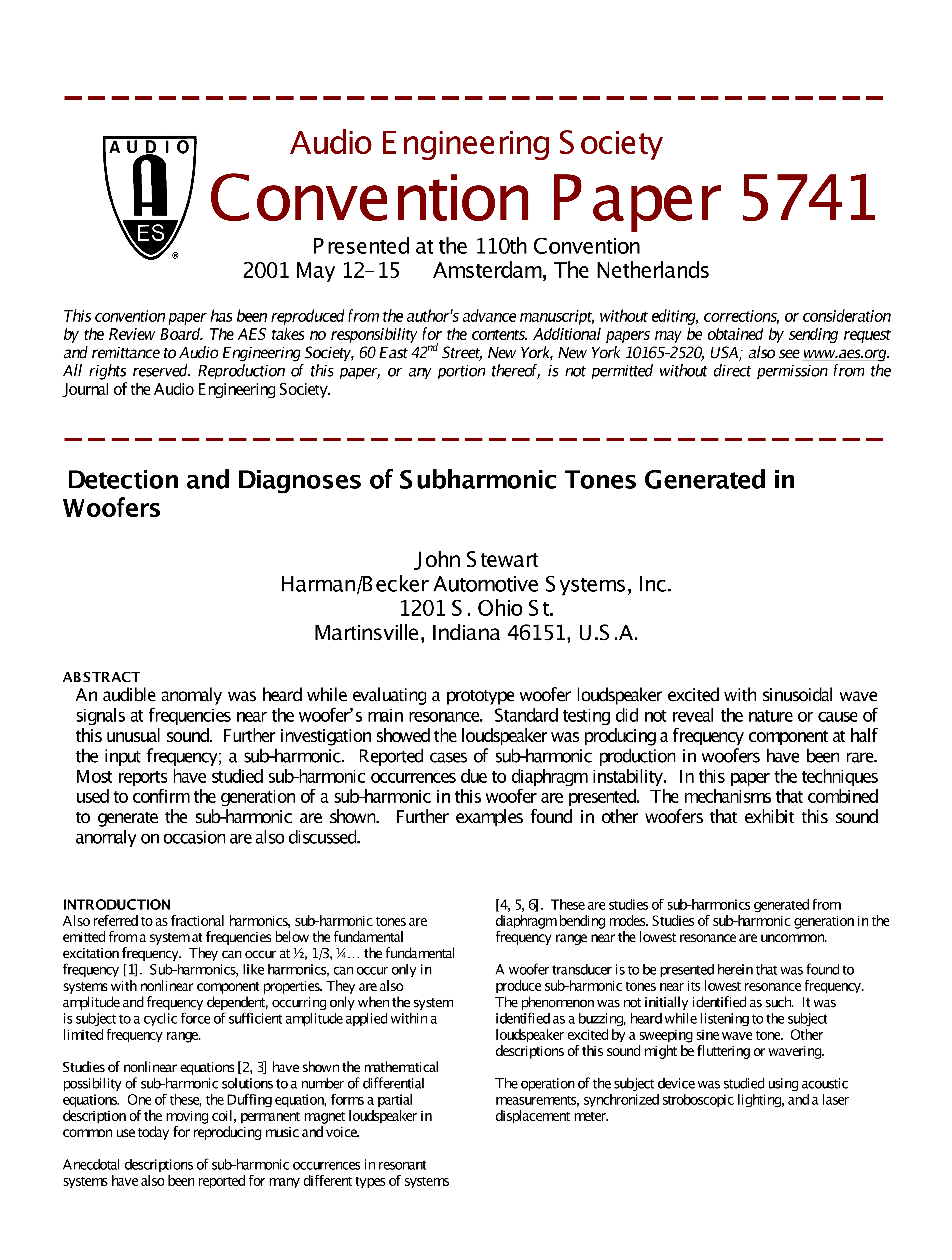

            Mark would be the go-to guy to answer these, but other than the jammie chaffing raised by Pete, the usual cause of frequency dependant buzz in a good driver is driver mounting.
            If it's truly a sub-harmonic, that's pretty rare. I read through Klippel's site again, and sub harmonics are never mentioned for one tone tests, just multi-tone (maybe there's hum in Mark's set up?). It would be odd to see it across a number of drivers with one tone present.
            This paper predicts sub-harmonics as appearing just before the driver goes chaotic:
            This one could shed light, but I don't have it:
            An audible anomaly was heard while evaluating a woofer loudspeaker excited with sinusoidal wave signals. Standard testing did not reveal the nature or cause of this unusual sound. Further investigation showed the loudspeaker was producing a frequency component at half the input frequency; a sub-harmonic. Reported cases of sub-harmonic production are rare for woofers; most reports concern compression drivers. In this paper the techniques used to confirm the generation of a sub-harmonic in this...
            There's also a mechanism which creates sub-harmonics in compression drivers (my guess is excessive throat velocity creating distortion in the air itself), but that wouldn't apply here.

              sub harmonics are produced by IM as well. 10KHz and 11KHz will produce a 1KHz sub harmonic.

                      Dave,
                      The stimulus is a 3 tone test. It's the same one SL uses. I've been using it so long it's just a convenient, well known and interpretable test for me. I know there are pros and cons to this three tone test, but I've developed a fondness to it that I don't have for simple HD testing.
                      So it's all HD+IM.
