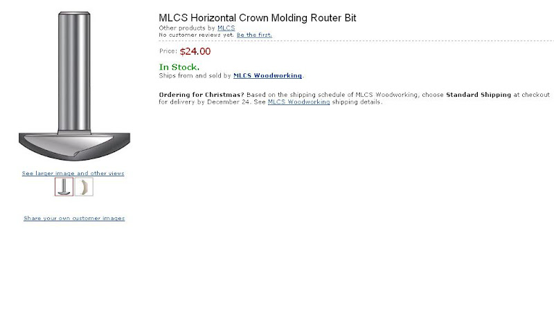

    Once I get some dust collection figured out for my router table I'm going to pick up one of those bits. Not just for hiding seams bit it looks like it will help a lot for alignment during glue-ups as well.

      Re: Best methods for finishing MDF
      I'm dying to try one of those, tho I wonder if it works well with MDF and how you have to adjust your measurements accordingly. Seems like it would be really nice, make squaring up the corners a bit easier.
          I have mostly used it on solid stock and BB ply but there should be no difference on setup for MDF. just a lot more dust...
          A long as you have a good router table/fence and are working with consistent panel thickness these bits are very easy to set up and use.
          First put matching witness marks on the outsides of the panels to be joined (just to keep insides/outsides identified) then set the depth of cut using a matching thickness piece of scrap to the same final material you are using.
          Actually have a look at this set up PDF - pictures save a lot of words.....
