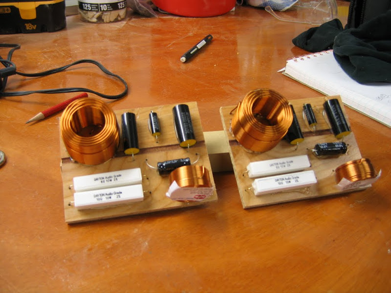

    Crossover mock up with drawing..
    Completed crossovers... without leads

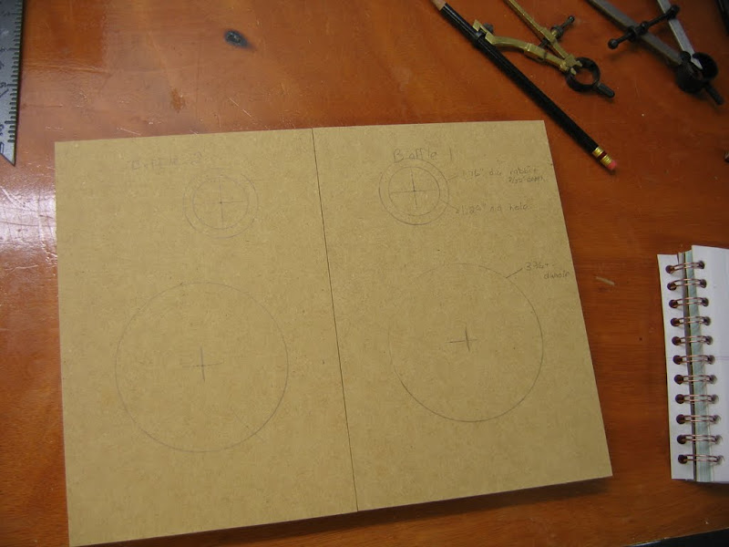

    Baffle's
    I have decided to surface mount both woofer and tweeter. This is mainly due to the fact that I did NOT want to purchase a 45mm forstner bit exclusivley for this project (like Bill did... ), that and the modeling for the enclosure done by Paul C was for surface mounted drivers.

    The XO looks very nice and clean. Much nicer than mine.

                I like your crossover layout. In hindsight, I should have put mine onto just one compact board like yours. It would have saved some time.
