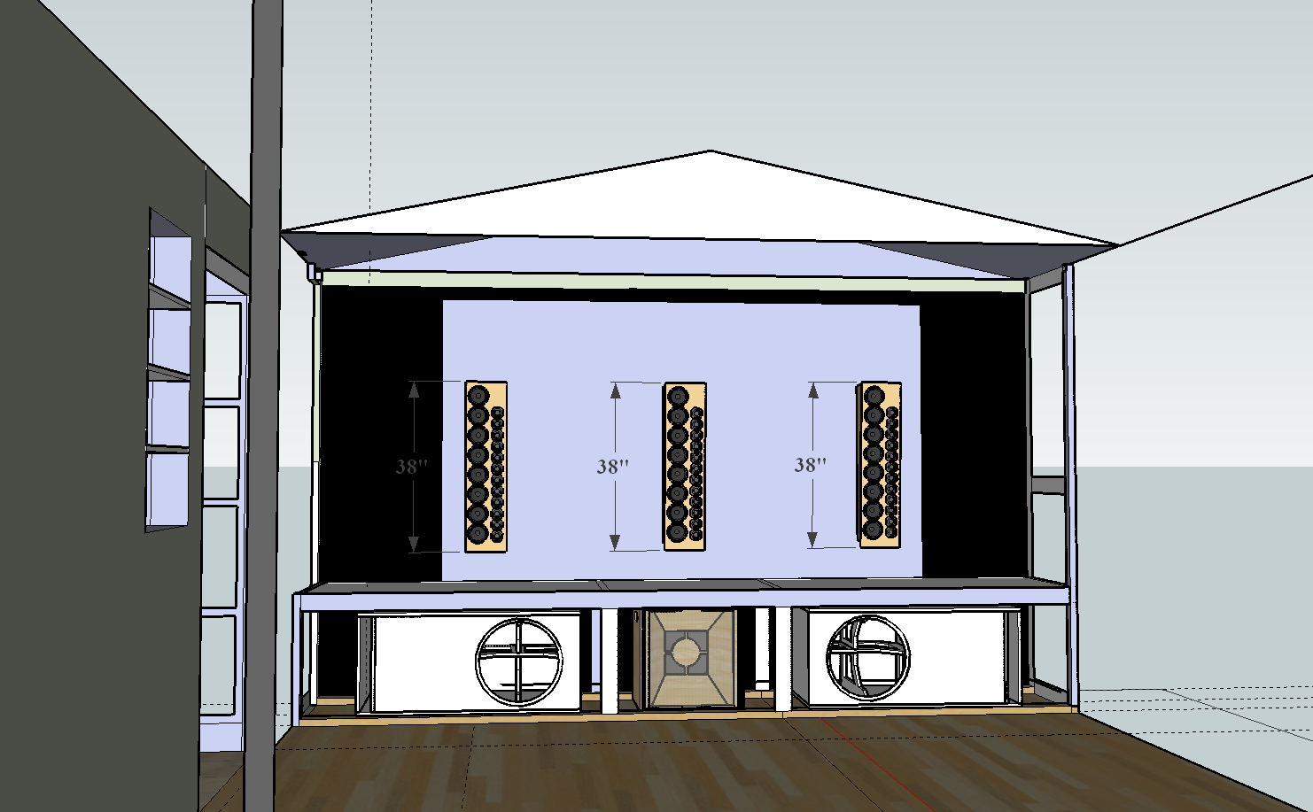

            I'd still like a 'bit' of bass response from these guys--but I suppose my biggest concern is the mid-bass aspect. I'll likely keep them the same size and either poly-stuff or port for the 50hz value.
            At least that saves me some time - dont have to rework the boxes or buy dsps heh.
            I have 2 subs up front
            and two hsu vtf-15h's in the rear. I've purchased an at screen and I'm going to build the wall forward a bit to allow for speaker placement behind the screen.
            this is the basic idea -
            i was going to go line array, but opted for pro-type instead. Once i have the final dimensions on the current guys im building, i'll be able to finish the plans for moving the wall forward.
            thanks for all the help guys--really appreciate it. I should probably start a build thread so I this thread isn't convoluted anymore than it already is...
