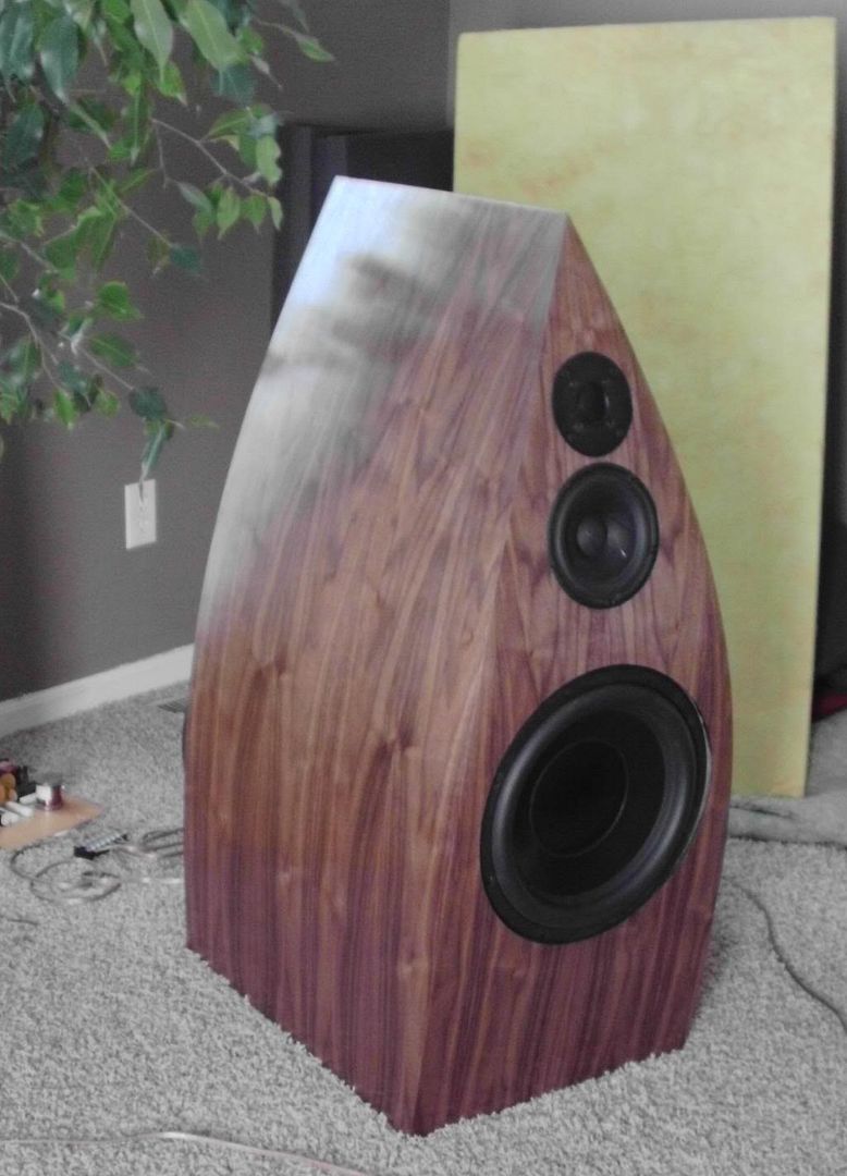

Originally posted by anunnaki View PostDid I miss something? Did you use a PR with these?
Leave a comment:

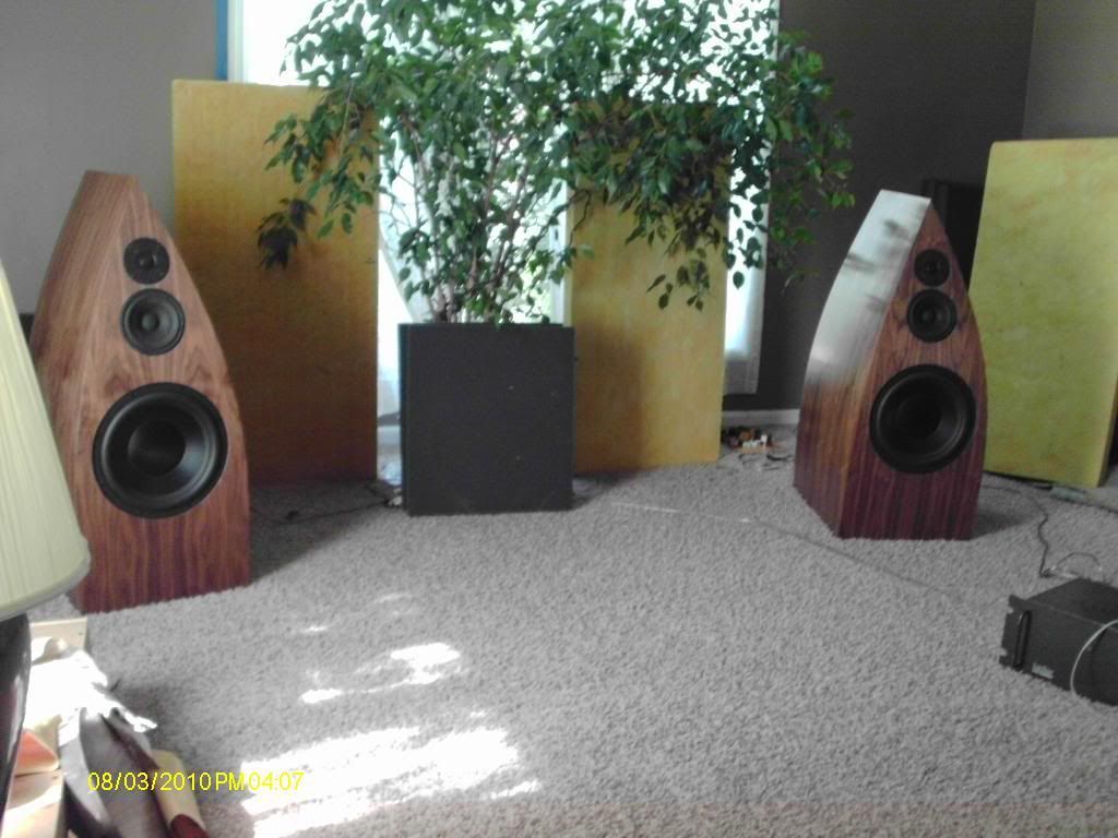

Re: RSS315HF-4 as the anchor of a 3-way???
Originally posted by Pete Schumacher ® View PostThey are indeed linebackers, weighing in at just over 130 pounds each, and attractive as well.
Hey, even I have to admit that Howie Long is a fine looking man!!! :o
I built these to be true reference quality speakers, with a full range (to my ears) from the lowest bass to 15KHz (my upper limit). The RSS315 most assuredly meets the criteria. The low end is deep, full, and very detailed. The PR extends the in-room response to below 20Hz, and really helps keep the woofer under control on the bottom octave.
If anyone is contemplating using the RSS series subs for woofers, GO FOR IT!!! You will NOT be disappointed in their performance. I thought maybe they might not be up to the challenge of blending with a Revelator, but the Daytons did not disappoint.
Originally posted by jonasz View PostWow, very CHUNKY! :D
I bet those got some nice bottom end to them...
Well, even though the camera is a cheap piece of junk, the light was pretty good and I got a decent shot of the finished walnut.
