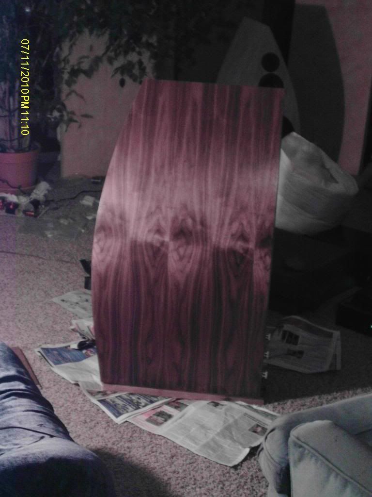

    Well, I suppose a crappy picture from my cheap camera is better than nothing. Here's a shot of the finished cabinet side. It's gorgeous!!!

  • Pete Schumacher
    replied
    Re: RSS315HF-4 as the anchor of a 3-way???
    Originally posted by jonasz View Post
    Pete, your project looks a lot like this one I just stumbled across.
    Any more changes after another week of listening?
    Wow. Isn't that something? Similar mid, Dayton Reference Sub, 15" PR. I like the looks of mine better though.
    Nope, no changes. I like them where they are more than any other previous setup. It's really nice having a simple way now to adjust the mid level to suit the room. But I think I've found the stopping point.
    I've gotten a few coats of tung oil/varnish on one cabinet now, and rubbed with steel wool. One or two more passes and I'll consider it done and move to the next enclosure. I'm not looking for a glossy finish by any stretch, just smooth and natural. Also got the mid chamber on this enclosure treated with a couple layers of roofing felt held in place by some spray adhesive. Two braces using 3" wide, 3/4" thick solid oak planking will be added to each cabinet to reduce what minor panel resonances there are.
