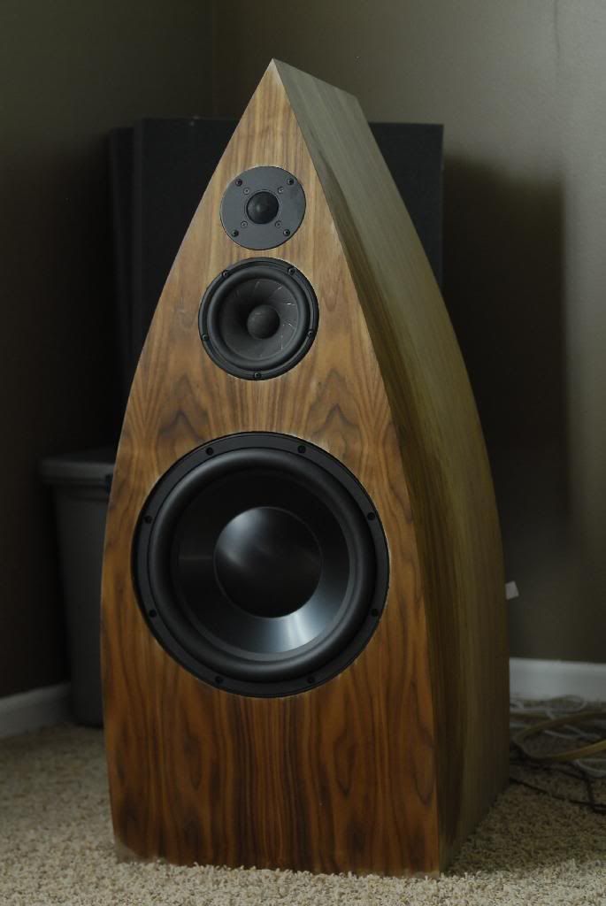

Beautiful grain pattern Pete , that's a great looking set of speakers you got there.

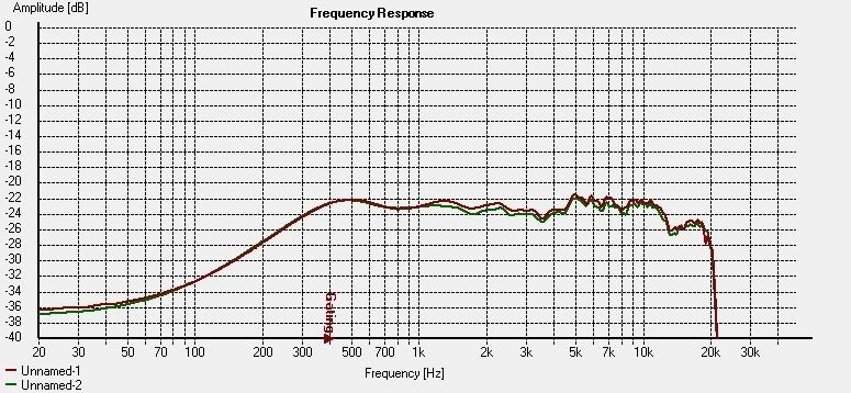

[QUOTE=Pete Schumacher ®;1652318]Well, Ryan (DoubleTap) was by the last couple days, first for some listening, and today for some measuring. Yesterday, he noticed a couple of subtle things needing some attention that today's measurements verified.
First, excessive operator head-space was revealed on the left speaker. I had connected the woofer output to the wrong node on the XO, so only partial filtering of the woofer was taking place, causing some excess midrange on that channel. Easy fix.
Second, the mid/high balance seemed a bit hot, so we backed down the tweeter about 1dB. At that point, we took some measurements. The two traces are of the left and right, though we didn't calibrate the mic distance. Still, pretty close.
The slight dip between 2500 and 4500 is definitely diffraction related, as it filled in when moved off axis.
At this point, we attempted some woofer measurements, but that proved nearly impossible in the room. But what we could glean from the plots is that the woofer is still not quite as sensitive as it could be.
So we played with a bit of EQ in Foobar, boosting the woofer level about 3dB across it's band to 300Hz and doing a bit more listening. We came to the conclusion that the extra sensitivity of the 4 Ohm version would not be too much for where the mid is now. Padding down the mid and tweet another 2dB would be about perfect, but at this point, I am thinking that going with the RSS315HF-4 is the better alternative.
It was a very productive couple of days thanks to Ryan, and these are one step closer to being DONE.
Ryan also has a very nice camera. So here's a shot of one of the speakers with a damp cloth wiped across the veneer to give you all an idea of how these will look when done.
Beautiful job Pete, and I'm sure the sound will equal the looks once the fine tuning is done. I have a pair of the RSS315HF-4 to use in a somewhat similar manner, so I'm following your progress with interest. This will be a reference thread for me,
