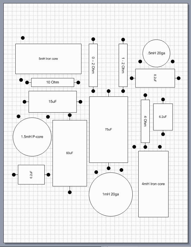

            Here's the XO layout. Includes space for added notch filter components for the RSS315. The white area is 8.5" x 11". Print out the page, lay it on a nice piece of thin oak veneered plywood, and drill out the holes for the leads. All the wiring will be on the back side for a nice clean look. Eventually everything will get glued down once I'm totally set on the final values.

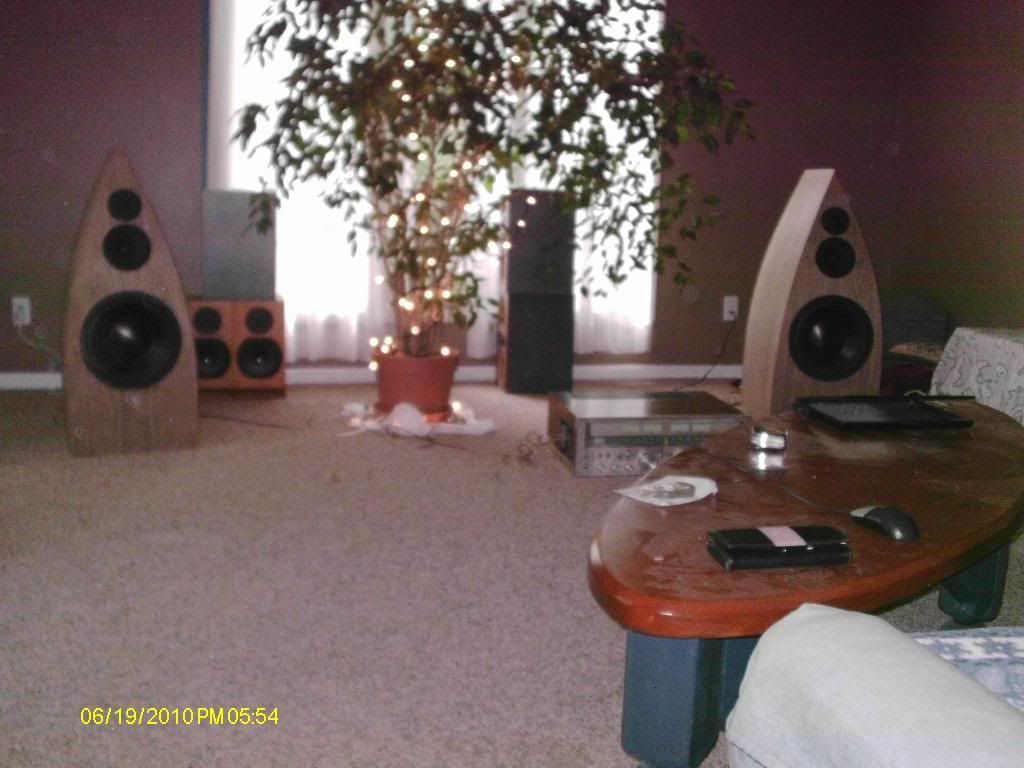

                  Two of them playing finally! And guess who showed up to sit between the speakers when I fired up the pair? That's right, my voicing partner, Zoe the cat.
                  I love this hobby.
                  Now, the problem of getting them to their final positions in the room . . . anyone with an anti gravity machine? 120lbs with no handles is a pain. :eek:

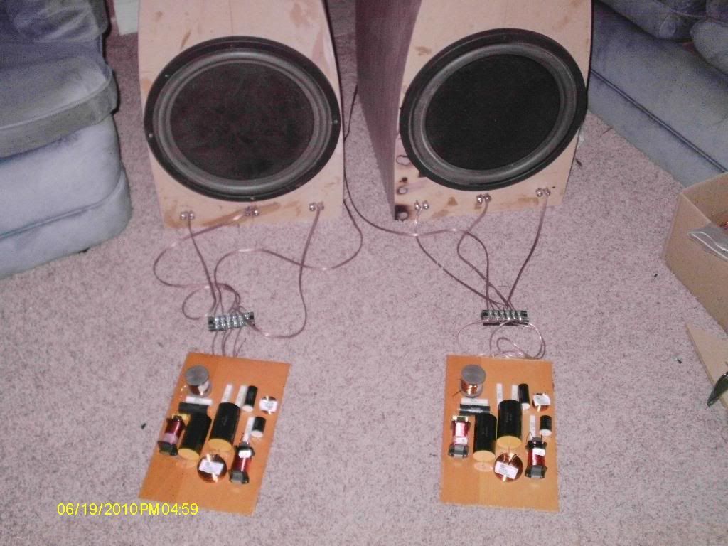

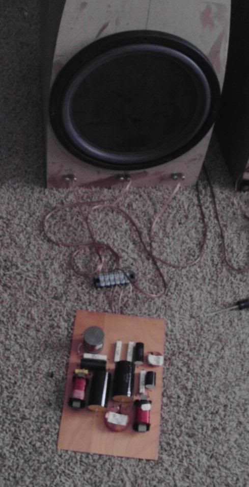

                  • Re: RSS315HF-4 as the anchor of a 3-way???
                    Second XO assembled and playing.
                    These have been sitting in the living room, which has been in disarray during a simple remodel of the room, and playing through the foyer and into the family room. Just moved all the furniture to where it belongs. The speakers are to their final spots.
                    The room is far from finished. Crown molding, drapery, artwork, and I want to add a few acoustic panels.
                    Both systems are playing now, with matching XOs that include a steep notch for the RSS315 at 1800Hz, and the bass performance is simply yummy. Superb definition, and it slams nicely when called upon.
                    Can the RSS315 anchor a passive 3-way?
                    YES!!! :D

                          Wiring is no problem. All Dayton polys, 20ga air cores, 18ga iron cores, P-cores. Wirewound resistors.
                          I don't know if I could hear a difference Wolf, let alone determine which would be better. I just can't seem to justify anything costing more than the Dayton polys. I know you're among those who like the uber caps, DoubleTap being another. Maybe when I upgrade the tweeter to the Scanspeak 6600 one day, I'll spring for the uber caps and re-do the XO.
                          I doubt they'll be ready for Dayton. After a bit more listening and final measurement, it's off to finish work, sanding, oil and stain, then wax. I'm probably going to veneer the backs, so there's that too. Perhaps a bit of interior treatment, extra brace or two. It's unlikely they'd be finished before the event, unless things go quicker than I anticipate, which isn't usually the case. I've got to figure out a safe way to move them to events as well. They are ridiculously heavy and hard to maneuver.
                          I'll bring them to Iowa for sure. I just hope I can get them as nice looking as Dan's stuff. His finish is always incredible.

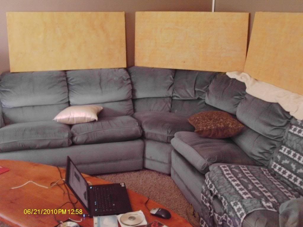

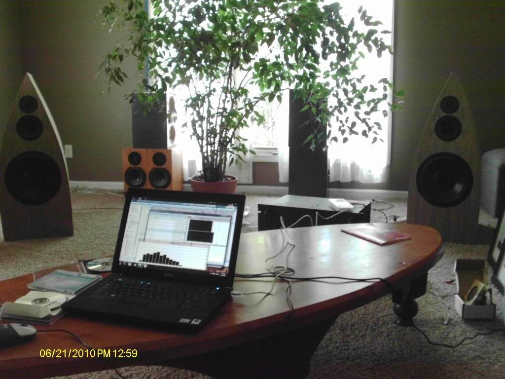

                              I got some room treatment put up in the unfinished (bare) living room. Makeshift for sure, but far better than nothing. I have another panel standing a few feet away from the left enclosure. The improvement was immediate.
                              Celtic Woman, A New Journey was playing this morning. Great recording with real dynamics and absolutely beautiful voices.
                              Track 7, Dulaman, has some drumming on it that just begs to be part of a "testing CD" with extended low end, great transients, and complimentary instrumentation. Track 8 has luscious harmonies and some deep lows.
                              The stuffing in each cabinet was revisited, with exactly 2 pounds of fiberfill in each enclosure. Before that, there might have been about a pound. It's hard to say what effect it may have had, but it's certain that it won't do anything but improve upper midbass performance.
                              Using Foobar and the spectrum display, I'm able to track where the vocal fundamentals are falling, and when they hover around the crossover point between woofer and mid, I'm not detecting any shift in timbre or loss in detail. That's a confirmation, to me anyway, that the RSS315 is definitely up to the task, complimenting the Scan mid quite nicely. The bottom end is just so solid, and even when it's shaking the room, there's no loss of clarity in the midbass.
                              I sure would appreciate a couple of visitors ears to confirm what I'm hearing before I call it done. I'm anxious to get started on the finish work, but I'd really like to make sure the voicing is done first.
                              Anyone in the St. Louis area care to stop by for a listen? :D
