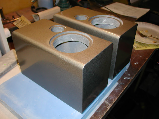

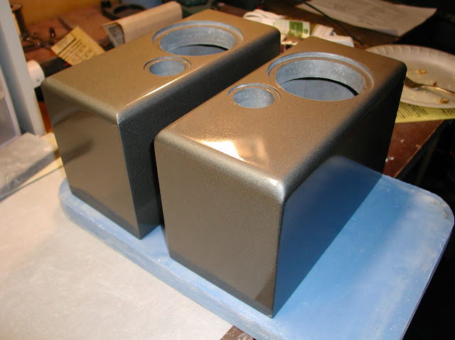

    After attempting a brushed stainless finish I decided I wasn't comfortable taking a brush to the finish. Need more practice. So I decided to go with as much metallic as I could get in the paint. I painted these with this. I sprayed them with light fog coats until they were completely covered. Then I sprayed four back to back coats of Krylon crystal clear. I let them dry about 20 minutes between coats. I then let it dry 24 hours and sanded with 400 grit dry paper. I then sprayed a real light mist of the stainless steel paint to get some more metallic on the surface. This gives the metallic a lot of depth. Then I put two more back to back coats of crystal clear on. It was kind of hard to take pics to show how much metallic came out in the paint. Looks pretty cool.
    I will be putting the RS100-8/ ND20FA in them.

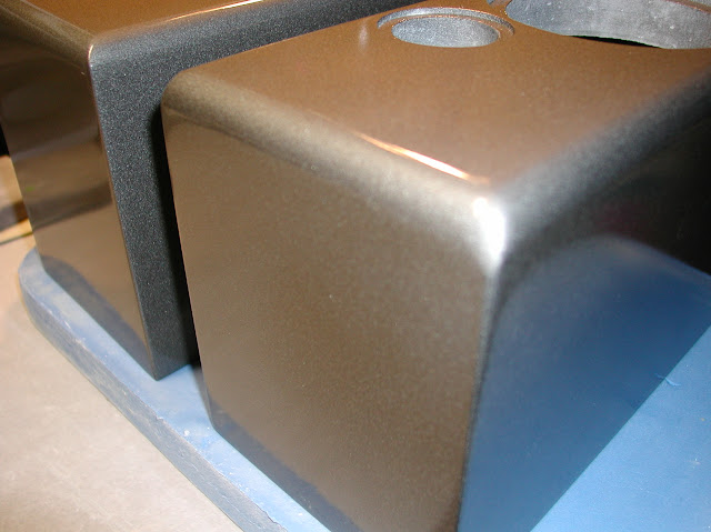

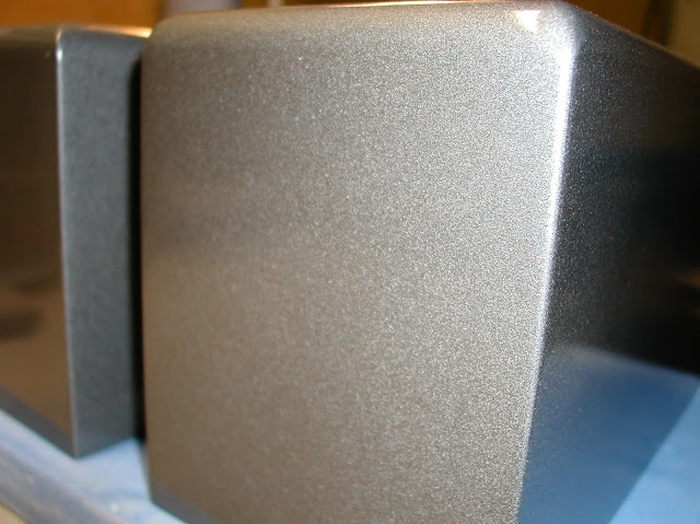

                        After the finish dried for a few days it seemed it soaked in some more and I really wasn't happy with it. I could have wet sanded and buffed, but I really didn't feel like doing it. So, I have been looking at the Parks Super Glaze at HD and have been wondering how it would work. It's basically a two part epoxy coating. I dry sanded the cabinets with 400 grit. Reading the instructions it says best dry conditions are at 70 degrees. My work area is around 60 degrees, so the finish was a little thick. I also accidentally didn't add enough hardener so it set up slow.
                        The shine came out beautiful. I should have warmed it up so it was thinner and could have applied it thinner. On flat surfaces the thick is fine because it flows, but on the sides it wanted to sag. Not putting in enough hardener made it set up slow which didn't help. All in all it came out ok. After they dry good I am going to sand them down and try a heated batch with more hardener to see if I can get it to flow smoother. I was flipping these around to keep the finish from running so the finish isn't flat on any one surface.
                        They do have a really nice deep clear smooth finish for applying with a sponge roller. If I can get the temp and thickness right this could make an awesome easy finish. It was $20 for the kit and I hardly used any on these small speakers
