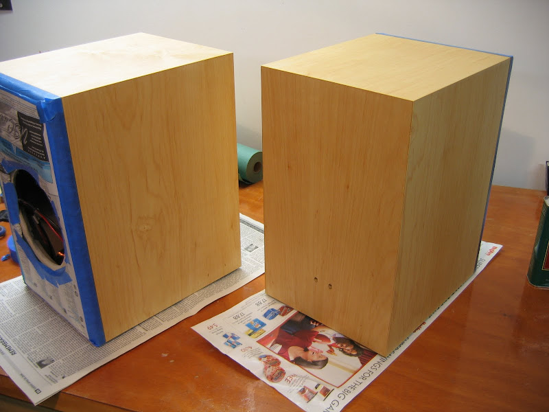

        I am currently using Formbys Tung Oil, which isn't pure. It's more of a wiping varnish. (read: many coats, but after 8-10 coats, you get the deep conditioned bare wood look, WITH the protection.
        Test I did for current build..
        After 2 coats of Formbys tung oil
        It is time consuming, with the one coat per day, and sanding with 0000 steel wool between.
        btw, thats Maple paper-backed veneer
