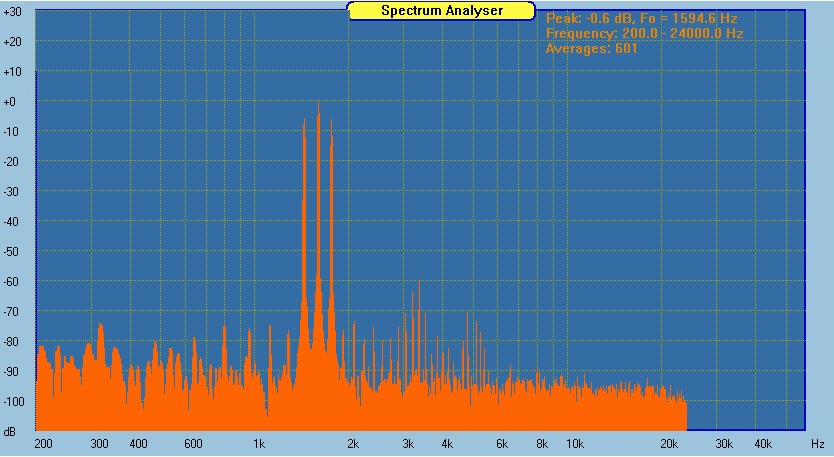

                            How big a cabinet can you handle? I forgot that you mentioned line array, and those are usually quite large.
                            Zilch's suggestion will give you the unlimited dynamics you'll need for those power tracks, but I was thinking going even larger.
                            Can you handle something that would house a 15" woofer, and require about 9 cubic feet? It doesn't need a huge footprint, as it could fit in the same space as a line array. An enclosure with internal dimensions of 15" x 15" x 70" will give you 9 cubic feet. If you were to mount the Acoustic Elegance TD15S in that box, and tune it to 20Hz with a 17" long, 6" diameter vent, you'd have a system that will hit 105dB at 20Hz with 100W input, and 113dB at 100Hz. Cross that woofer to a waveguide loaded pro tweeter at 1500Hz and you'd have one of the most dynamic full range two-ways on the planet.
                            If you wonder how a 15" woofer performs at midrange frequencies, check out the distortion plot below. Stunning.
