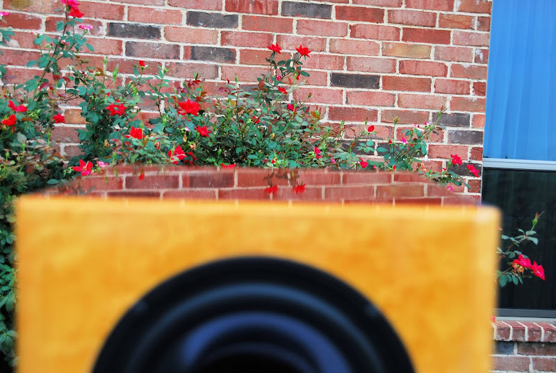

      Pi
      Here is a set where I used Brown Mahogany Trans-Tint on Walnut Veneer.
      I hadn't buffed them yet at the time this photo was taken.
