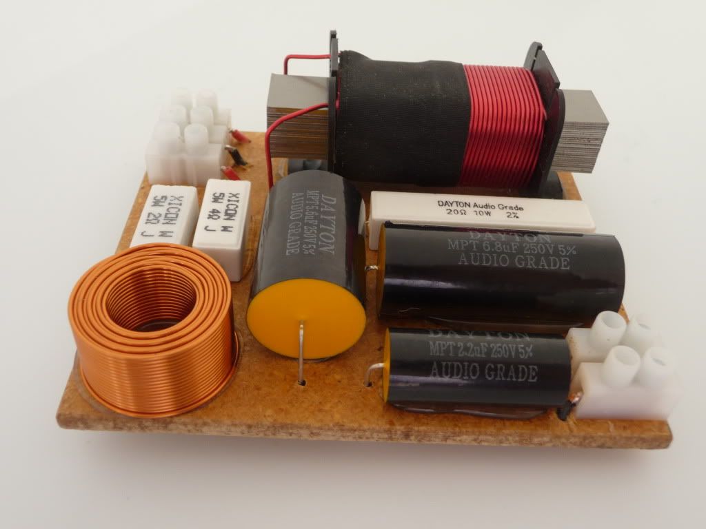

    Here's a photo or two of the finished crossovers:

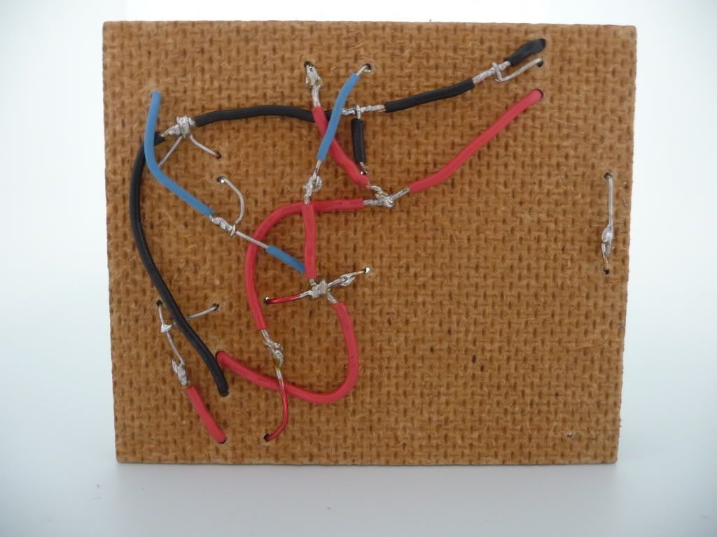

    And here's how they're wired on the underside:
    The boards are made from 1/4" hardboard (Masonite), all components are secured solely with hot-melt glue (and the underside wire connections), 18 gauge "hook-up" stranded wire was use where necessary (black and red, where the component leads weren't long enough to make connections), and heat-shrink tubing (blue) was used to insulate bare wires in close proximity to other bare wires.
