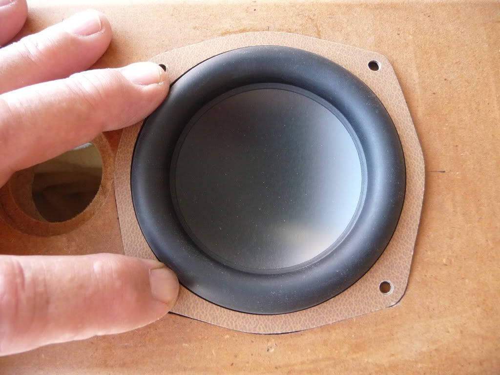

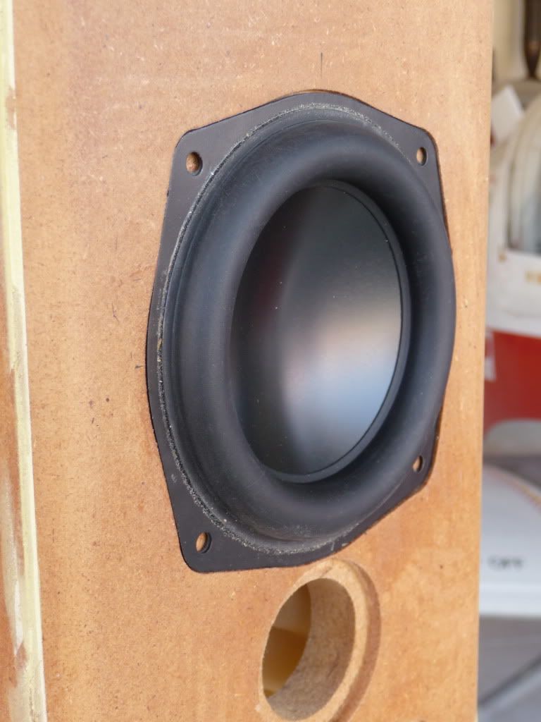

    Here's a closer view of a driver inserted into the relief I routed into the baffle. If the driver looks like it's been around the block, it has. I've handled it a lot in coming up with a pattern for the router. The fit isn't perfect, but it's very close -- driver press-fits into the relief tightly enough to hold it in for the photo.
    I think I mentioned before that I'm thinking of trimming the driver flange with plastic laminate. I cut the relief deep enough to accommodate the trim, the flange, and a gasket behind the driver. The gasket that comes with the driver is minimal, to say the least. But then, they didn't make these to be flush mounted.
    Here's a photo showing the trim piece I made which would cover the black flange, and the glue smudges left over from fitting the rubber surround at the factory.
    Try to visualize how the trim would look on a black baffle, if you can. There will be four allen head cap screws in the holes also. The final trim pieces should match the opening better too. I'm not certain I'll use these yet.

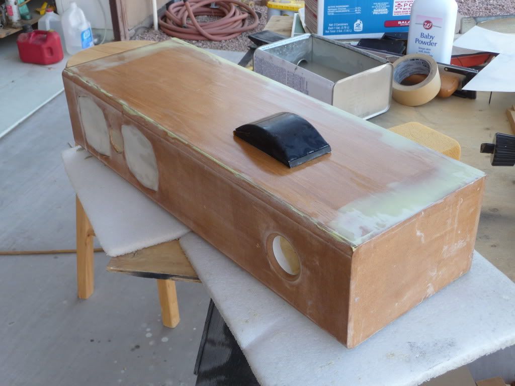

    In the next photo I'm wet sanding the enclosure after it has been sealed with fiberglass resin diluted with acetone, and body filler has been applied to defects. This has been the most difficult part of this build -- the resin has been very slow to cure and will clog sandpaper almost instantly. That's the reason for the wet sanding process -- that's the only way I've been able to sand them.

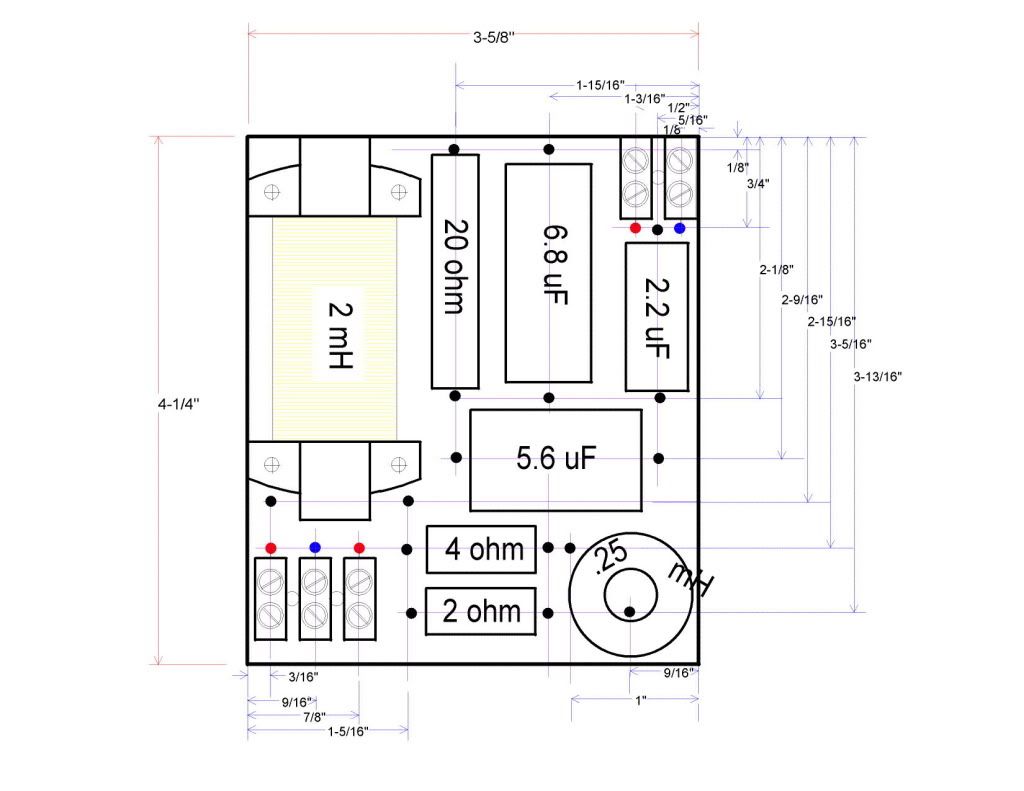

    I'm currently building the crossovers. Here's a drawing that shows the layout. The board is sized to allow insertion through the driver openings.

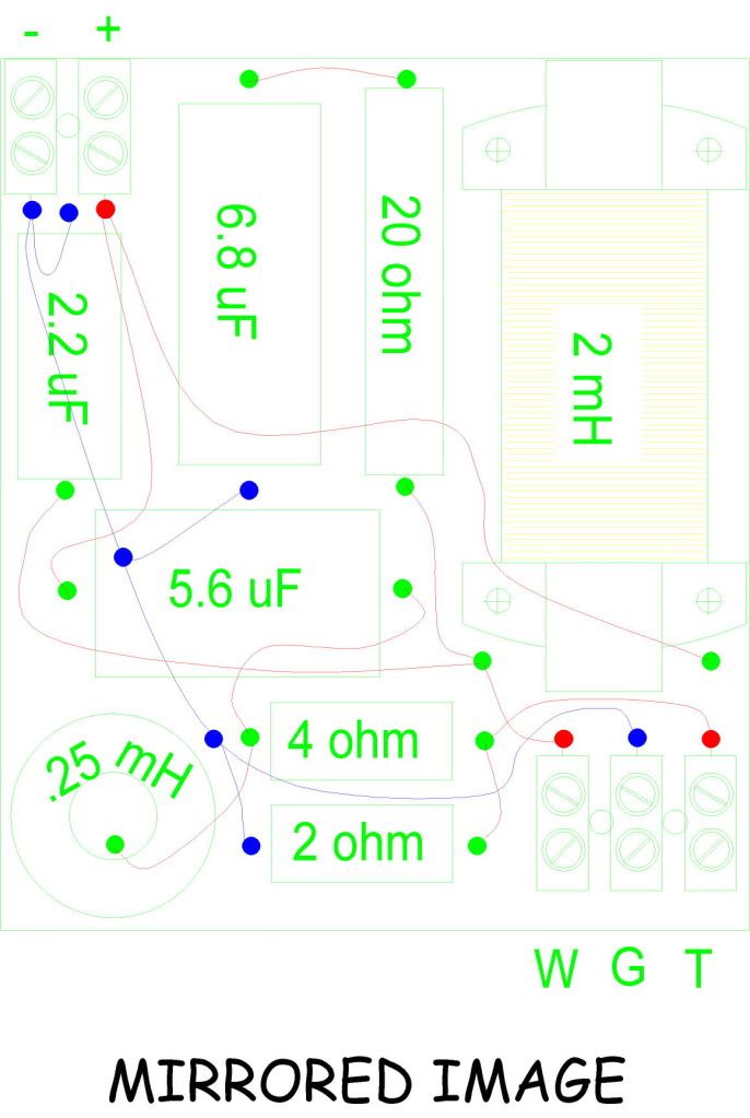

    This last drawing is a mirrored copy that shows how the components are wired together under the board, to complete the circuitry.
