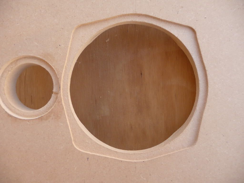

Continuing with where I left off, here's a close-up of the recesses for both drivers. As you can see, the closeness of the two drivers leaves very little material between the two recesses. That area will need reinforcement.

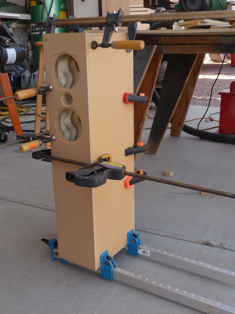

The assembly sequence I followed was to first create a five-sided assembly, install the cross brace, glue in dampening material, then add the the remaining side. I laid one side flat, and then added the baffle, back, top, and bottom. The second side was dry-fitted into the opening while the assembly dried, in order to improve squareness and to make sure it would fit into the opening without modification once it came time to install it. I go into a bit more detail in my Duellati build string where I describe how and why I dry-fitted, marked where glue was to be applied, and used a spreader. I'll add a link to that string below my signature for anyone who might be interested.
I glued in mattress topper for dampening, using spray on contact adhesive.

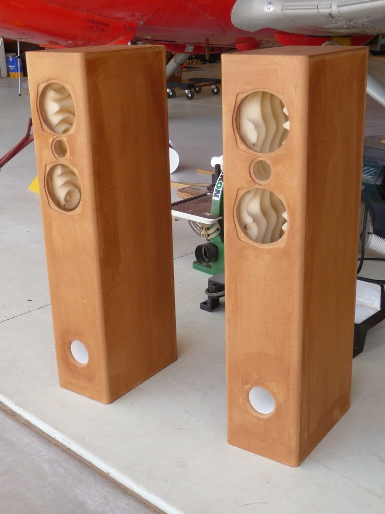

This next photo pretty much shows where I am today. I rounded over the front baffle and port, using the same process described in my Duellati build. I also flush trimed the panels with a flush-trim bit. I then brushed-on fiber glass resin diluted 50% with acetone to the entire enclosure , to strengthen and seal it. I very much like the end result, but a fairly long drying time is necessary. Try to sand before several days have passed, and the somewhat sticky resin will clog the sandpaper.
