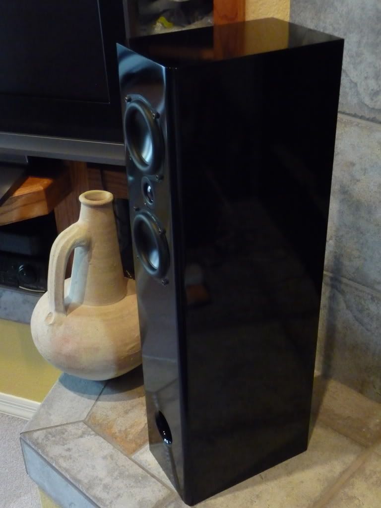

  • isaeagle4031
    replied
    Re: on Sale - $55/pr (drivers & XO)
    Very nice indeed! Mind sharing your enclosure details?
    Leave a comment:
  • bungelow_ed
    replied
    Very classy looking speaker! I especially like the piano black and speaker fasteners.

  • Soundslike
    replied
    Well, I finally got these done. I'll be back later to describe what I did to make these, just in case someone is interested. Here's a photo of a finished speaker.
    Leave a comment:
